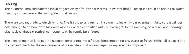

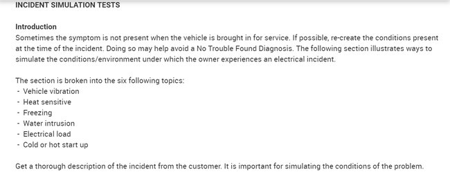

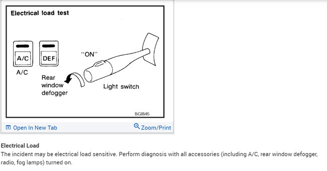

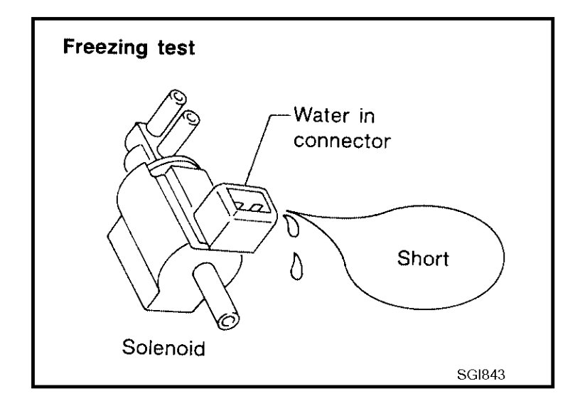

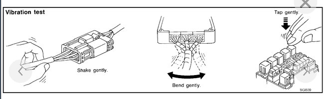

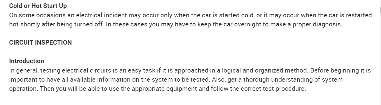

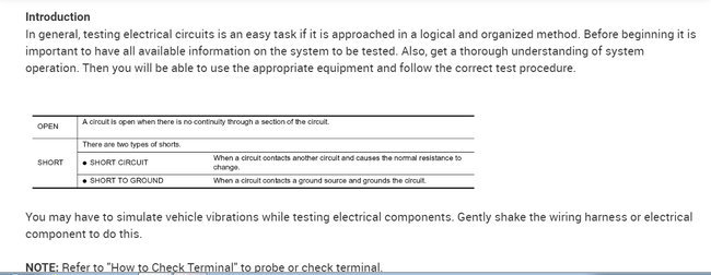

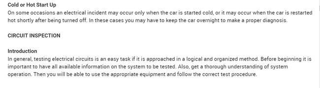

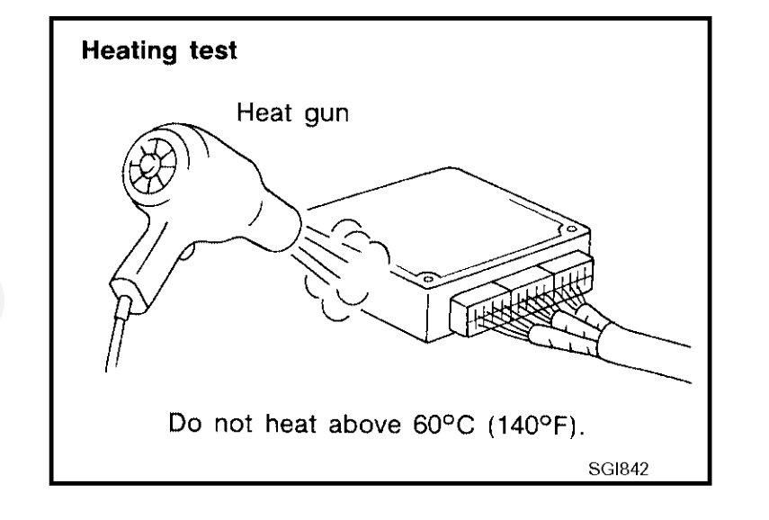

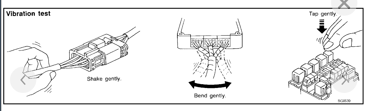

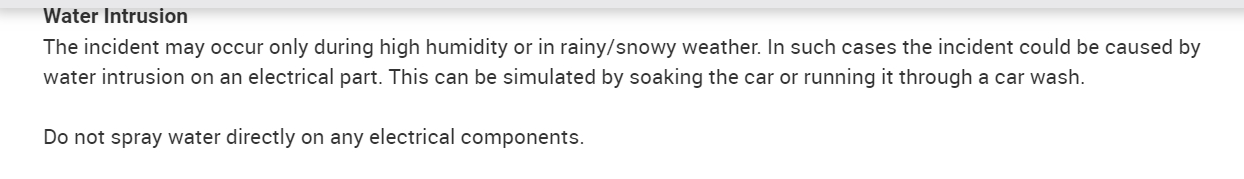

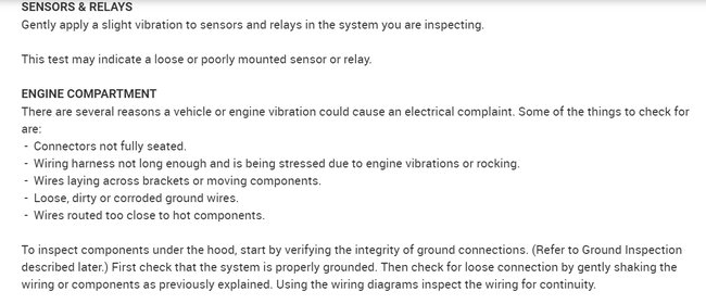

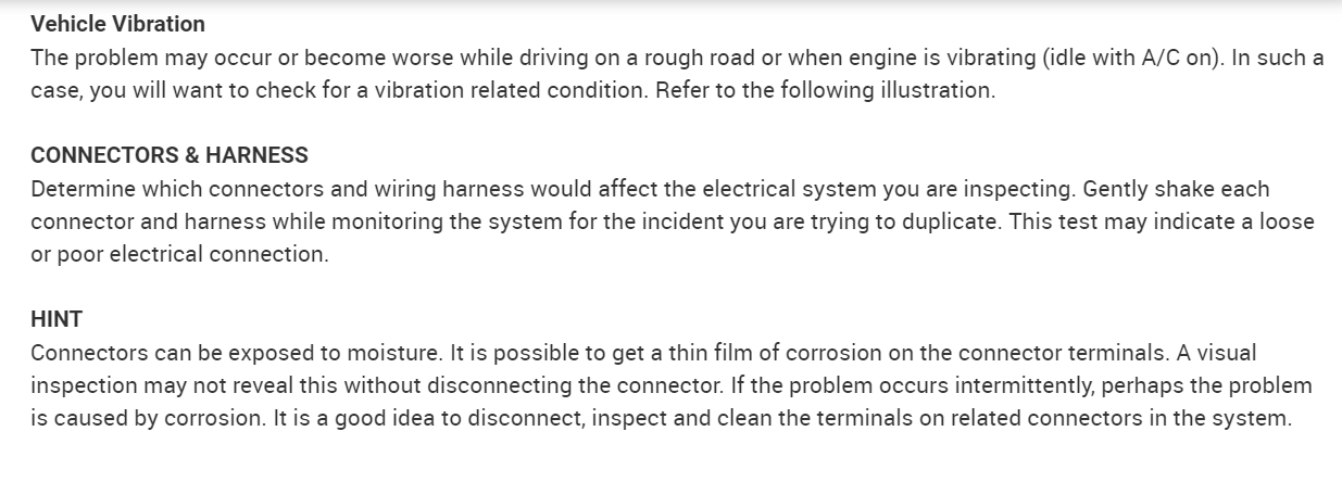

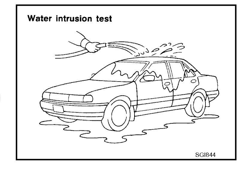

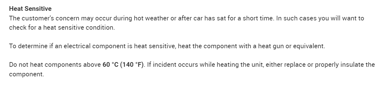

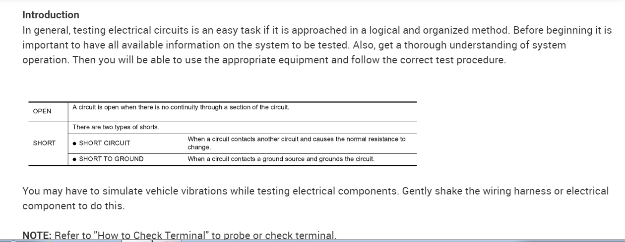

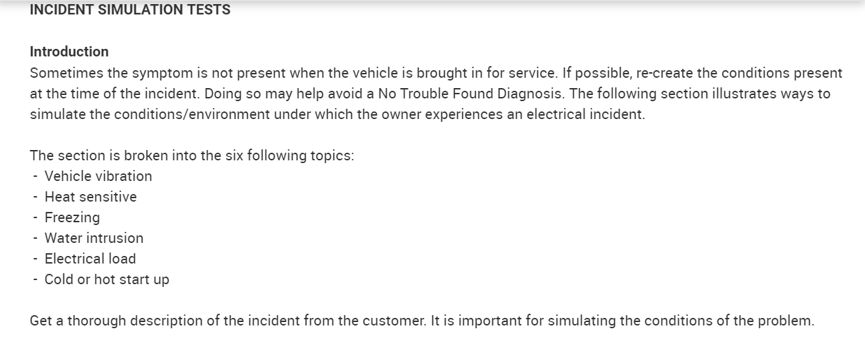

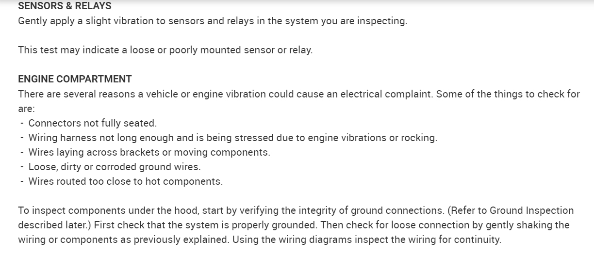

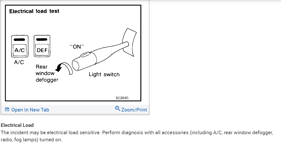

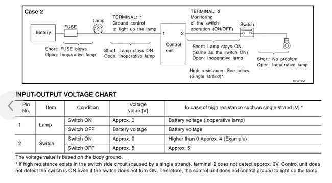

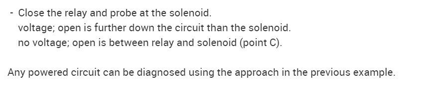

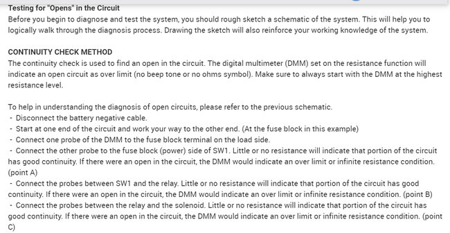

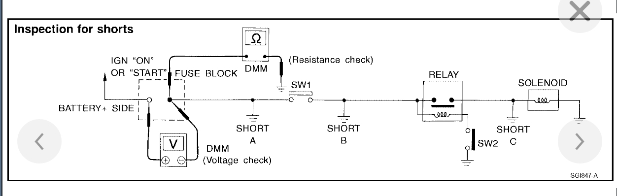

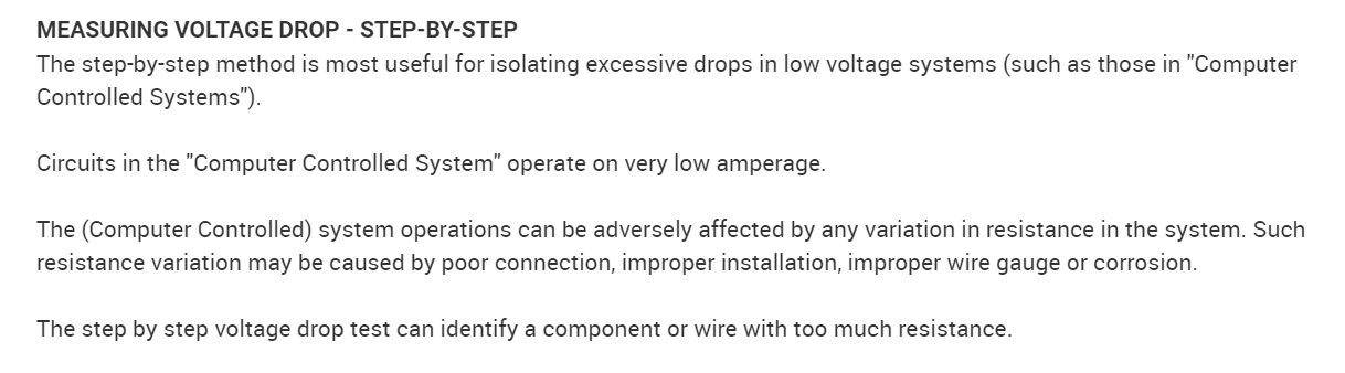

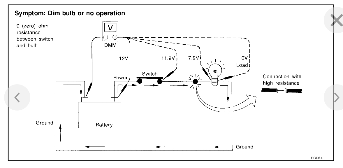

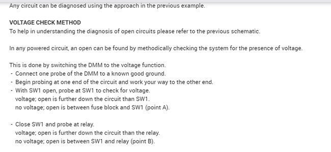

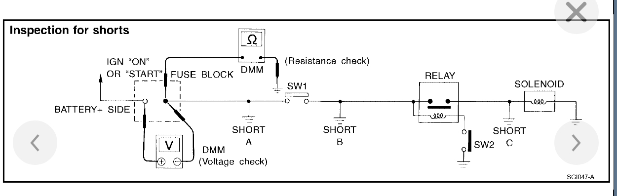

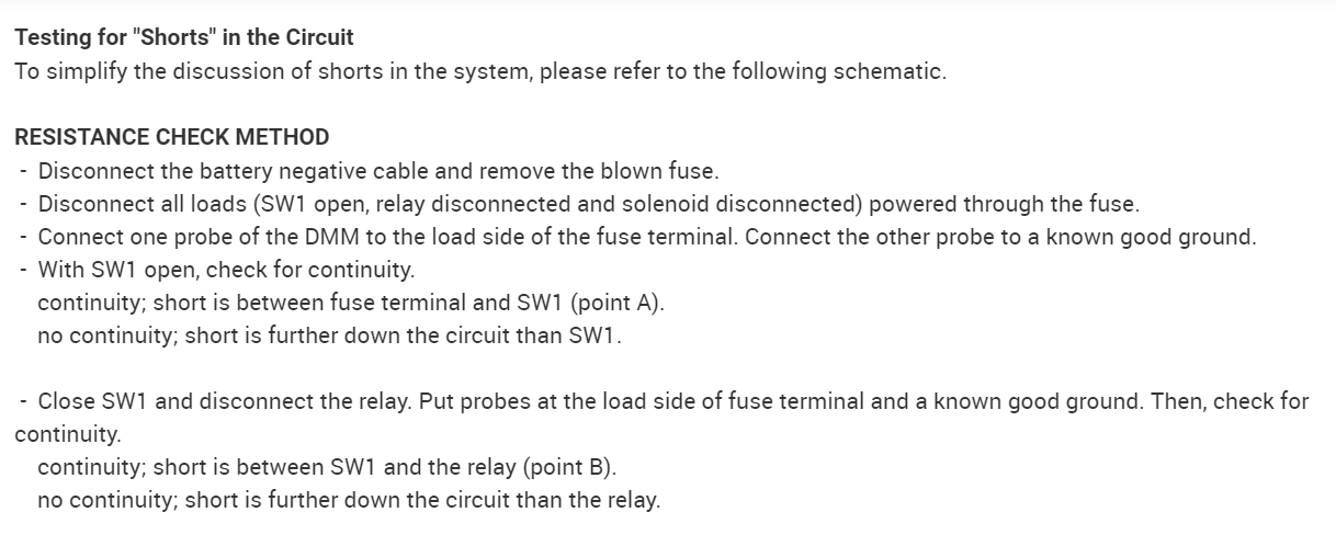

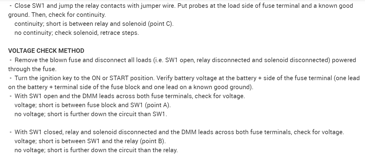

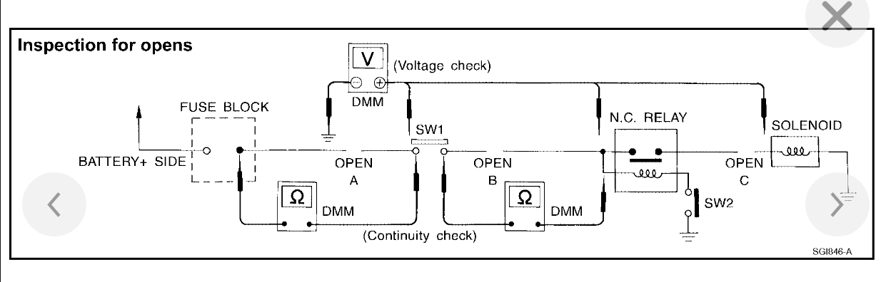

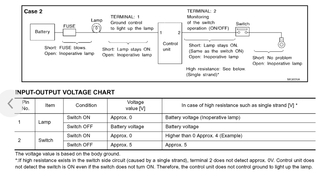

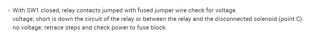

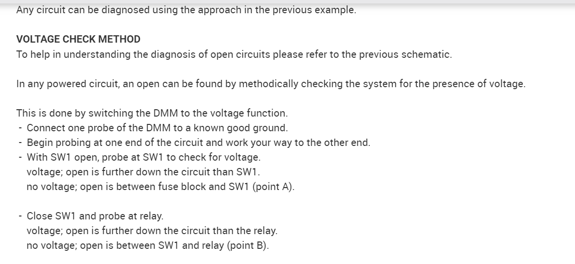

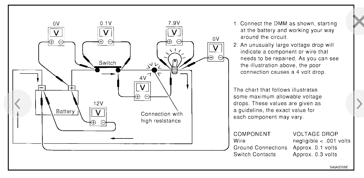

The information that you requested is in the diagrams down below. 1) check this circuit for an open 2) check this circuit for a loose wire or connector for pins that are bent, damaged, or have corrosion. Dielectric grease on connectors will also help. 3) Find the short to ground and replace fuse for this circuit. Unfortunately we do not have a listing for Mercedes Benz E200 in either one of our reference materials, so I will not be able to give you wiring diagrams for these circuits.Please go through the guides in the diagrams down below and get back to us with what you are able to find out.
Thanks,
Alex

I have done what you said i checked the wiring and the harness as well and i checked for wiring resistance and continuity and it all gave good readings but there was one thing.
I measured the reference voltage while the sensor is disconnected at the sensor connector end and I measured it as well at the ECM and both of the readings were 3.3V which i think is below the 5V reference voltage. I even measured the voltage using an external ground to discard faulty grounding and it seems like the ECM is giving out below spec reference voltage to the sensors.
