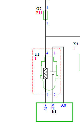

Hi, the car is acting a little strange. The first thing I noticed was the central locking system stopped working I know this is not a fuse as I checked the fuse box, and I can hear it click with I attempt to lock but none of the locks try to engage. I didn't think anything of it until this morning when I tried to start the car and nothing happened no dash lights or anything, this made me think it was the battery but when I flicked the overhead light on it came on and suddenly the car was fine. I started driving and got an engine light, so I took the car to have the code read and it came back with p1135 and p0139, manufacturer control and o2 sensor bank 1 number 2. I'm not sure what to do at this point and if I can keep driving it without damage or if these problems are something I can fix myself. also, I know this is likely related to the o2 sensor but the car stutters in 1st gear.

P0139 - oxygen sensor downstream from catalytic converter slow response
P1135 - oxygen sensor heater circuit upstream from catalytic converter
So, both oxygen sensors are affected.
Regarding the slow responding oxygen sensor 2, is there perhaps an exhaust leak on the front exhaust pipe/exhaust manifold?
If so, have this seen to first.

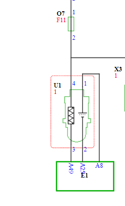

P1135, heater circuit can be caused by a bad connection at the O2 sensor, no 12V supply to heater circuit, faulty heater or faulty heater control/ground from the ECM.
Pin out at upstream O2 sensor
Pin 1, yellow/white wire signal to ECM
Pin 2, green/yellow wire signal to ECM
Pin 3, pink/white wire heater circuit control to ECM
Pin 4, brown/white wire 12V supply from fuse F11 in engine fuse block

I do not think that these O2 sensor issues will cause the non-start problem. They might cause the hesitation/stuttering issue.
Suggest to check and clean the main ground points in and around the engine compartment, battery terminals and connections at the engine fuse block
Hope this helps.
