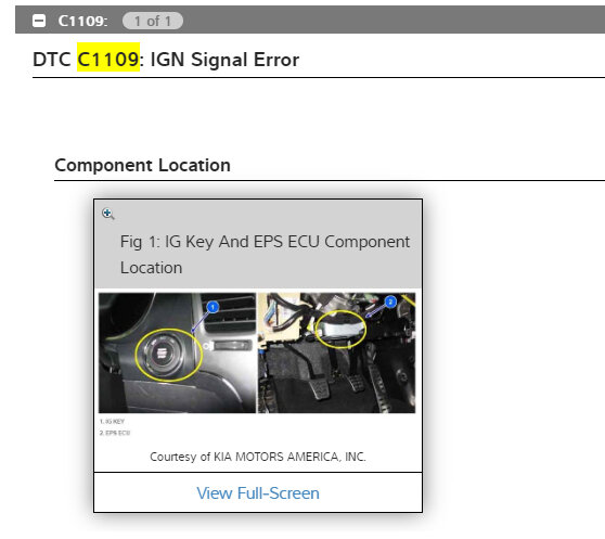

C1109 voltage low

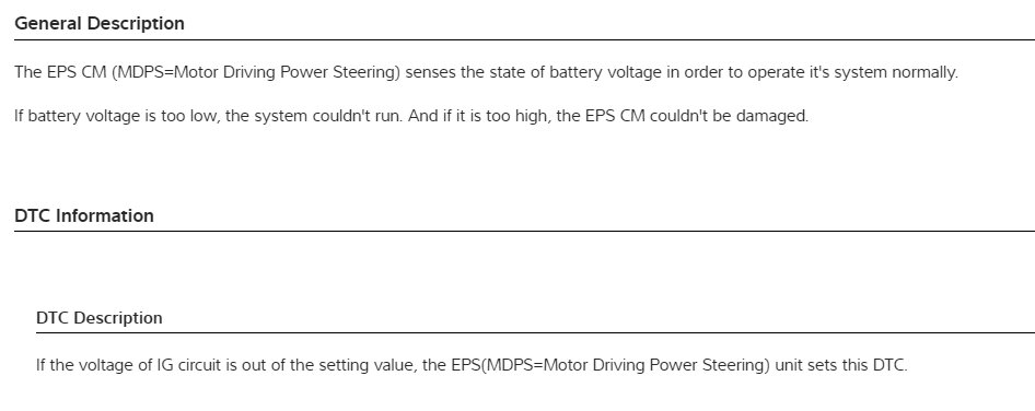

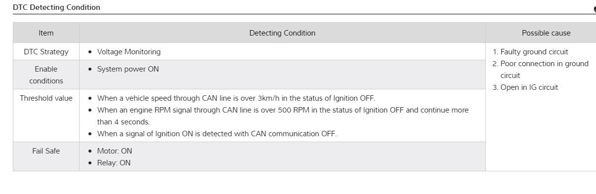

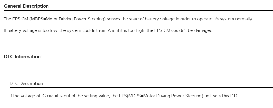

The codes can be related to the transmission. For example, the C1622 is related to a faulty speed sensor and the power steering assist.

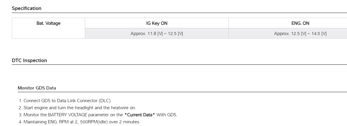

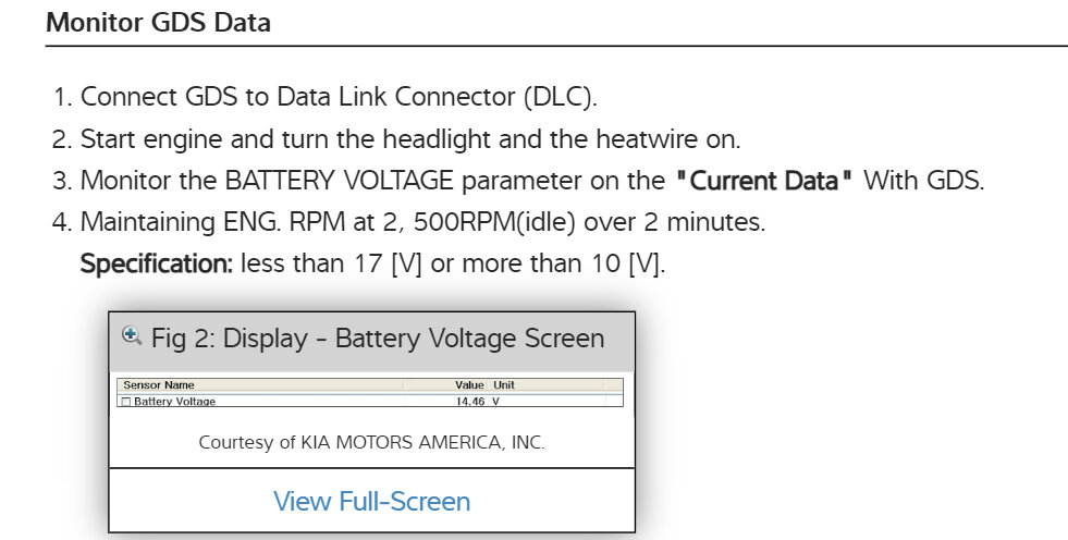

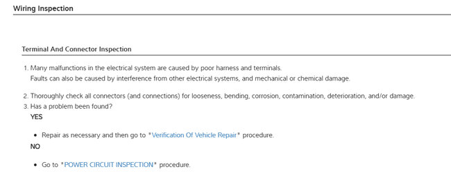

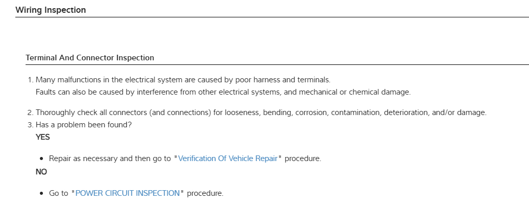

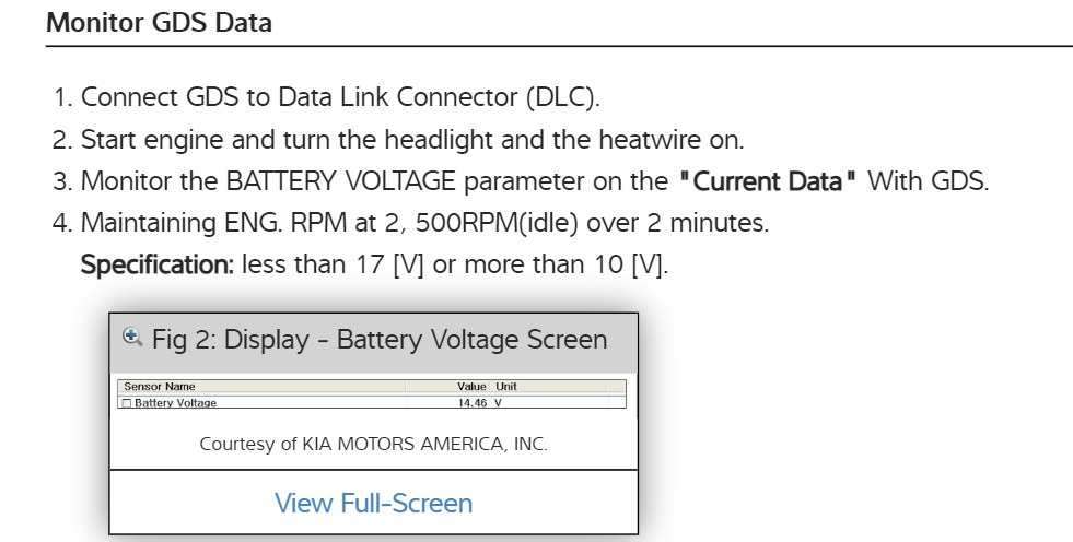

If it is slipping this bad, I don't feel an additive would help. However, a transmission just starts slipping this badly all at once. Also, it would have set codes related to the transmission. I feel it is a voltage-related issue.

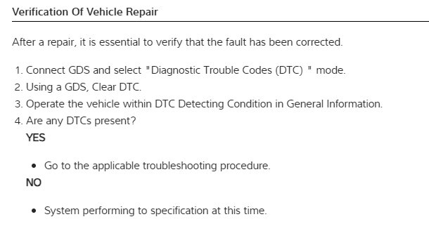

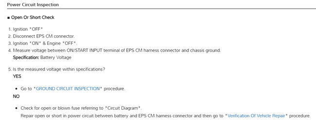

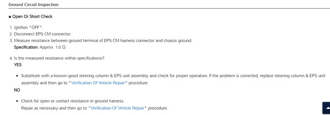

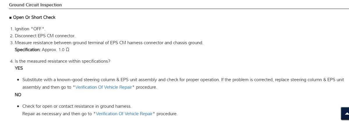

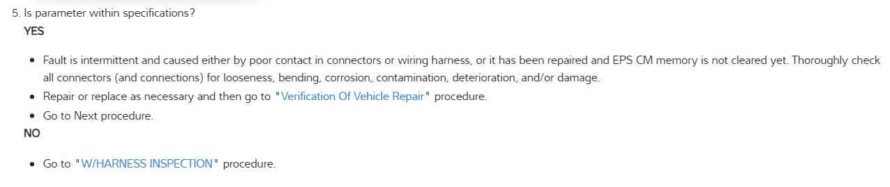

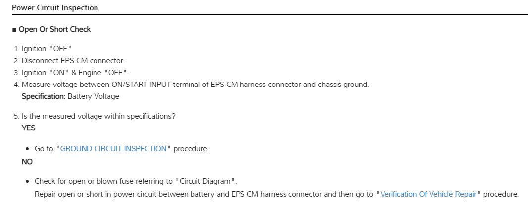

I attached the diagnostics below related to the C1109. Take a look through the diagnostics and let me know if you are comfortable performing this. Also, let me know if you have checked the transmission fluid's condition and level.
