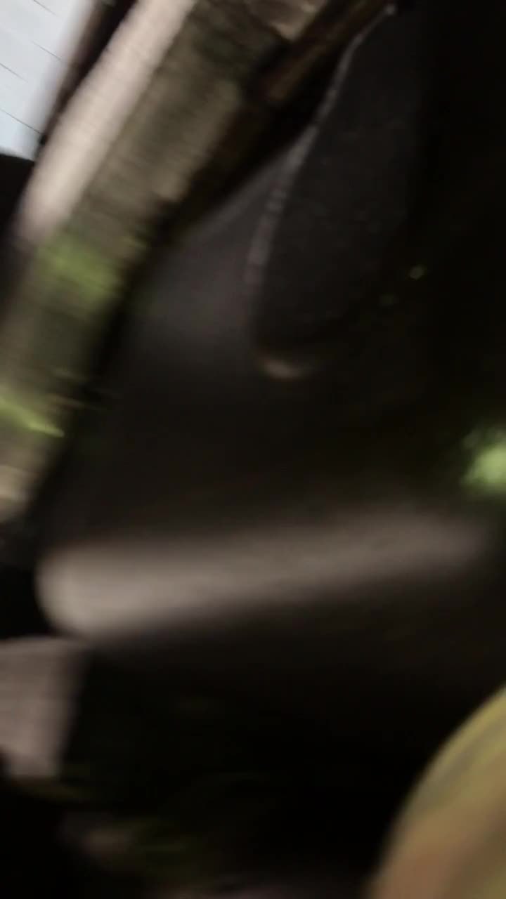

I have been leaking oil from under my car for quite some time now, close to a year. After inspecting plenty of times, I have had both valve cover gaskets replaced and also the intake manifold gasket, however there is still a leak. I have suspected that it is the oil pan gasket, but I also think it is the transmission pan gasket, I cannot really say for sure because the starter, which is right next to the body of the oil pan, is slightly covered in oil, and the seams around the transmission pan are too, there seems to be oil around a wide area. I posted a video.

I see two things off the bat with the video.
The oil drain plug. You cannot use sealer on the plug. You need to remove the plug and install the correct washer for the plug. You can see it leaking in the video and that will spray all over the pan when moving.
The bottom of the bell housing shows a good bit of oil. That could be a bad rear main oil seal leaking. When that leaks, it will throw oil all over the place.

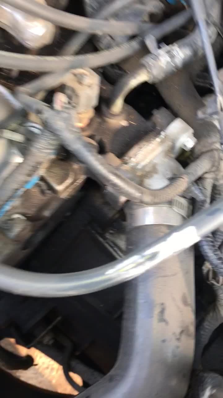

I was looking around again, this time from the top of the engine, and it seems that it is leaking oil from around the top of the transmission, around the corner under the intake manifold, right behind the thermostat. There is a bolt it seems, looks like it is seeping oil from there. What do you think this is?

Here is another video, it is hard to get a shot of it since it is under and behind so much crap.
Aug 13, 2018 at 5:49 PM
Good shots. From that video, it looks like the intake manifold is leaking.
I would do that first.

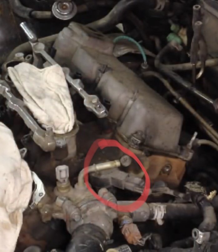

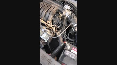

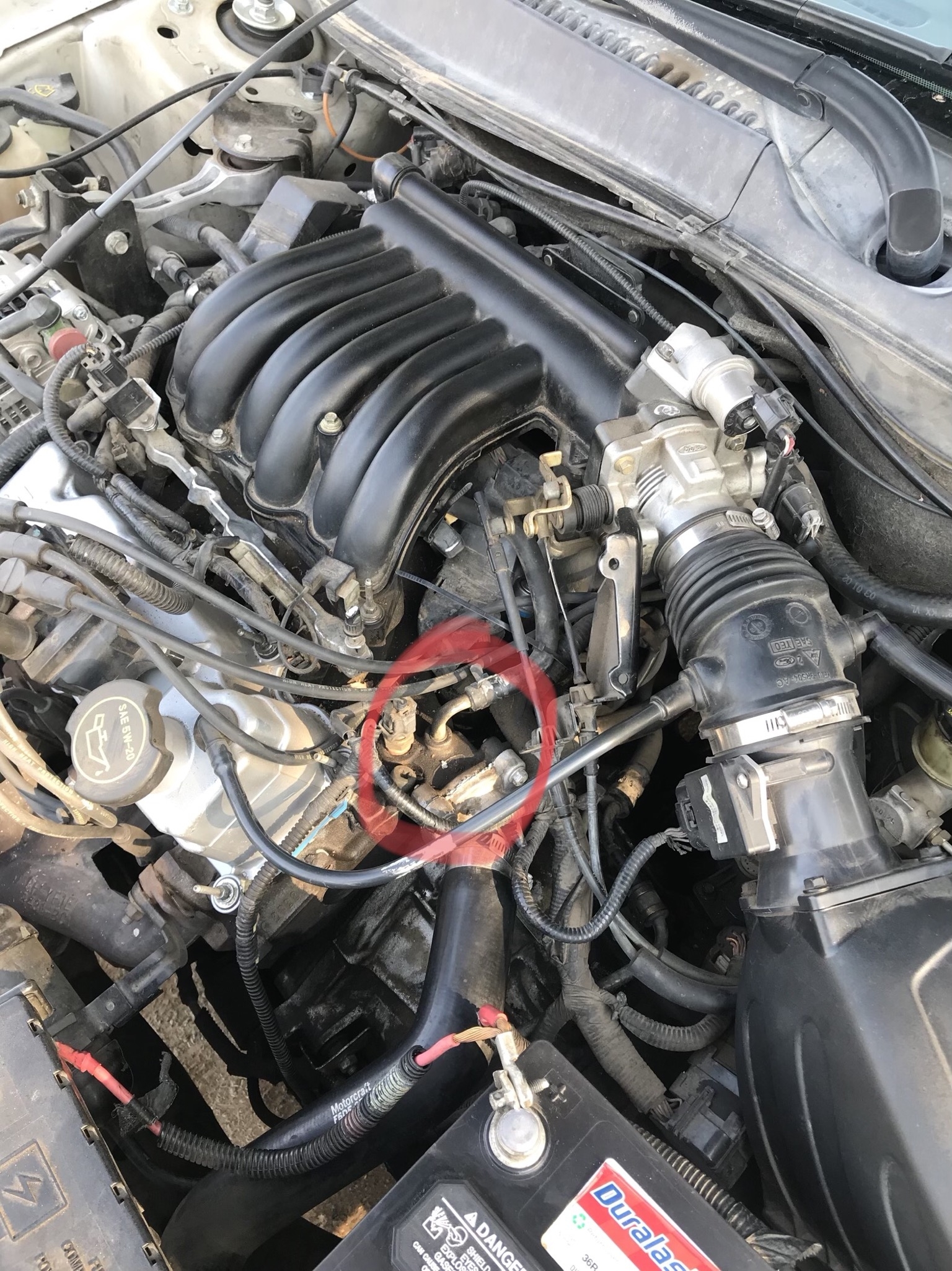

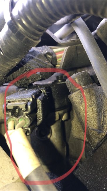

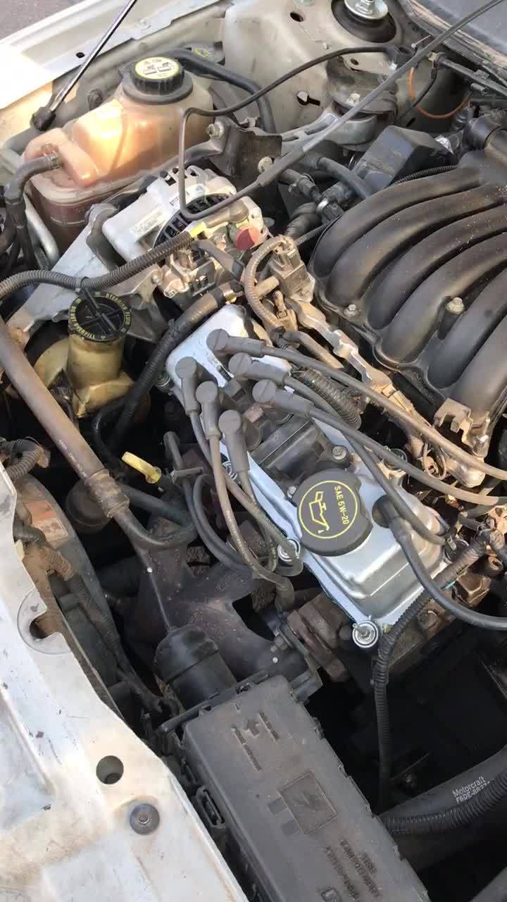

I looked around once again from the top of the engine, I am pretty certain it is not the intake manifold gasket, the surface is clean and there is no oil build or stains around it, this is the part that I believe is the culprit of the leak. I have no idea the name of it, but I took a screenshot of a video on the same engine, it is a head gasket replacement walk through but I circled in red the part I am talking about, and I took my pictures of my own engine, along with close ups (as best as I could get them) of that part, do you know what this is? There is a connector going into it, and oil is just sitting at the bottom of the part I am talking about.

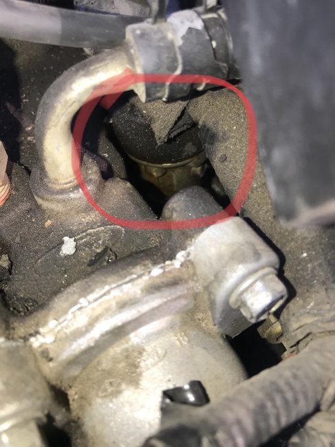

Close up #1
Aug 14, 2018 at 5:48 PM
JGONZO2398
  • 372 POSTS
Close #2
That is the lower intake manifold. From the pictures you sent it looks like the lower where it meets the block.
Aug 14, 2018 at 5:57 PM
JGONZO2398
  • 372 POSTS
And that is just a gasket fix?
Aug 14, 2018 at 6:09 PM
Yes it is, but the lower intake has to be removed to replace the gaskets. The ends where it meets the head they use a sealer. They use RTV between the block and the manifold.

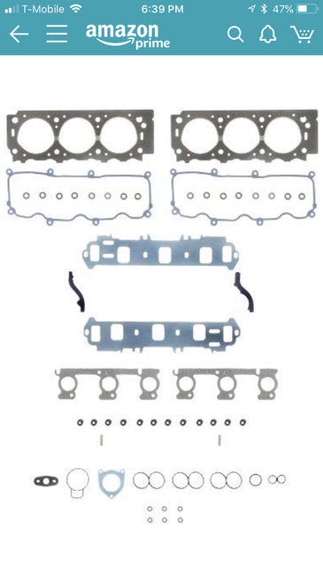

This is the gasket set I bought from Fel-Pro, my mechanic told me the intake manifold gasket did not come with the set, but I am pretty sure it is in included. Which one of these is for that lower intake you are talking about?
Aug 14, 2018 at 6:40 PM
That is a headset and yes, the ones in the middle are the ones you need. They are blue with the black end pieces.

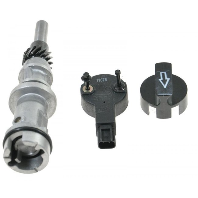

Took it to my mechanic this morning, turns out it is the camshaft position sensor, it is the whole unit, the synchronizer, there is engine oil seeping out from where the synchronizer goes into the engine block. Is there some sort of gasket or O-ring for that part?
Aug 16, 2018 at 9:20 AM
Yes, there is a seal that keeps the oil from coming out. You can just change the o-ring seal.
