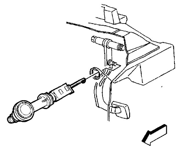

  • 110,248 POSTS
I noticed it has been a couple days since we've heard from you. Have you made any contact? As far as the issue, is it only difficult to shift into gear when the engine is running and shifting from neutral to first? If so and you can shift it easily with the engine off, you may be having an issue with either the clutch slave cylinder or clutch master cylinder. Make sure the fluid isn't low. The clutch MC is located on the driver's side, under the hood and bolted at the firewall. I attached the best pic I could find.
Let us know.
