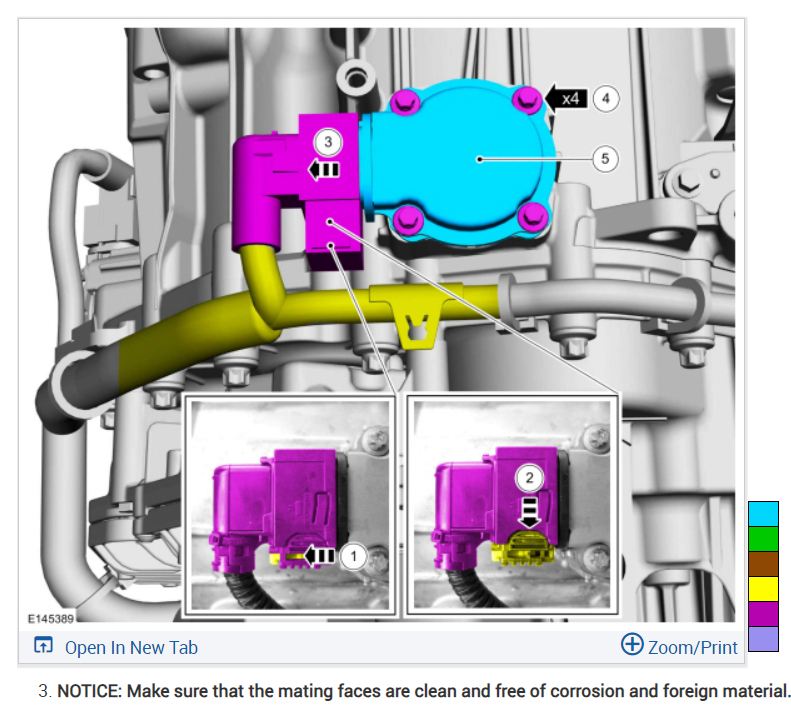

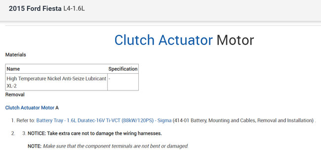

My friend has this car and about 2 weeks ago the check engine light came on and she said the car "didn't want to go". I plugged in a code scanner and got P0902. I cleared the error, and she says it's been fine since.
Today she says when she cranked it up, the traction control light was on, but it went off after driving a few minutes. No check engine light this time.
Could this be a sign of imminent transmission failure, or could it be easily fixed? I'm not too familiar with Ford myself.
Sep 4, 2024 at 10:49 PM
  • 55,423 POSTS

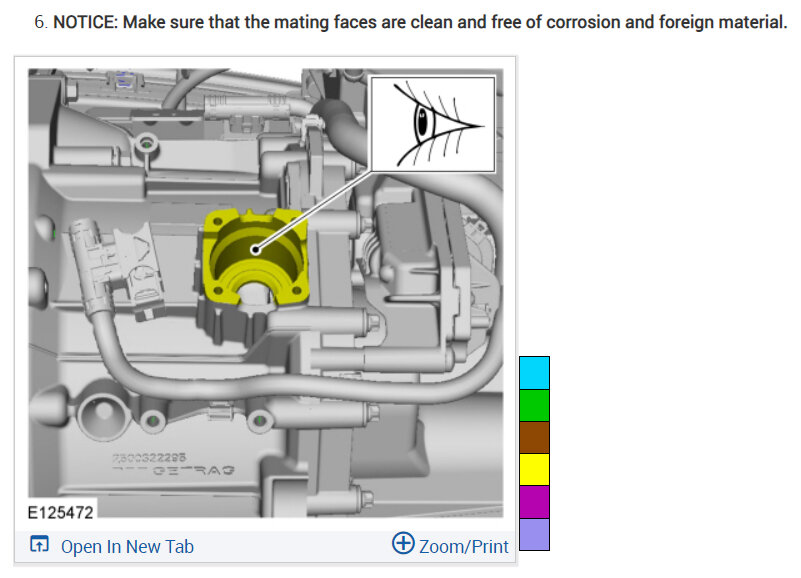

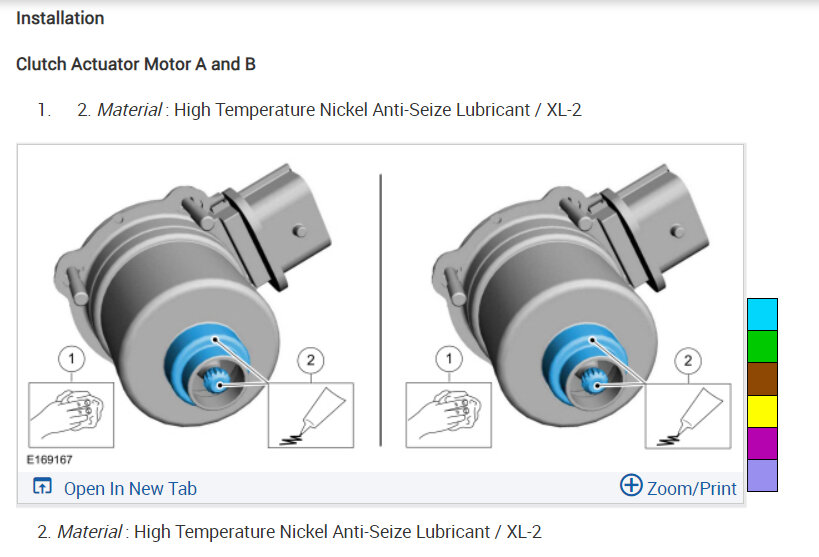

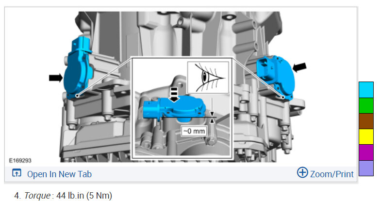

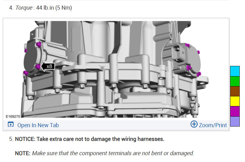

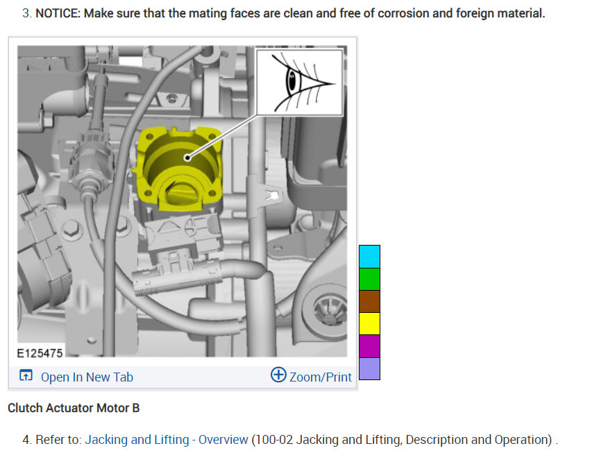

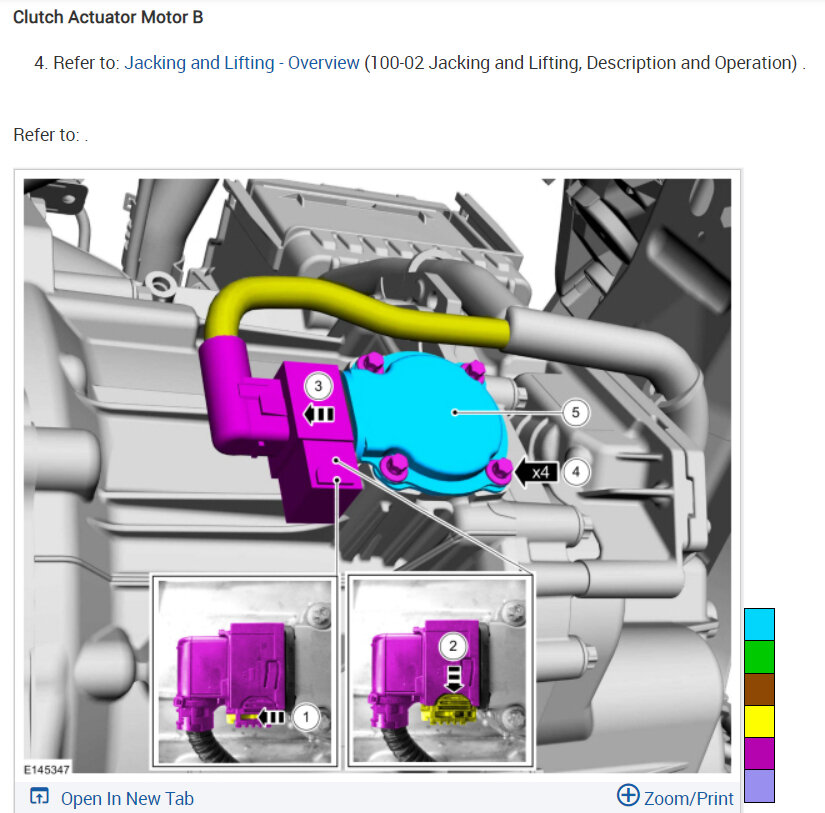

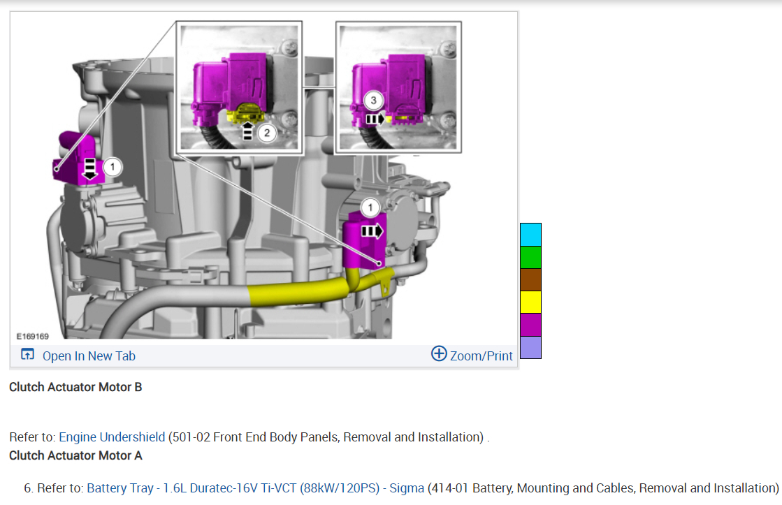

The P0902 code refers to a "Clutch Actuator Circuit Low" which is a common problem because the clutch actuators can go out and cause this issue. I would replace both clutch actuators, they even sell them as a kit which is helpful. Clear the codes once the job is completed. Check out the images (below). Please let us know what happens.

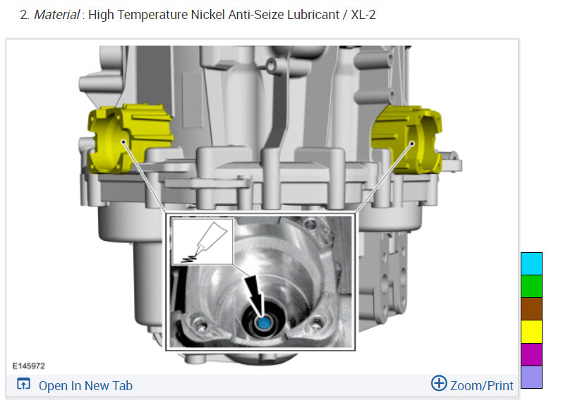

I'm back again she is finally going to get them replaced soon. I know you sent me the diagrams but how difficult is this job actually? Can I get to it from underneath the car, or do I have to drop the transmission? I've seen online the dealer charges $2600 to fix it.
Apr 22, 2026 at 4:30 AM
  • 55,423 POSTS
That seems steep to me, you don't need to remove the transmission. You can get to the actuators one from up top and the other from below. I believe they may make a kit that does this. Please check rockauto.com

Ok got the new ones installed. Had to search around for the nickel anti-seize stuff only one local store had it. She hasn't driven it yet but I let her know about the relearn and it might be a little jerky when shifting until it smooths out.
