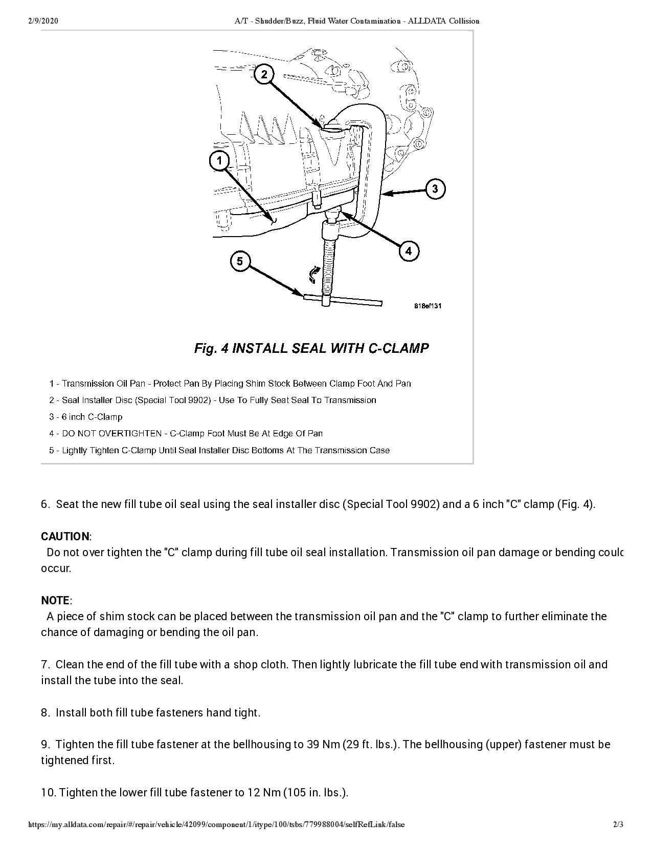

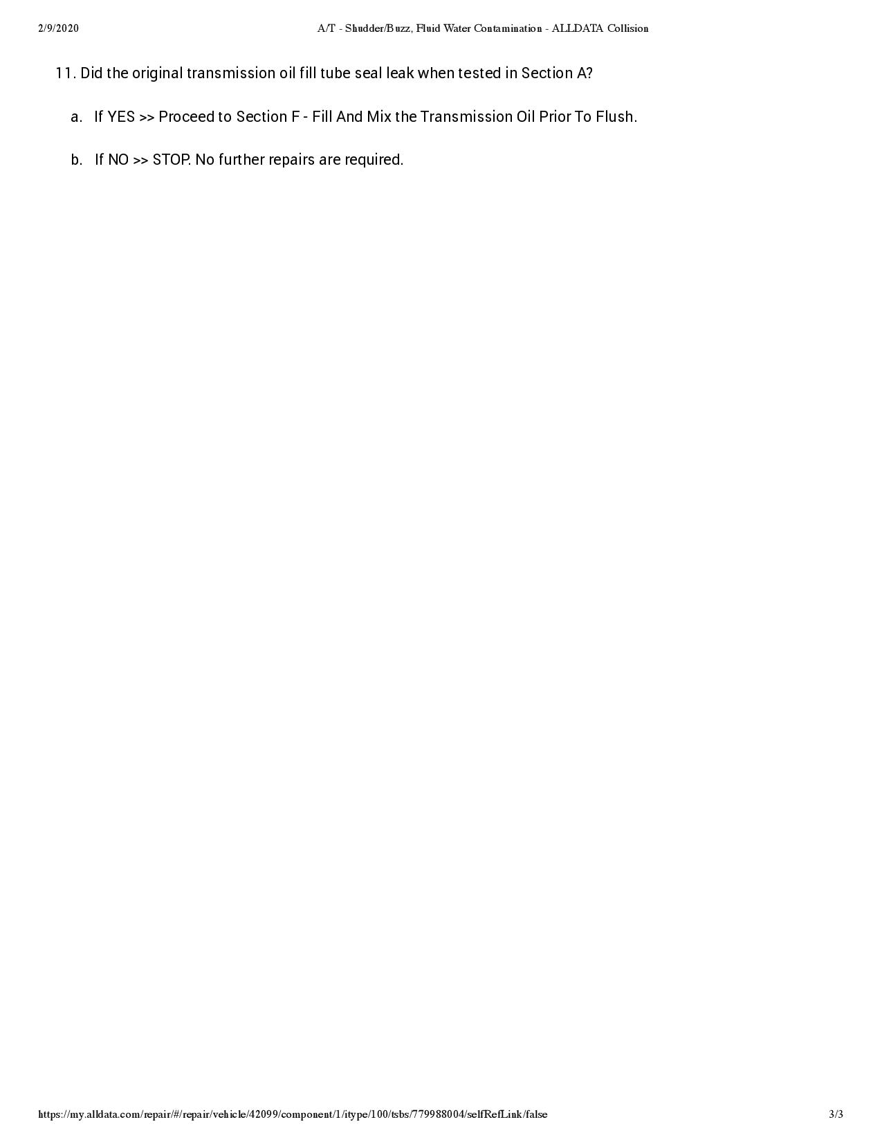

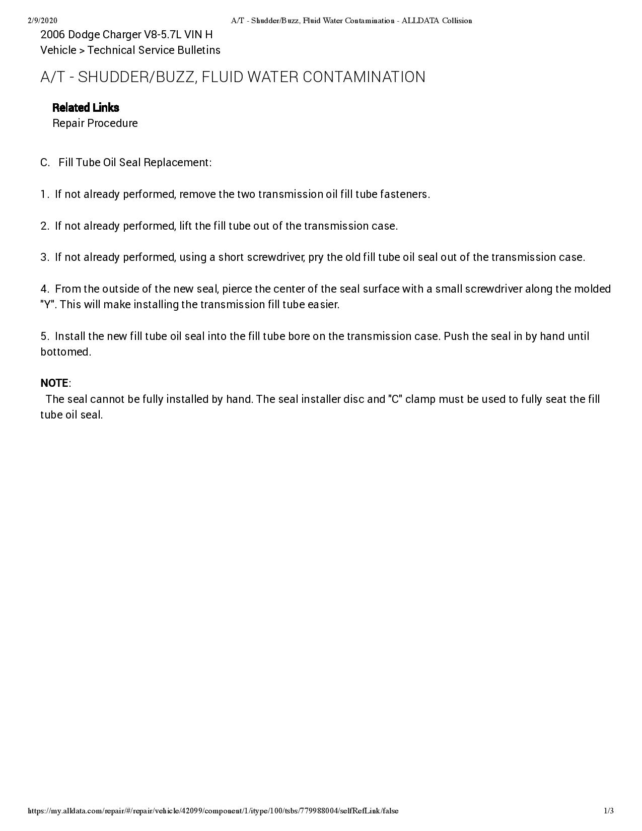

JOETECHPRO
  • 705 POSTS
Hey TMCINTOSH11,
There looks like there is a TSB for water contamination of the A/T fluid on these vehicles that will cause the torque converter lock up shudder previously described. TSB attached below.
The water leaks in around the transmission oil fill tube.
You would need a transmission flush and replacement seals if this TSB is applicable.
You may want to raise this with the dealership too.
Hope this helps, please keep us updated with your progress.
Regards, Joe

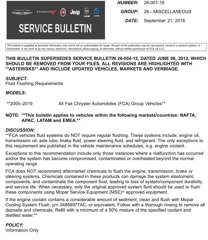

Don't use additives in a transmission. The correct transmission fluid already has the additives determined to be needed by the people who designed the transmission. When you start mixing different products, they can have additives that fight each other. This is equally important with engine oil. You can run into a seal conditioner in one brand of oil that is not compatible with a detergent in another brand. There's also dispersants, corrosion inhibitors, viscosity index improvers, and anti-foaming agents that all have to work together.
+1

CARADIODOC
  • 33,873 POSTS
I left the dealership after 1999. Since then, a lot of manufacturers have gone to designs that prevent you from doing your own service on their transmissions. One can only wonder what that accomplished or how it benefits the car owner.
I was going to post the procedure for checking the fluid level and for performing the seal repair, but those require very specialized tools and equipment that only the dealer has. I prefer to do all my own work on my vehicles, but this is one time when it probably is beneficial to visit the dealer. In the long run you will be better off. The fluid level has to be calculated from reading its temperature with a scanner, the level on a special probe inserted through the tube, then finding a point on a graph.
Here's the service bulletin JOETECHPRO referred to.
