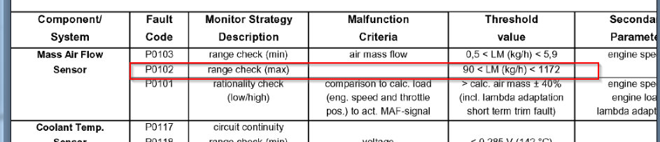

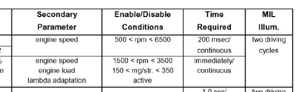

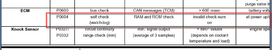

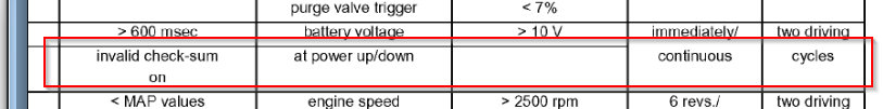

As for this code.
P0604 - Internal Control module Random Access memory error.
It is most likely an internal issue with the ECM. However, I suspect that will clear once you give it a couple drive cycles if it is not a failed ECM. I would just let it idle for a little while and see if the tick and smoke resolve themselves. The smoke may just be water, oil, burning out and the lifters may be tapping a little and could pump up. We want smooth idle and no knocking. You hear this, shut it down.
P0102 - MAF circuit low
Again, I would see if this comes back after a couple drive cycles.
