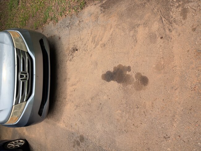

On a 15 year old car an oil "seep" is normal. how big is the puddle, can you upload an image?
May 2, 2026 at 10:09 AM
ETERNALARIANNE
  • 240 POSTS
Attached an image of the fluid spot on the ground. Again, oil and transmission levels are good. Brake fluid and PS are good. Coolant was at the MIN line but not empty
May 2, 2026 at 10:30 AM
  • 55,433 POSTS
Yep, that is too much. It does look like it can be the rear main seal by the position of the leak. We need to raise the front of the car for inspection. Thanks for the image, it helps.

I put some cardboard down under the car and parked over it for a few hours. I got about a tennis ball size spot of fluid that is definitely oil based on the look and smell. And it's directly in the middle of the engine so either the rear main seal or oil pan for sure.
I guess I have two leaks but the oil pump gasket isn't as bad...
May 4, 2026 at 12:00 PM
  • 55,433 POSTS
Yep, that is what it looks like, if the oil leak showed up all at once it is most likely the rear main seal popped out which is common.

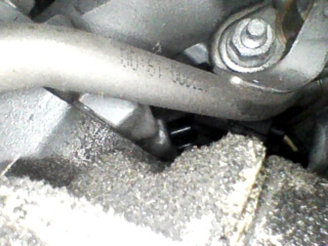

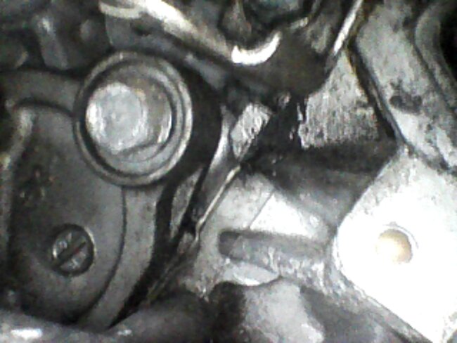

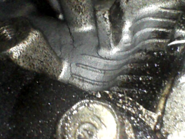

I ordered a boroscope I'm going to run it back down behind the motor and take a look around, as well as around the oil pump area. I'll report back what I find

Ok I managed to get pics of around the cam-end plug on the back driver side. It definitely is leaking and not just a "seep" at least to me. I didn't really see any leaks anywhere else, all road grime.
Jun 27, 2026 at 4:21 PM
  • 55,433 POSTS
Yep, that is not a seep, that is a leak it looks like you found the problem, I would replace the O right seals and then clean the engine to watch for any other leaks. Let me know how it goes.
