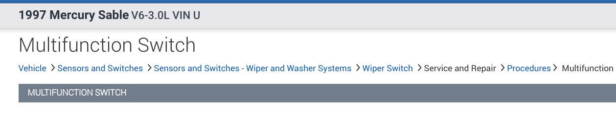

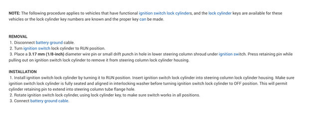

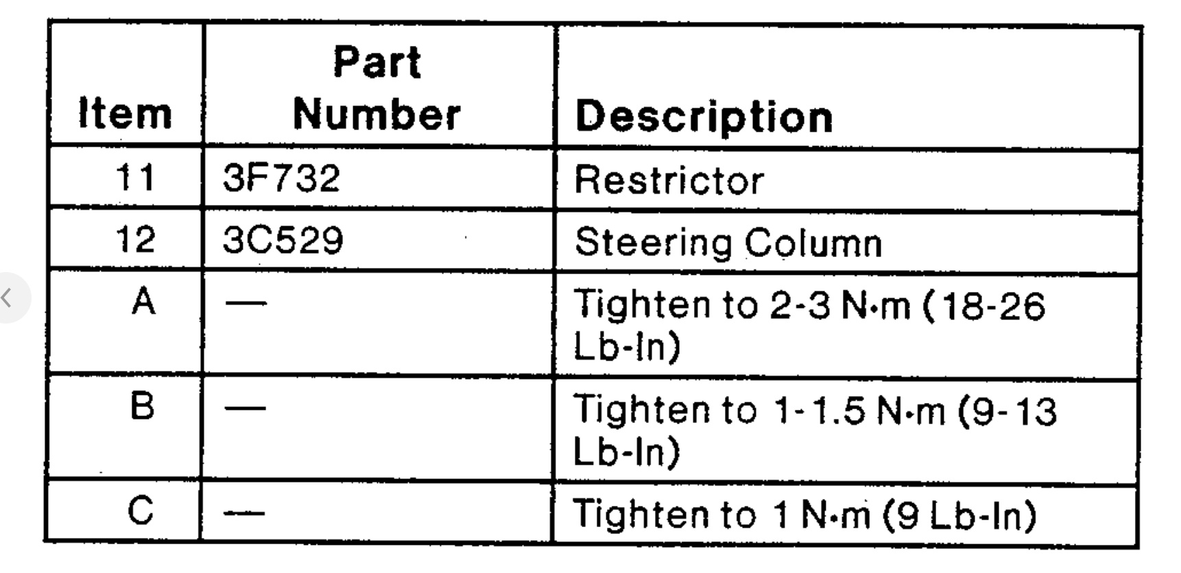

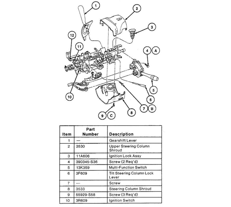

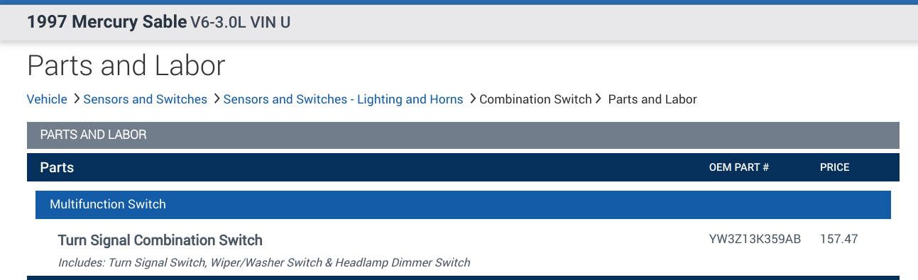

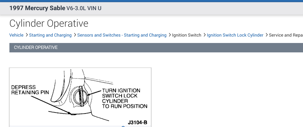

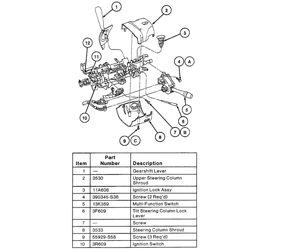

This sounds like you could have a problem with the combination switch on your vehicle. In the diagrams down below I have included the Original Equipment Manufacturer[OEM] part number for the combination switch as well as the instructions for the removal and installation of the combination switch for your vehicle. Please go through these guides and get back to us with how everything turns out.

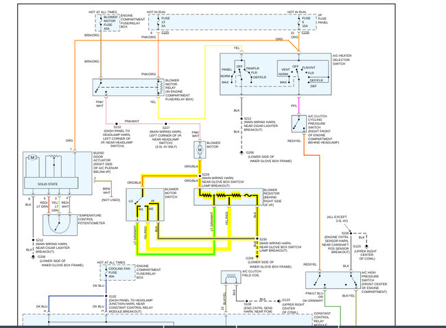

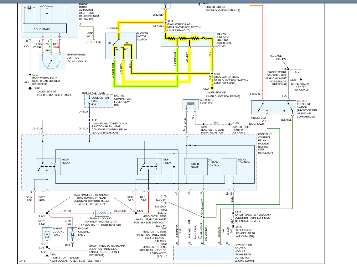

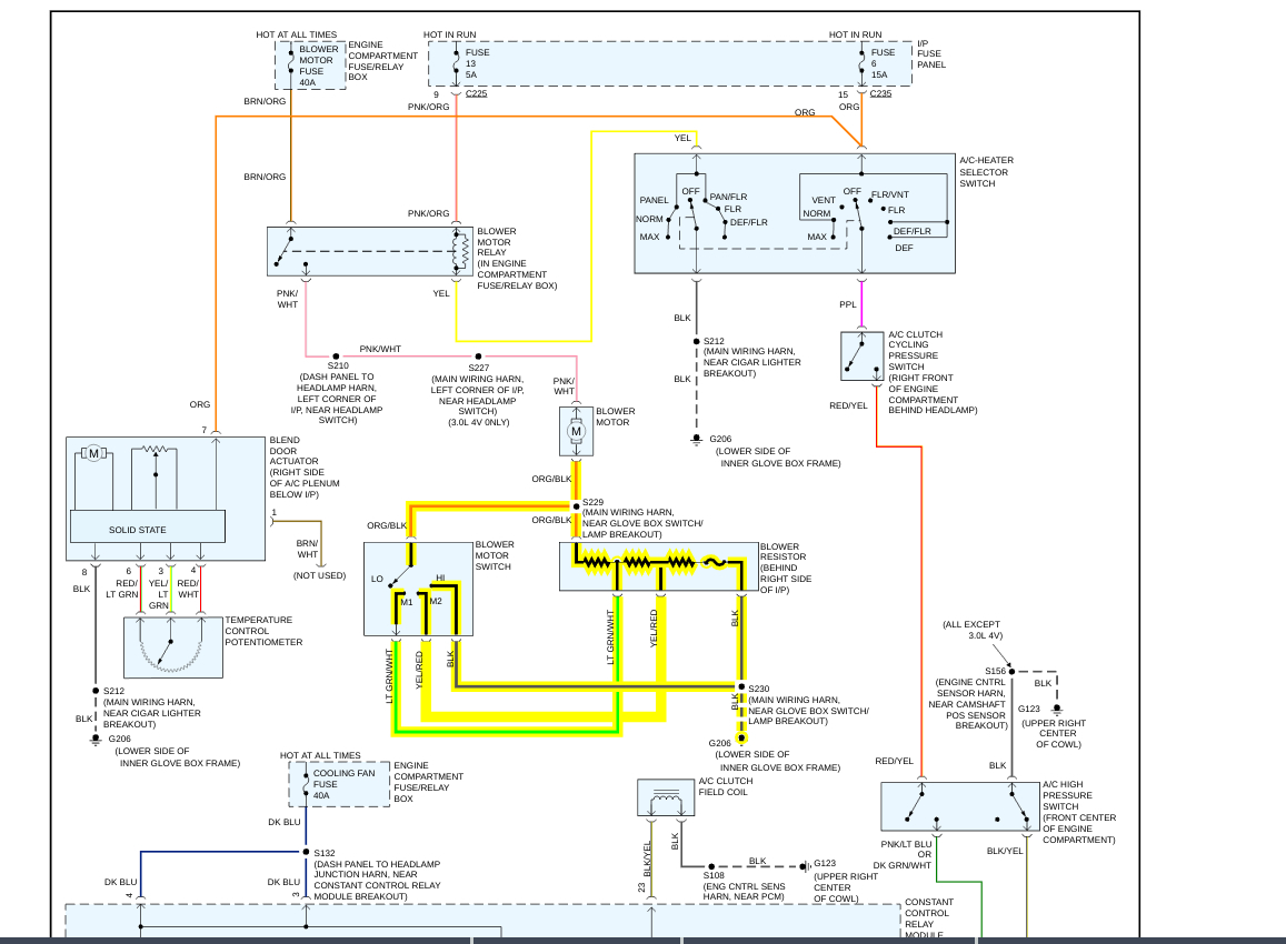

No, it will not. The blower sounds like it could be a problem with the blower motor ground, ground #206, which is in the lower side of the inner glove box frame. Check this ground and insure that it is clean, corrosion free, tight, and making good metal to metal contact. I have also included for you in the diagrams down below your vehicle's Heating Ventilation and Air Conditioning[HVAC] wiring diagrams with the ground portion of the blower motor circuit high lighted for you, for reference. Please get back to us with what you are able tofind out, and we can go from there, if needed.

Thank you. I will check this while replacing the multifunction switch.
