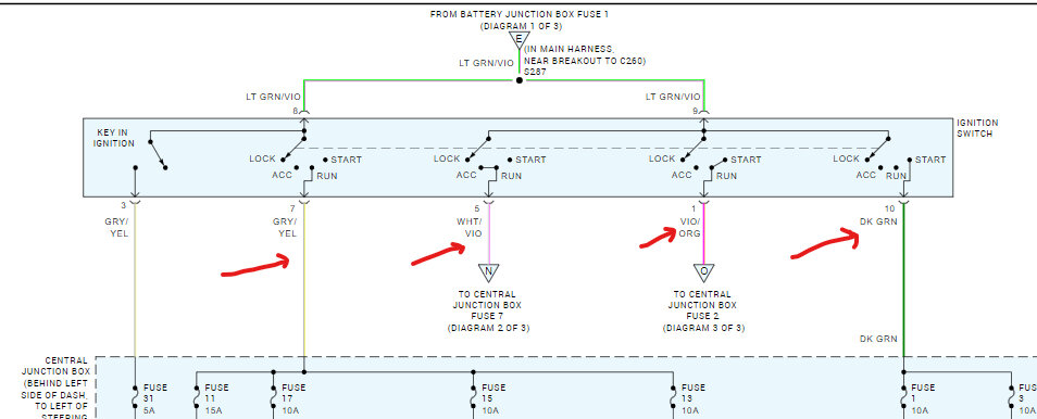

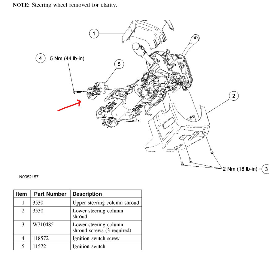

This can be the ignition switch or the gear range sensor shorting out, but I would check the battery cables to make sure there are clean a tight on the battery. If so, you can test through the ignition switch to confirm no power to the wiring that is to be power by it. Here is a guide to help and the ignition switch wiring diagrams so you can see how it works.
I have marked which wires should have power when the ignition switch is on. Check out the images (below). Please upload pictures or videos in your response of any problems so we can see what to help you with.

Ken, thank you for your reply and diagrams. I ordered both parts mentioned yesterday. I also have the complete wiring manual for this car, but it gets difficult to visualize the components. As soon as the weather clears up, I'll test the wires to the position sensor. This car has had issues with wires corroding inside the covering in the past.

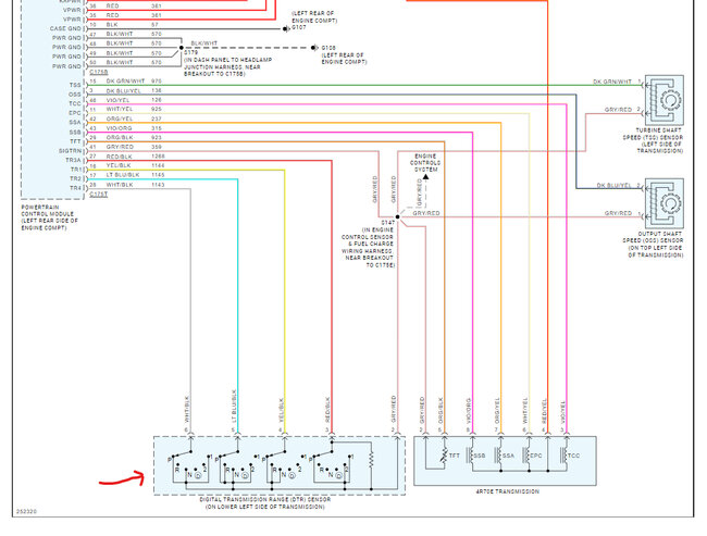

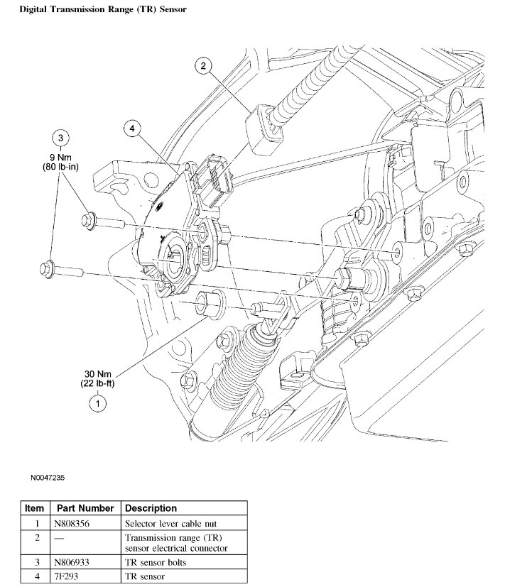

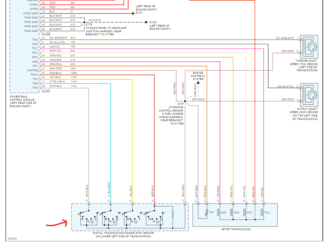

You might be right with the ground connection; I would make sure the ground to engine and ground to frame/chassis is good. Also, could it be the battery is having issues, can I ask how old the battery is? You might want to have it load checked at the auto parts store.
The Digital range sensor on the transmission does report to the PCM so if that is having an issue it can cause this problem, I would disconnect it after the engine is running to see if it stalls if you can, here is the location. Check out the images (below). Let us know how it goes.
