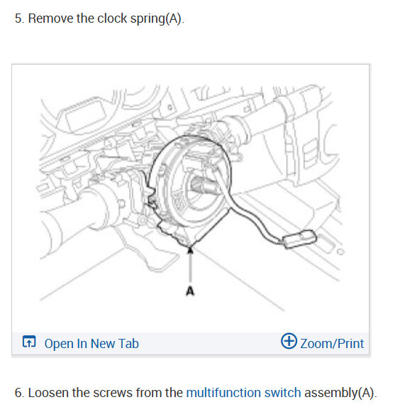

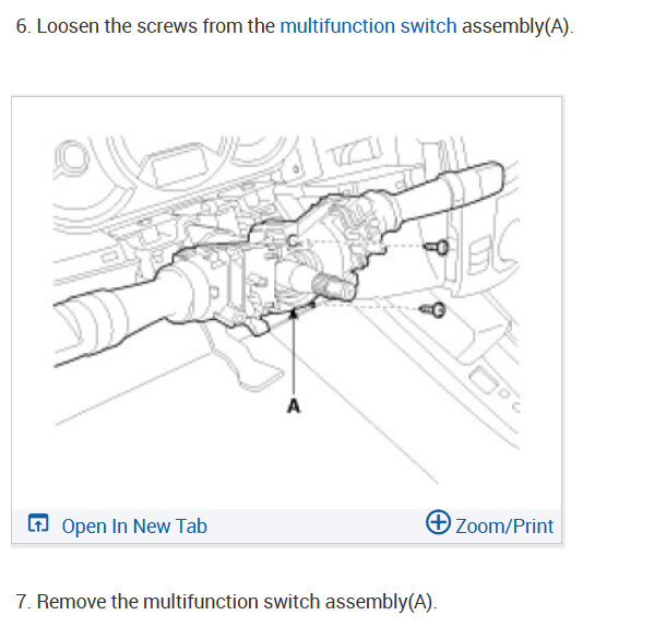

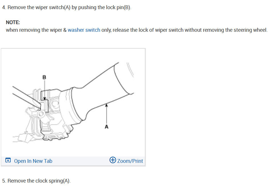

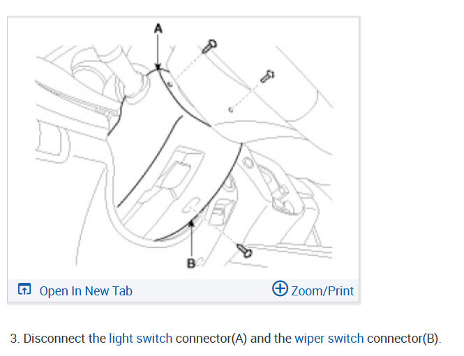

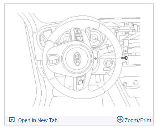

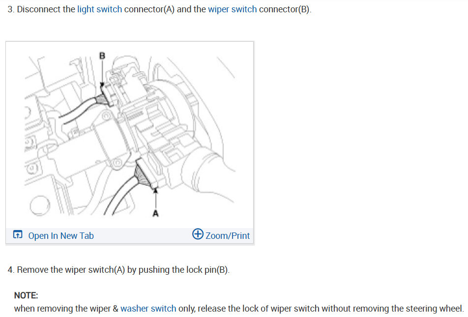

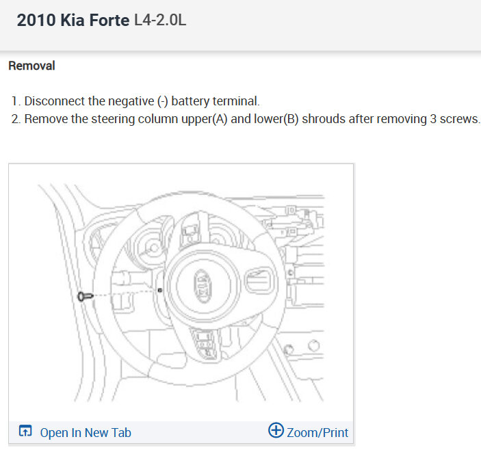

I think you are headed in the right direction, when the turn signal switch fails it acts light this. Here is how to change the switch out. You will need to remove the steering wheel so disconnect the battery first to disable the airbags. Check out the images (below). Let us know if you need anything else.

Replacing the switch fixed the issue. In case anyone else comes across this thread, I’ll add a few helpful tips:
You will need a Philips screwdriver, flathead screwdriver to gently pry and push clips, a T40 bit to loosen the airbag screws, and a 13/16 socket for the steering wheel.
The job took me just over an hour - taking my time and referring to online videos. A few things looked different than online but taking my time (and photos) made sure I got everything back together properly. I used a felt marker to be sure I tightened the steering wheel and clock spring back in the same spot.
Huge thank you to Ken and 2CarPros for the assistance.
