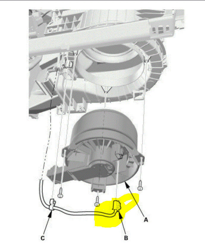

First, I turn car on and my air conditioning randomly doesn't turn on at all. Switch from low to full blast and nothing, drive for 5 minutes and suddenly it comes on.
Second, got in my car today and radio was only on right side speaker and not left. Nothing was changed in speaker pan, this has happened a long time before. If I get back in car and turn it on it will work perfectly.
Are these fuse related problems?

If there was a blown fuse, they wouldn't start working. Also, a bad fuse wouldn't cause only one side of the radio to work.
As far as the radio, it could be a loose wire to the speaker. Don't laugh, but did it start working after shutting the door?
Now for the blower motor, check the connection at the blower motor for condition. Make sure it is tight and doesn't appear as though it was overheating.
The blower motor is located under the dash on the passenger side behind the glove box. I attached a pic below and highlighted the connector I'm referring to.
Let me know what you find. Also, let me know if once it starts working again if all speeds work.
See pic below.
