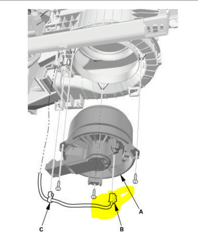

Now for the blower motor, check the connection at the blower motor for condition. Make sure it is tight and doesn't appear as though it was overheating.
The blower motor is located under the dash on the passenger side behind the glove box. I attached a pic below and highlighted the connector I'm referring to.
Let me know what you find. Also, let me know if once it starts working again if all speeds work.
See pic below.
