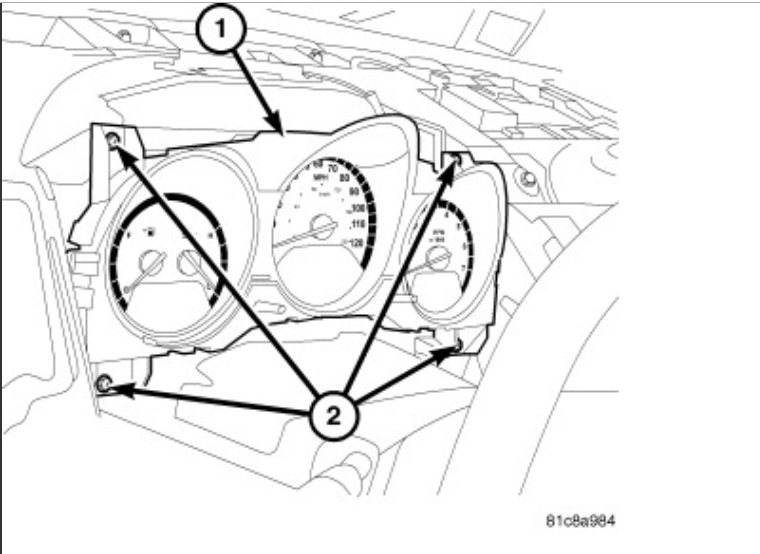

Dash flashes and speedometer needle bounces as if going to shut off but does not.
Oct 21, 2017 at 10:57 AM
  • 55,694 POSTS
It sound like the instrument cluster is going out. If you get a used one it might need to be programmed at a shop. Here is a diagram that will help you remove the unit. (below)

I would try disconnecting and reconnecting the cluster to clean any bad connections just to see if that was the problem.
Please let us know what you find. I'm interested to see what it is.
