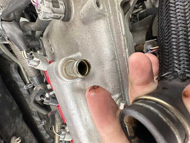

I replaced the plugs and packs, battery and connections in My car and it is still shaking and idling roughly when I come to stop. It stopped for a little while then started again soon after. It’s also hesitating on starting but not every time
The rough idling happens every time I come to a stop, if I switch it to neutral, it calms down a bit. I haven’t noticed any odd sounds other than a sort of lower pitch whistle coming from up the engine bay but that’s been there for a while.

Thank you for your answer, I checked the hoses, and they all seem to be in good condition. Only thing I can take note of is the vacuum hose that leads to the intake channel, from the intake manifold has oil coming from inside the male end on the manifold. Some of it is gunky like it’s been there a while. And the hose slid off way too easily because of it.

Okay, I added some info in my last post if you refresh this page, you'll see some areas to check. I can't really identify the area of that hose, I think the picture is just too close, but oil starting to back up into the intake and vacuum hoses usually means a stuck PCV valve, but that is not really going to cause the idle issues you are having. The PCV valve looks to be on the back side of the engine on the passenger side.
