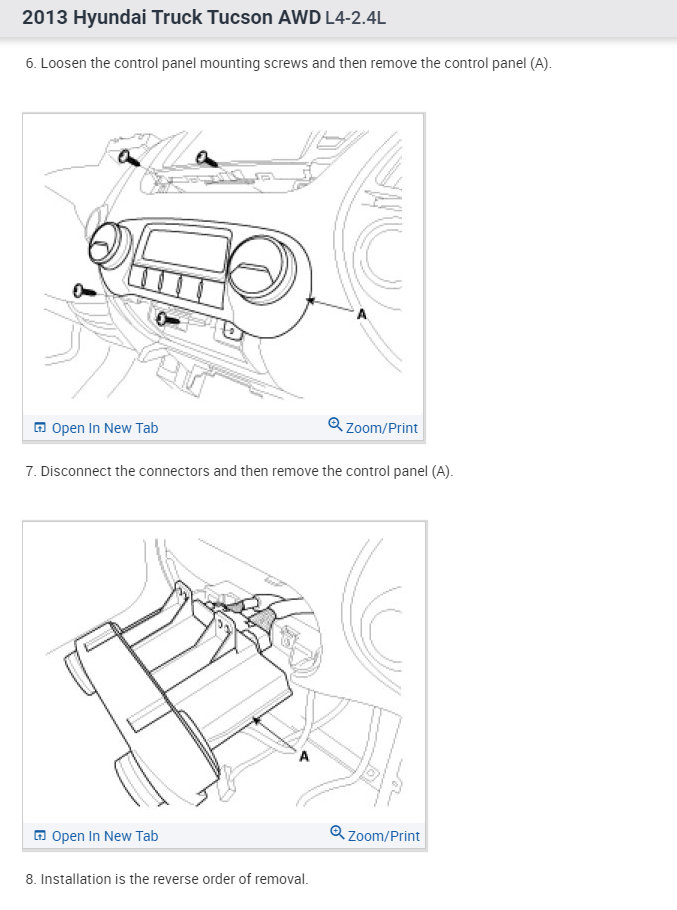

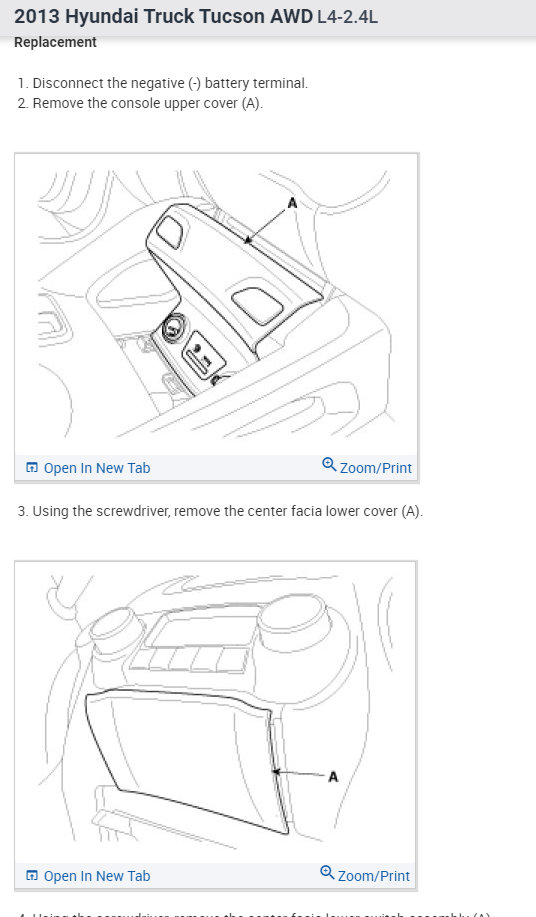

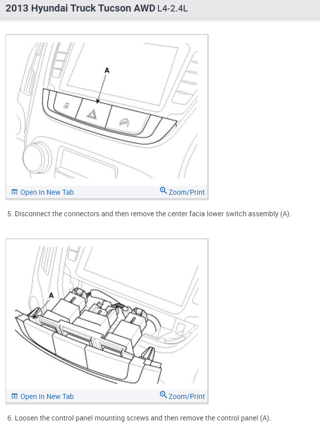

So, someone was angry and actually kicked my dash (stupid i know) but where A/C buttons like max A/C, defrost button and right said of radio buttons they don't work. Like max A/C don't come on and my defrost won't work!! Help me.
Dec 16, 2021 at 9:14 AM
SQM
  • CAR REPAIR CONTRIBUTOR
  • 6,383 POSTS
It is possible that something just got simply unplugged.
The best option would be to remove those panels and switches and take a look inside.
Look for any loose harness or broken pieces.
Keep in mind that depending on the impact it can have internal damage to the control switches.
I have attached diagrams of how to remove the HVAC control panel below.
