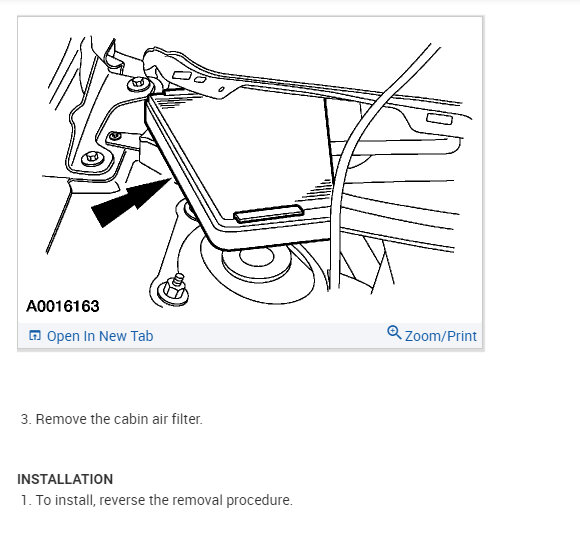

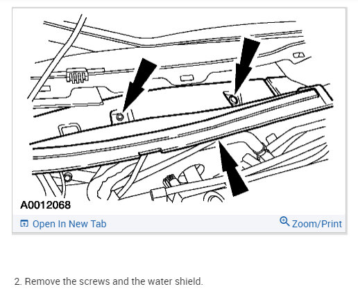

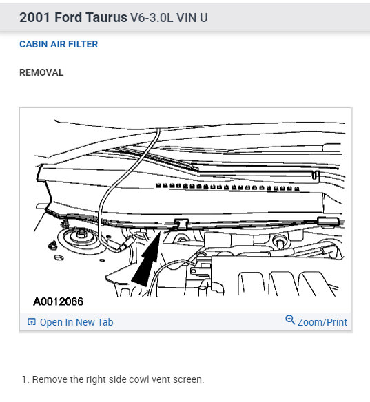

Not all of these vehicles came with one, but most did. Have you checked to see if the cabin air filter is clogged?
If not, start with that. I attached the directions below for accessing it. It is under the cowl, engine side. See the directions below for removal and replacement.
Let me know what you find.

Thanks again! What a nightmare lol. The job itself was very easy, I took the cover off it to get to the filter and realized the guy that replaced it before me, broke it and tried to glue and duct tape it back together. the filter was so clocked that even if that is not the problem, I am glad I replaced it. Car only has 80,000 so the filter was changed at least once before. I had to go dig through my local boneyard to get another plastic piece to cover it so maybe it won't be as clogged again. We have only put 40,000 on it. I am thinking that because it was broken even though it was taped and glued, it was still falling apart so I think it just had a lot more crap in it than normal. Thanks again!!!
