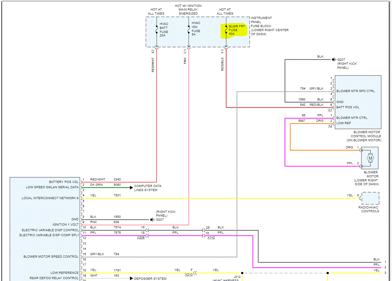

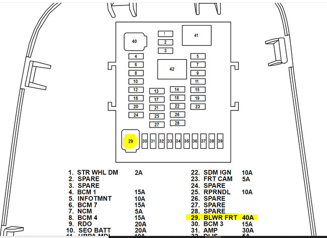

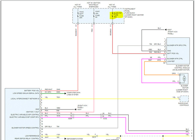

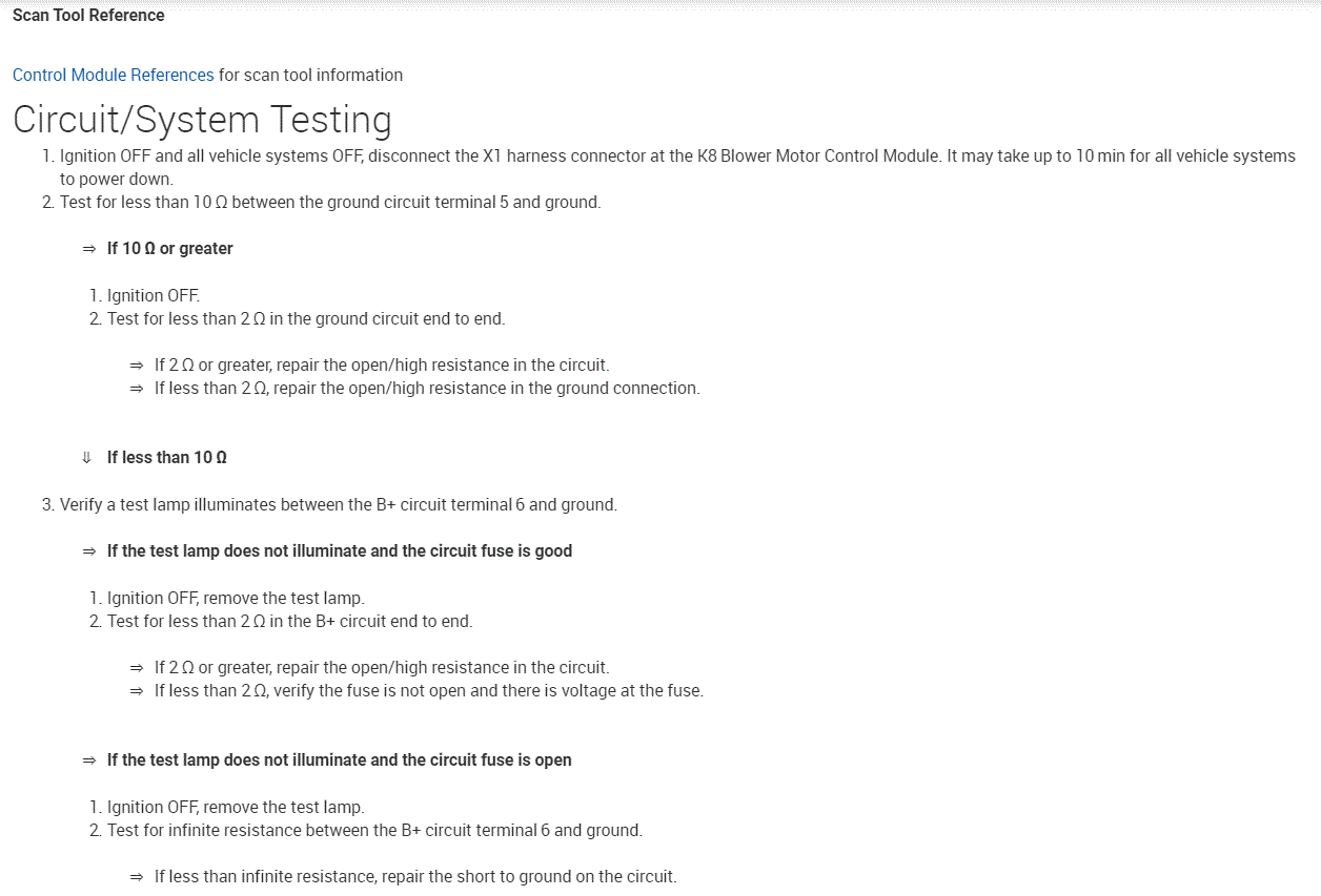

As far as the blower motor, the idea that water is coming out of the vent may have caused the motor to fail or even just a fuse. So, let's start simple. I attached the wiring schematic below showing the blower motor circuit. I highlighted the fuse to check
When checking the fuse, it's not only important to check the fuse, but also, it's important to check for power to and from it. Here is a link that will help:
Pic 3 shows the fuse to check.
Also, let me know about the water issue. It may be a good idea to check the engine coolant level to make sure it isn't low. Also, if possible, take a pic where the water is coming from and upload it for me to see.
Let me know what you find.

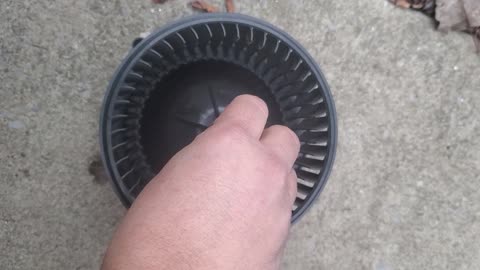

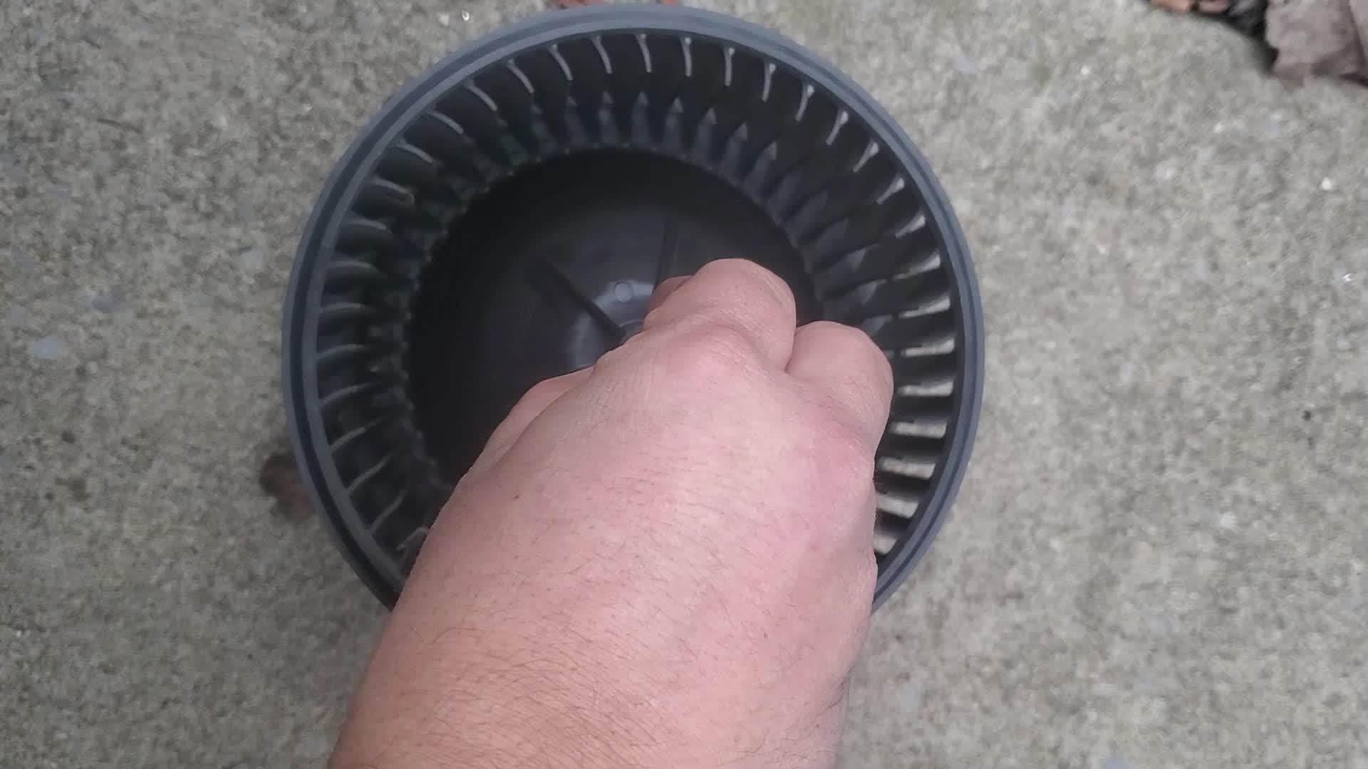

Blower motor seems to spin freely the water issue I found to be the A/C drain was clogged with a bug.

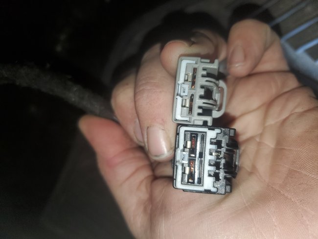

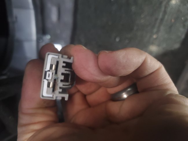

Seems to be no corrosion on the connection here.
Oct 30, 2021 at 7:27 AM
CHAD FLEMING2
  • 6 POSTS
No corrosion on the resister plugs.

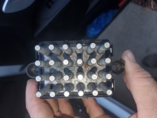

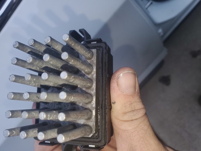

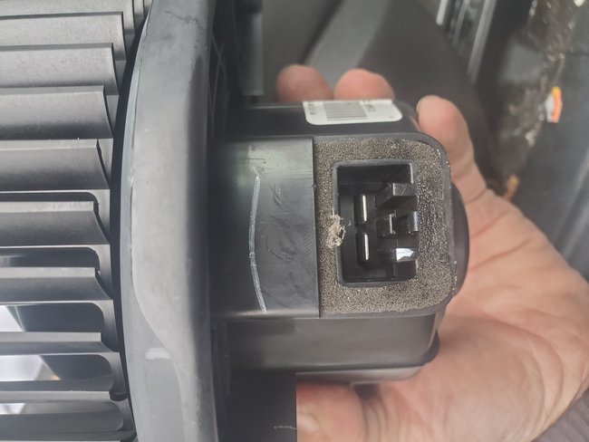

Took this out and it's kind of wet and water around the seal.

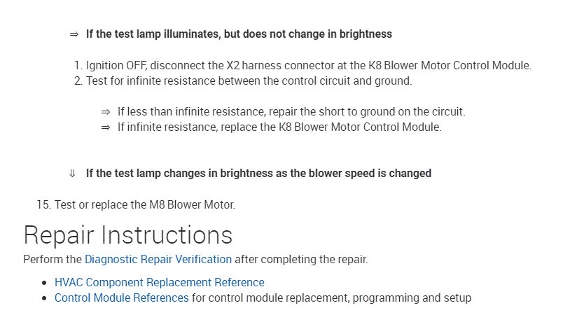

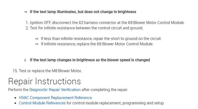

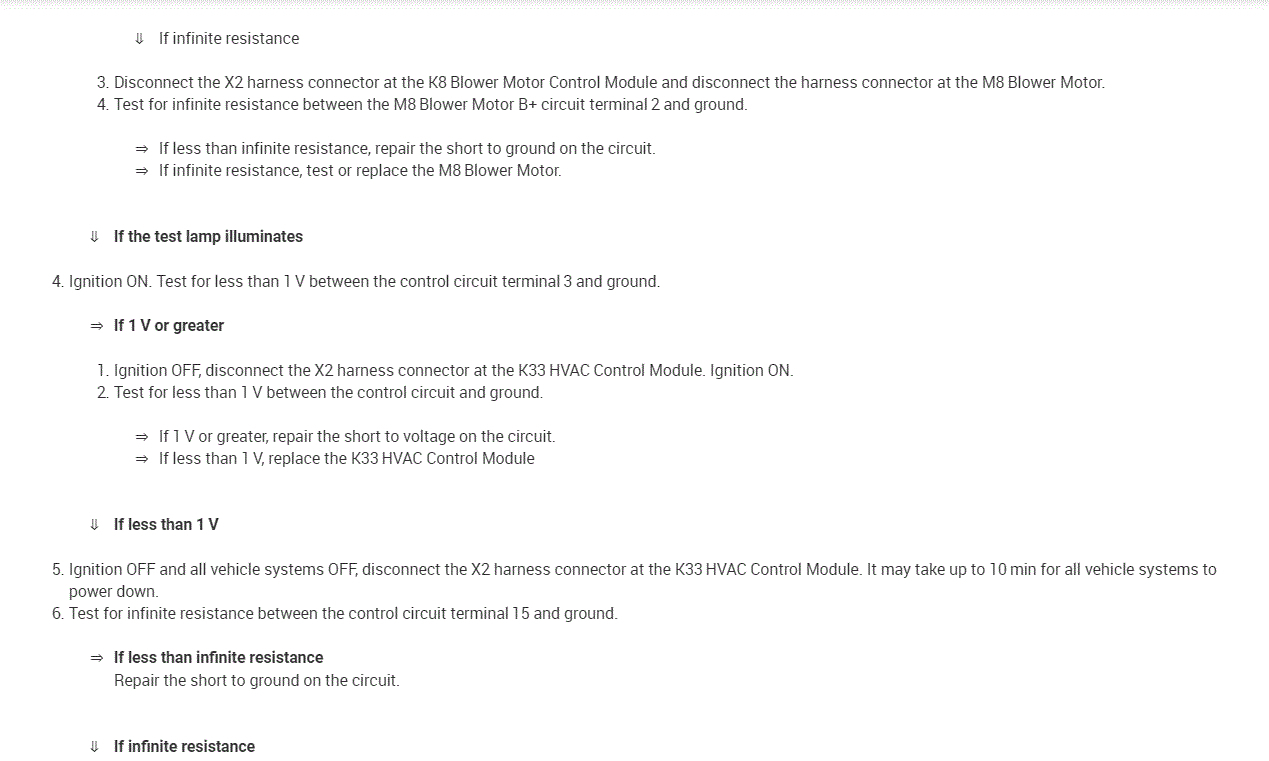

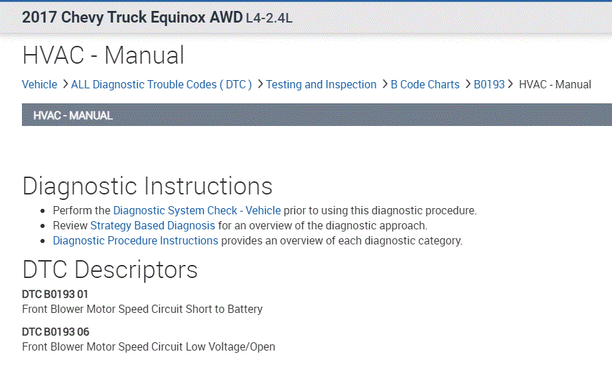

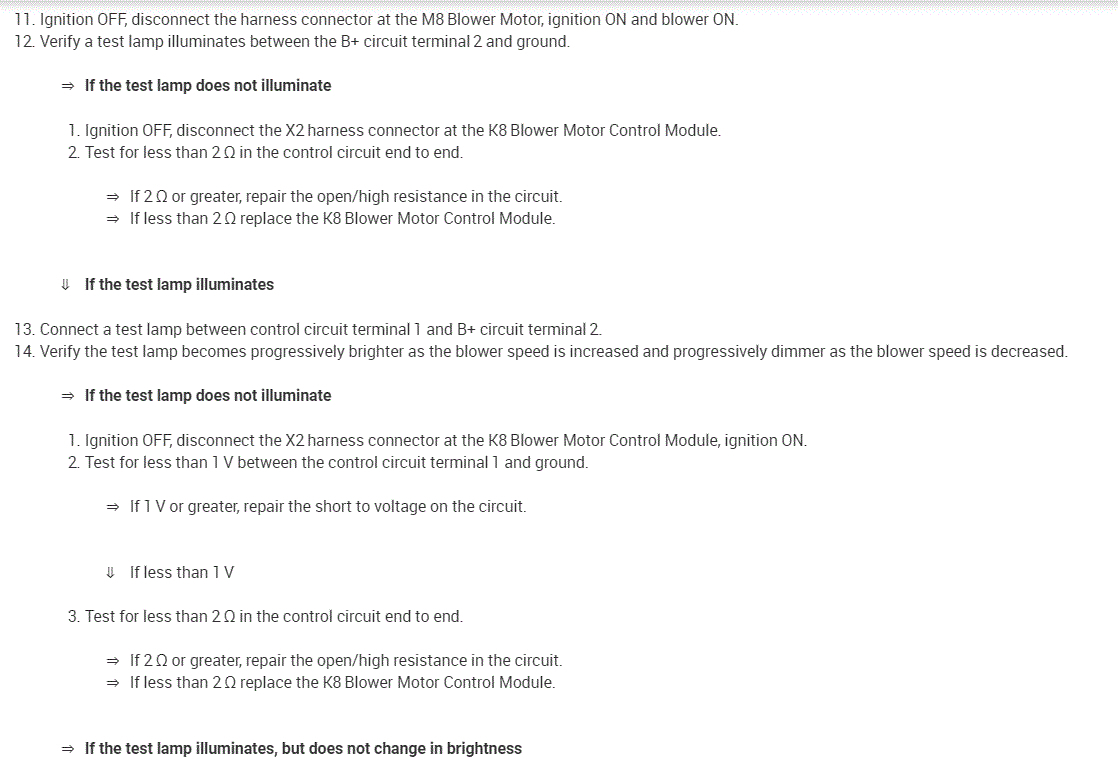

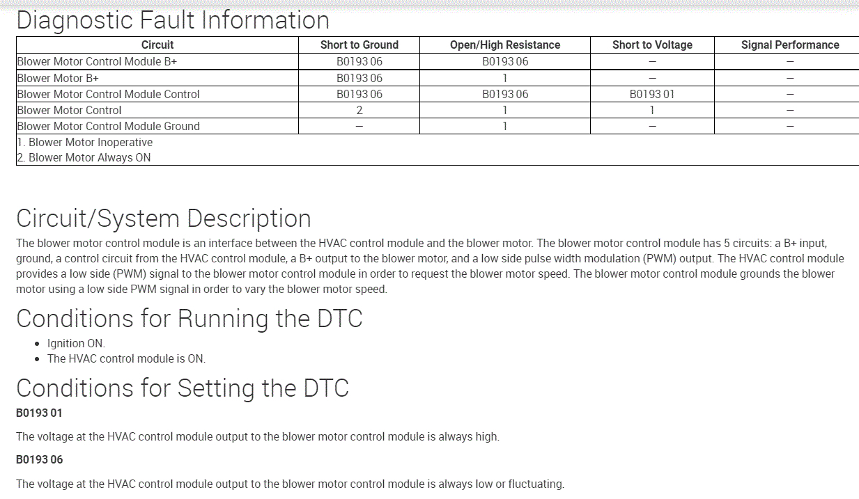

The resister/control module (last pic) shouldn't have been damaged by moisture. Does the fan run at any speed? Also, did you check the fuse I suggested? If you have and it was good and had power, check the red wire at the control module for power.
As far as using a multi-meter, here is a link you may find helpful:

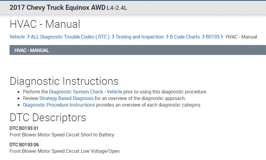

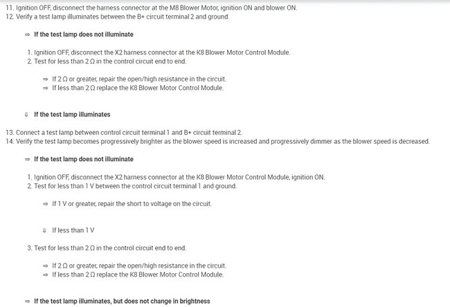

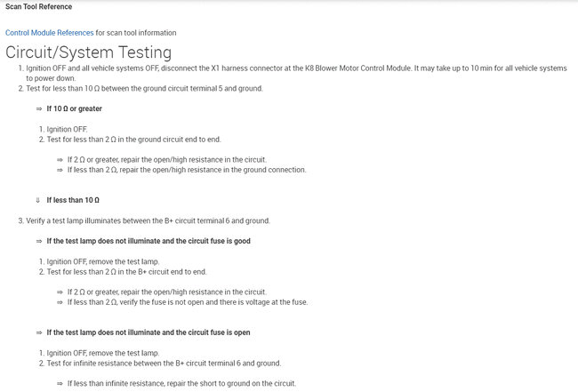

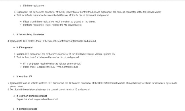

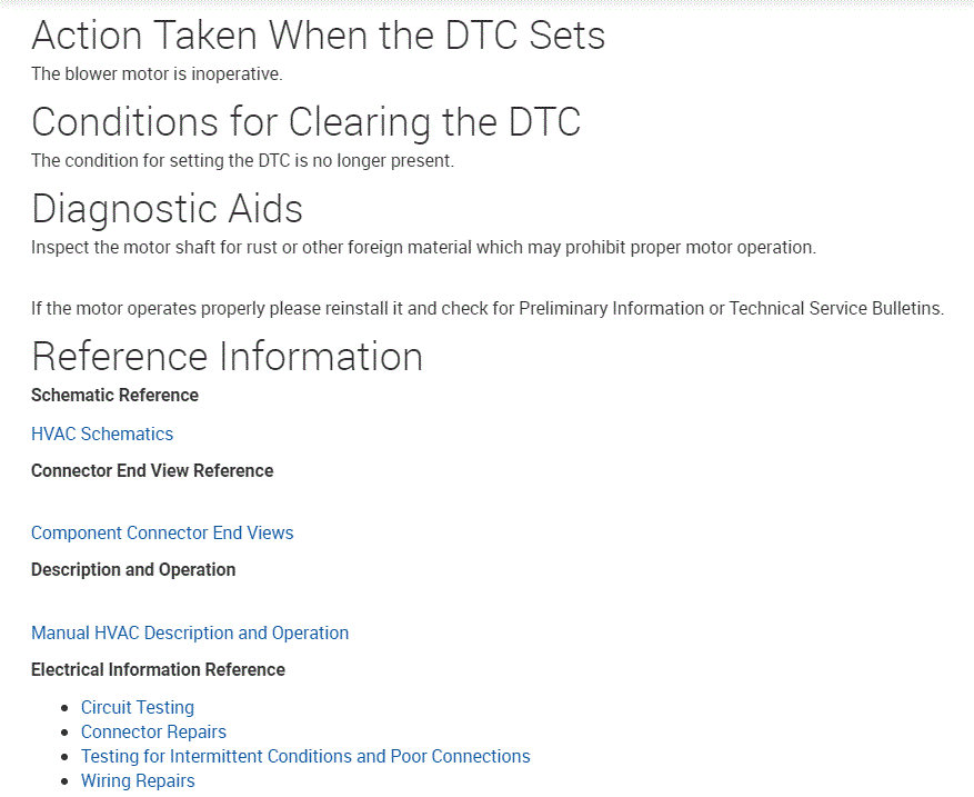

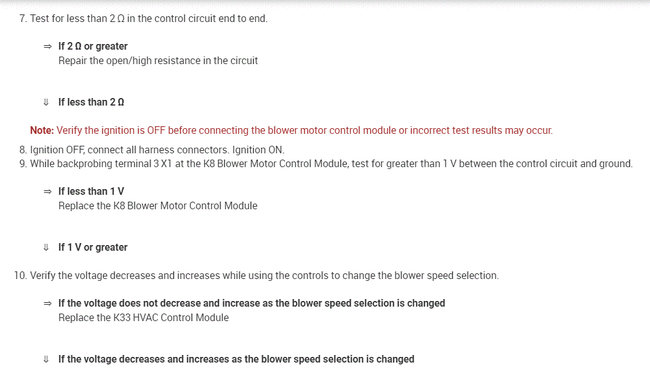

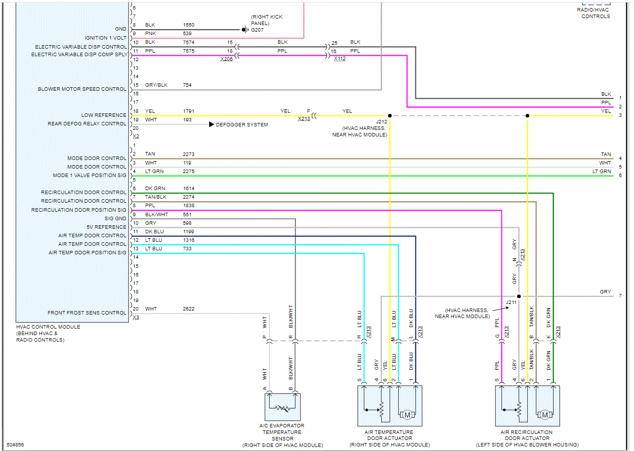

I attached the diagnostics below for testing the circuit.
Let me know what I can do to help.
See pics below. Note: If possible, have the computer scanned for diagnostic trouble codes. If there is an issue within the HVAC control module, it should indicate a code. Also, please let me know if you have questions after reviewing the diagnostics. They are somewhat involved.
