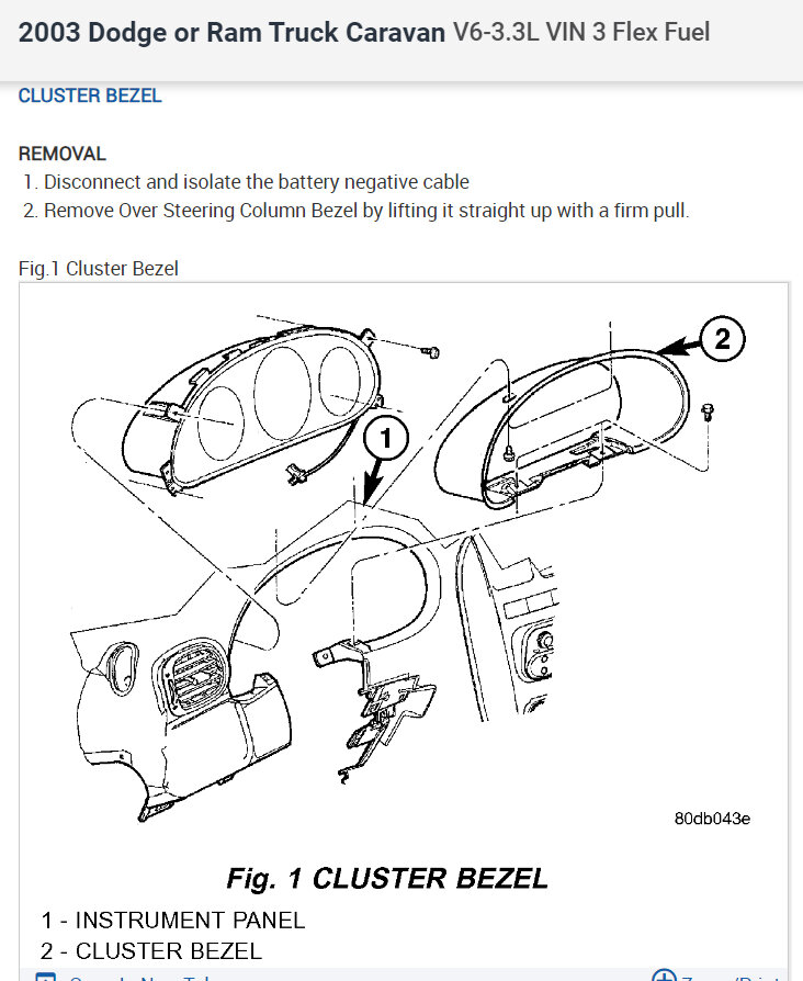

Van is running (warm up) Transmission in park.
Problem
Odometer mileage
This vehicle is adding on mileage as it sits in park going nowhere. It counts the10th just like you are traveling When the count gets to(1)mile the Odometer. mileage adds to the total miles of vehicle travel on the Odometer. I have not done the calculation Time-v-Travel-v-Speed to find out M.P.H

So, the odometer adds mileage when the van is sitting still, correct? The only thing it can be is the cluster, this is where the mileage data is stored. Here is a how to remove the cluster so you can send it in for repair, just search google or eBay for a service close to you. Check out the images (below). Let us know if you need anything else.

First and foremost, thank you for your time/fast reply I'm Mechanically inclined, and a little electronically savvy. Is there any way to test the cluster for the fault and fix it? As I'm on a very fixed income and don't have a lot of money to spend.

One of the microprocessors has gone bad on the cluster board. You might be able to open it up and see if anything is burnt which can give you a clue on what to replace.

(Oddity) I noticed that every time the driver's door opens the odometer lights up on the dash (dash lights turned off) The alt. shows bad Diode(s)and a lot of A/C Voltage into the system as well. I wasn't questioning the suspect cluster failure but more to the overall cause and effect of the other known electronics to be sure the odometer is an isolated problem and not an inclusion of this other problem at hand.

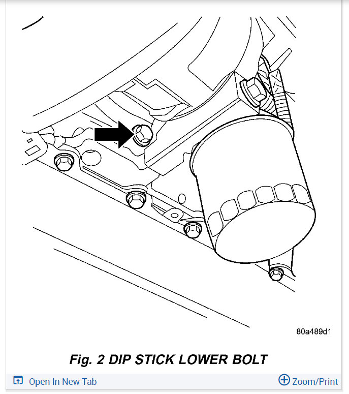

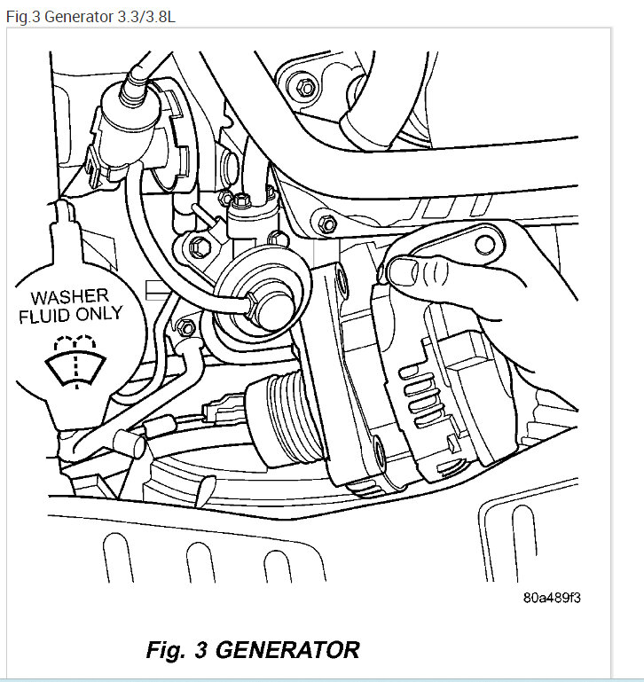

Yep, the alternator throwing AC voltage can be the problem. I would change it out, here are the instructions on how to do so. Check out the images (below). Let us know if you need anything else.

Sorry someone got irritated with my answers i am used to cutting to the chase on things. I'm not trying to be rude, nor am i Mechanically ignorant, i just don't have a lot of electronic aptitude. As for the van, i just wanted to let whom ever came up with (A/C Interference) in the electrical system was totally on the mark including the Odometer marking miles while it sits in the driveway running. You guys do a great job and a render a service matched by none.!!!!!! Thank you for your assist K.Cunningham
