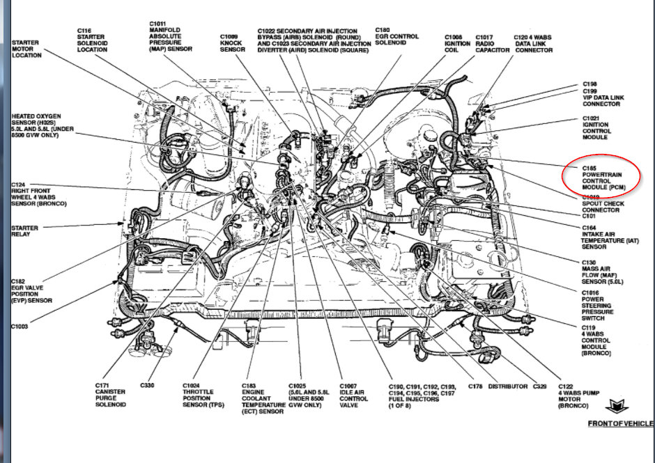

My sons vehicle was running fine until I stopped at a red light. While sitting there at idle it suddenly died. It has spark but no power to the fuel pump. I have already replaced the relays and fuel pump itself. Problem being I cannot find the ECM. It is not near the ICM and PCM in the engine compartment or at the passenger kick panel. where else did they hide them? Or am I completely wrong with my diagnosis?

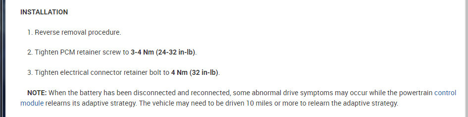

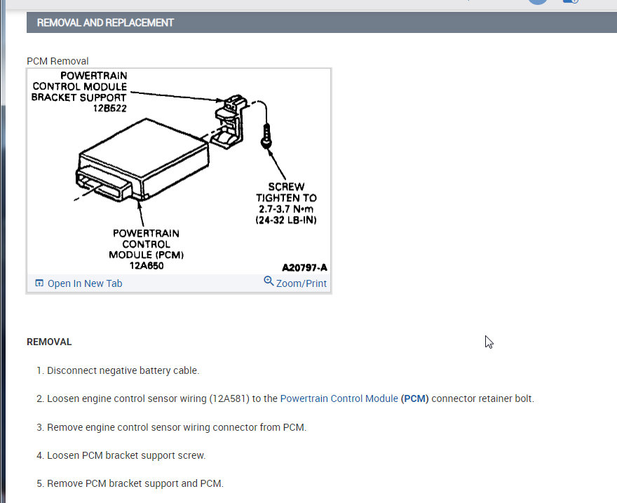

The ECM and PCM are the same thing so I attached the info for the PCM replacement.
As for the issue, it could be the PCM but there are a number of other things that this could be. So here is a guide that will get us started:
