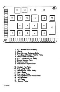

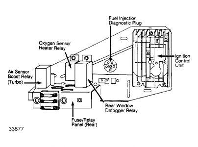

where is ecu relay and whitch one is it they are not marked. 1987porsche 924s
Sep 16, 2007 at 3:24 AM
MERLIN2021
  • 17,250 POSTS
Don't list an ECU for your year and make, these are the 2 relay centers for your year.
