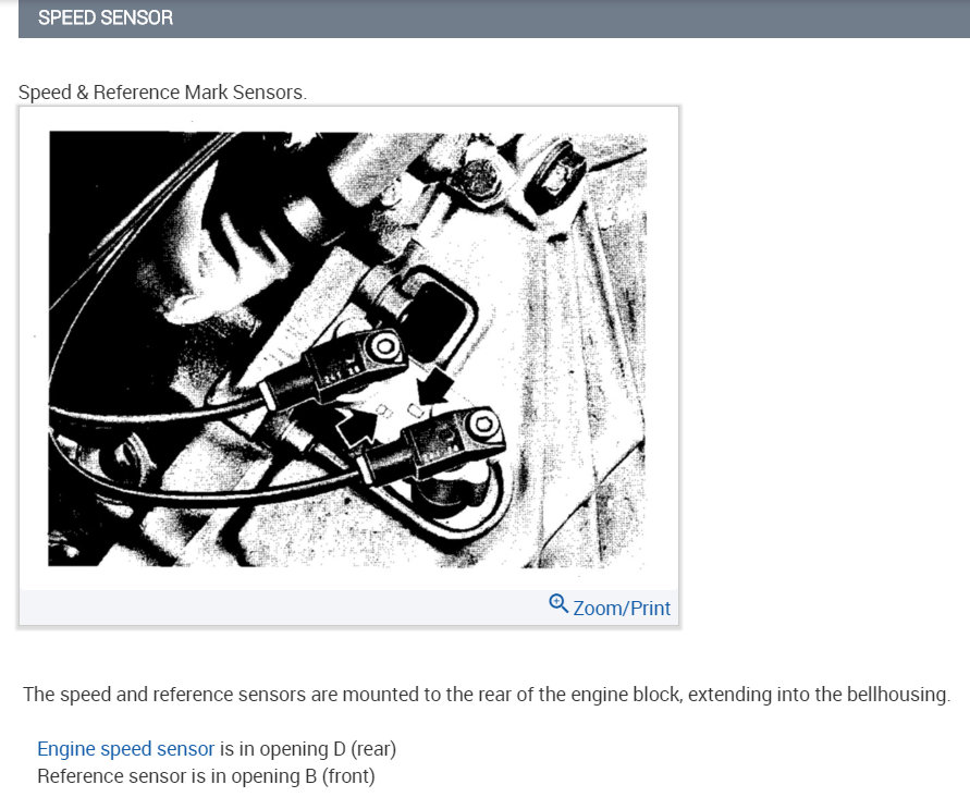

My vehicle will start up fine but as soon as I get out on the road driving it will lose a lot of power and sound like its backfiring. After a few seconds it will surge forward like it got all of its power back. This happens anytime I want to accelerate unless I floor it. Also when it is running at road speed it seems to run a little rough and it lacks power anytime I have to go up a hill. I've already replaced the fuel filter, fuel pressure regulator, and fuel pump. However with the fuel pump when I replaced it it was with a Warblo High Performance pump and all it did was buck so I put the old one back it and it stopped bucking but the old problem was still there.

These car had issues with the crankshaft angle sensors going out here is a guide to show you what you are in for when doing the job and a diagrams below to show you the location on your car.
Check out the diagrams (Below). Please let us know what you find. We are interested to see what it is.

Yep this what the problem with my car it cost me $87.00 for the sensors all fixed !
