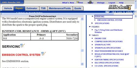

i connected my test meter after disconnecting the battery and all wires from the coil. meter set to ohms, when connected to the side terminals of the coil i read .8 ohms. when i use 1 side terminal and the high output, center terminal i only get 6.9. your test method says i should read 10,000-11,000. am i supposed to re-connect the battery before this test?

Turn ignition OFF and zero the meter Read the primary by probing the coil positive and negative terminl should read .4-.6 of an 1ohm Secondary probe the negative side of the coil and center tower of coil should read 5K-7200K ohms Note: If any is out of range -replace the coil Specs

ok, ty! turn ignition OFF, leave battery connected.
