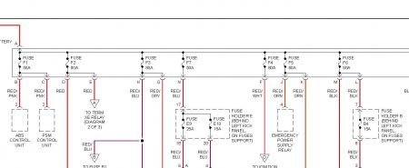

Went to start my Porsche and I have no power. Checked battery and it seems fine. No lights, no power to anything.
Jul 18, 2010 at 5:31 AM
  • 75,992 POSTS
Test the positive battery red cable all the way to the power/current power distribution box. If this wire is open nothing is gonna come on -could also be a main ground issue double check battery condition and connections also see below
