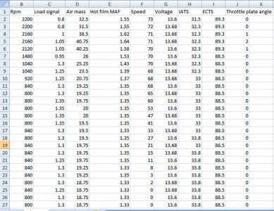

EGR Valve was replaced 1 year ago. It went bad just after I bought the car and threw a CEL. On inspection it seems fine and is not throwing any CELs. Idle Air Control Valve was what I believed to be the culprit. I started by cleaning it, but when that didn't help, I replaced it. Didn't make a bit of difference. Throttle Position Sensor tested good, but just to be safe, I replaced it as well. Didn't make a bit of difference. I have no idea where to find the Idle Speed Actuator or the Idle Stop Solenoid. They don't show up in my manuals. Here's a chart of some real-time values I recorded while driving home tonight. When the throttle position is at 0, I was clutching and letting the car coast.

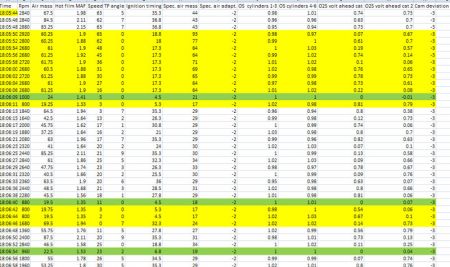

By comparison, here's another reading I took after the car began functioning normally again.
https://images.2carpros.com/forum/automotive_pictures/300836_regularidle_1.jpg
I can only record 8 fields at a time, so tomorrow I'm going to take more reading but track the 02 sensors, etc. Any ideas?

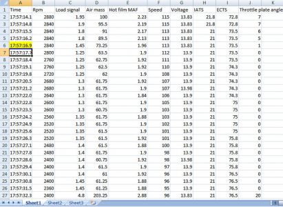

https://images.2carpros.com/forum/automotive_pictures/300836_test01_1.jpg
Here's some readings from the drive home last night. I pulled the screen showing the last time the RPMs hung while clutching and the first time it started behaving normal. I noticed that when the car is behaving correctly, anytime I hit the clutch, the 02 sensor voltage will momentarily drop to 0, at which time the engine rpms drop to 800. When the car is not behaving correctly, the 02 voltage never goes to zero unless the car coasts to under 10 mph. Is there a sensor or switch that causes this blip to 0 in the O2 voltage that I need to check?
