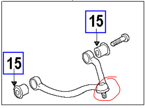

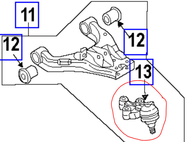

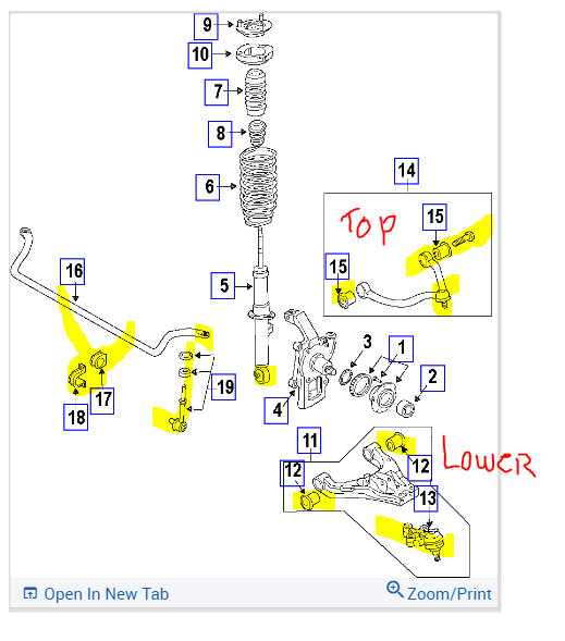

Additionally, I attached an exploded view of the front suspension. Safely lift one front wheel off the ground and inspect the parts I highlighted for damage, excessive play, or something broken. Also, if there is a problem with one of the ball joints (excessive play pics 2 and 3), stop driving the vehicle until a repair can be made. All other components are less likely to cause total failure, but all can.
Let me know what you find or if you have questions.
joe
See pics below. Note: Pic 2 is the upper control arm and pic 3 is the lower control arm.
