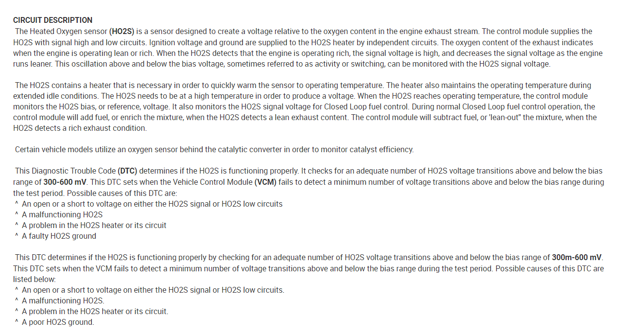

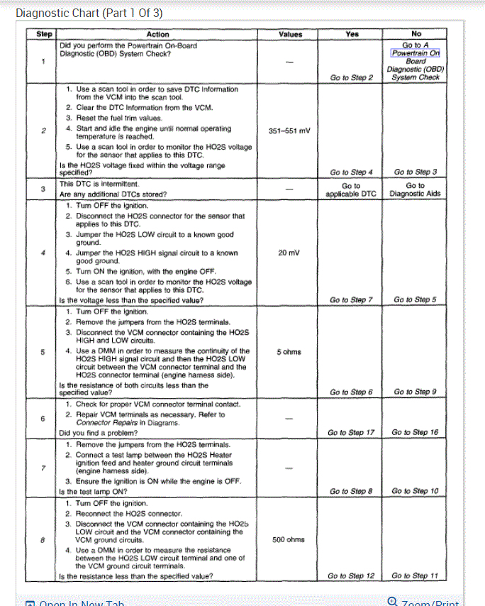

STEVE BLACK

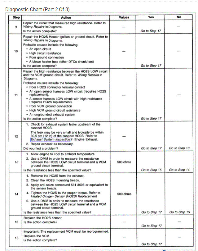

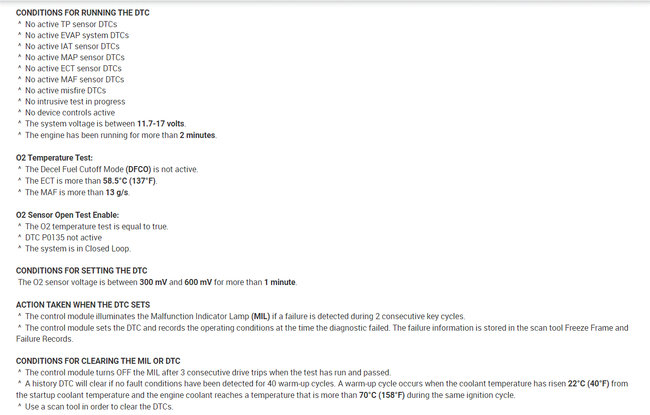

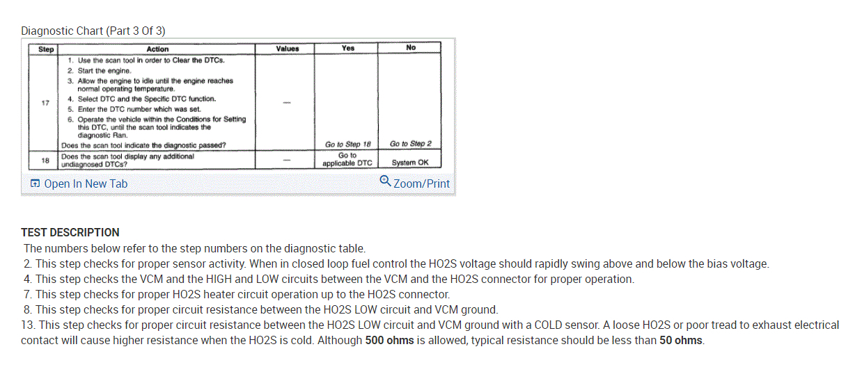

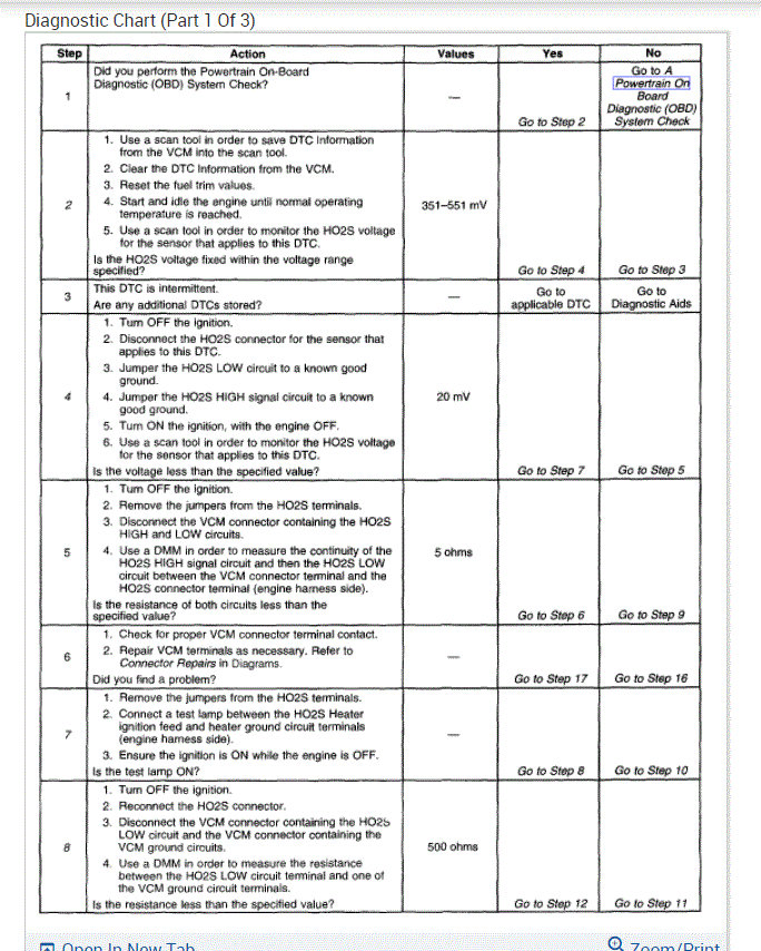

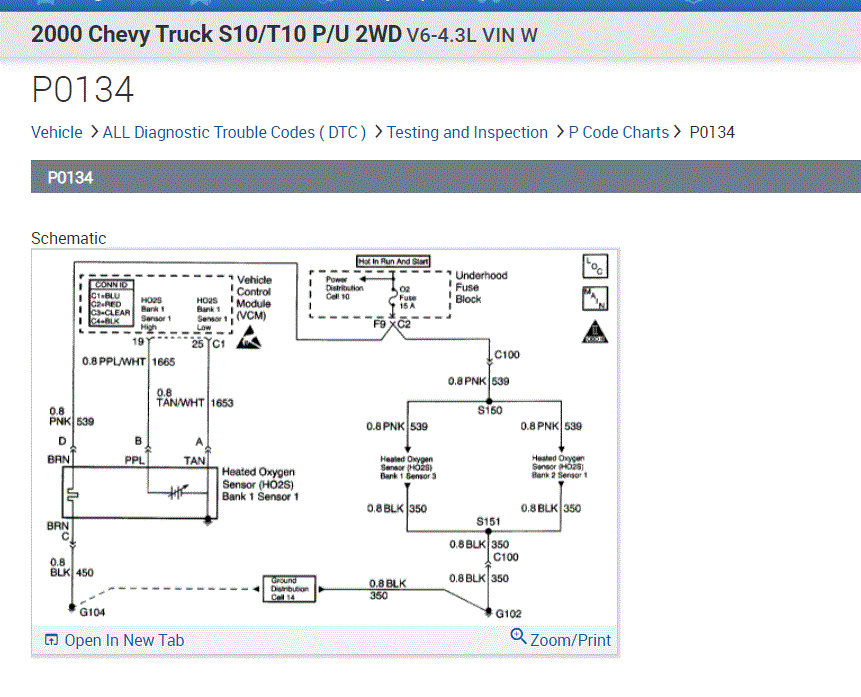

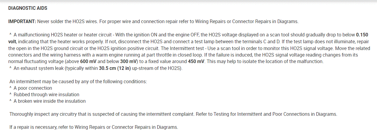

I forget to plug the receptacle to back of distributor. Now I'm getting a PO134 Code Bank 1 Sensor 1 No activity detected. Checked the connection and it's soiled. Both upstream oxygen sensors are new.
May 23, 2021 at 7:55 AM
  • 110,244 POSTS
When you say the connections are dirty, are they corroded, damaged, or broken? Also, inspect the wiring to the sensor. Because of its location, the wire and insulation on the wire could be damaged.
I attached the information about the code and the diagnostics below. Take a look through them and hopefully, it will help.
