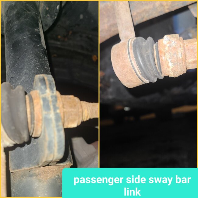

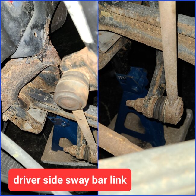

the driver side sway bar link is perfectly straight but the passenger side sway bar link is slanted. i suspect this is an issue? what do you think?

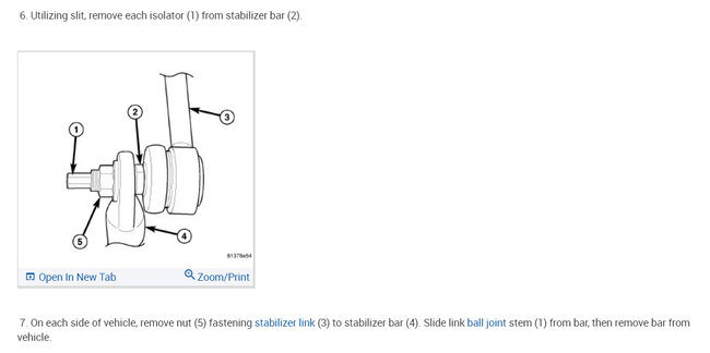

It could be a sway bar link, but to be sure disconnect one side and drive it to see if the noise is gone, this way you can tell for sure. I think you may have a strut that is going out. Can you please shoot a quick video with your phone so I can hear the noise? That way I can tell for sure what's going on. You can upload it here with your response. Here are the instructions on how to replace the sway bar links in case you need it. Check out the images (below). Please let us know what you find. We are interested to see what it is.

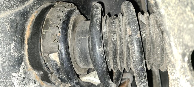

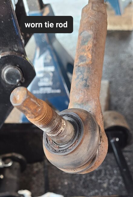

The tie rods: 1 outer tie rod. passenger side boot is damaged, torn and pulling away from the actual stud. bought the replacement part will be installing that tomorrow.

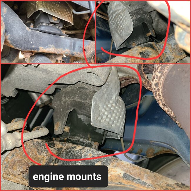

Engine Mounts. another area known for popping while driving. after a visual inspection they look slanted and not straight up. They have a heat shield sleeve wrapped around the majority of it so it's difficult to find any cracks. i am going to rule them out tonight by placing a flat head screwdriver on it while the engine is running to check vibrations. these could have been damaged when the engine cradle fell violently.

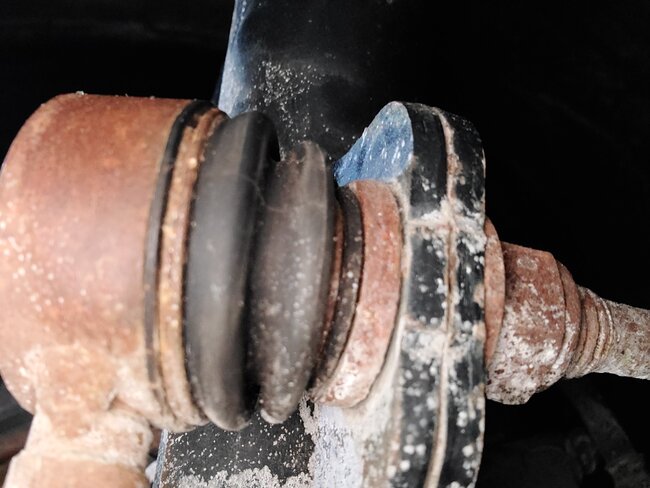

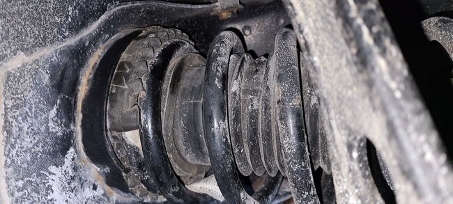

pics those mounts dont look right at all. yikes
Nov 23, 2022 at 8:25 AM
LEMONCAR
  • 36 POSTS

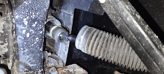

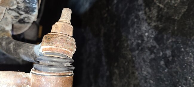

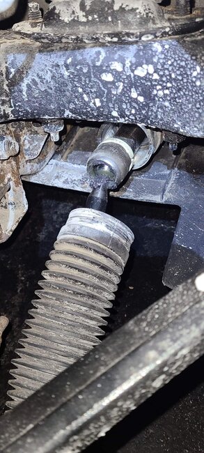

strut top mount looks damaged and that's a better picture of the sway bar boots. in my attempt to change the outer tie rod i noticed that the inner tie rod might be broken. i am getting a lot of play so i will pull the boot and inspect that inner tie rod.
Nov 23, 2022 at 10:51 AM
  • 55,658 POSTS
Thanks for the images and video. When you move the inner tie rod does it have play if you move it in or out? We need to get closer to where the noise is coming from. Please do a test drive with a passenger to help narrow down the location of the noise generation.

Yes, the inner tie rod had a lot of play and was loose so i went ahead and replaced it.

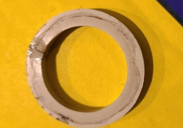

when i took the old tie rod off i noticed the travel limiter (plastic washer) thing was split.
i tried super glue, failed! when i went to tighten the new rod on, the plastic limiter thingy split open again.
Nov 27, 2022 at 1:56 PM
  • 55,658 POSTS
I think that is the way it is supposed to be but I'm not sure. I don't think it will hurt anything. Did that fix the noise?

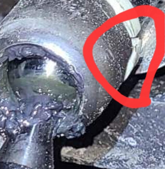

I made a copy of one of your pics from above. I circled two areas with white. What am I looking at in those locations? Being from PA, I'm used to seeing rust issues and want to confirm that this isn't the case.
Let us know.

popping solved, it turns out that both Engine Mounts are needing replacement, they must have got severely damaged/ bent when the engine cradle fell causing everything to be yanked. i ended up doing the Hard-Brake test to determine if the engine mounts were giving me the issue...sure enough the test showed how bad the mounts really are. Thank you all for the assistance. much appreciated.
