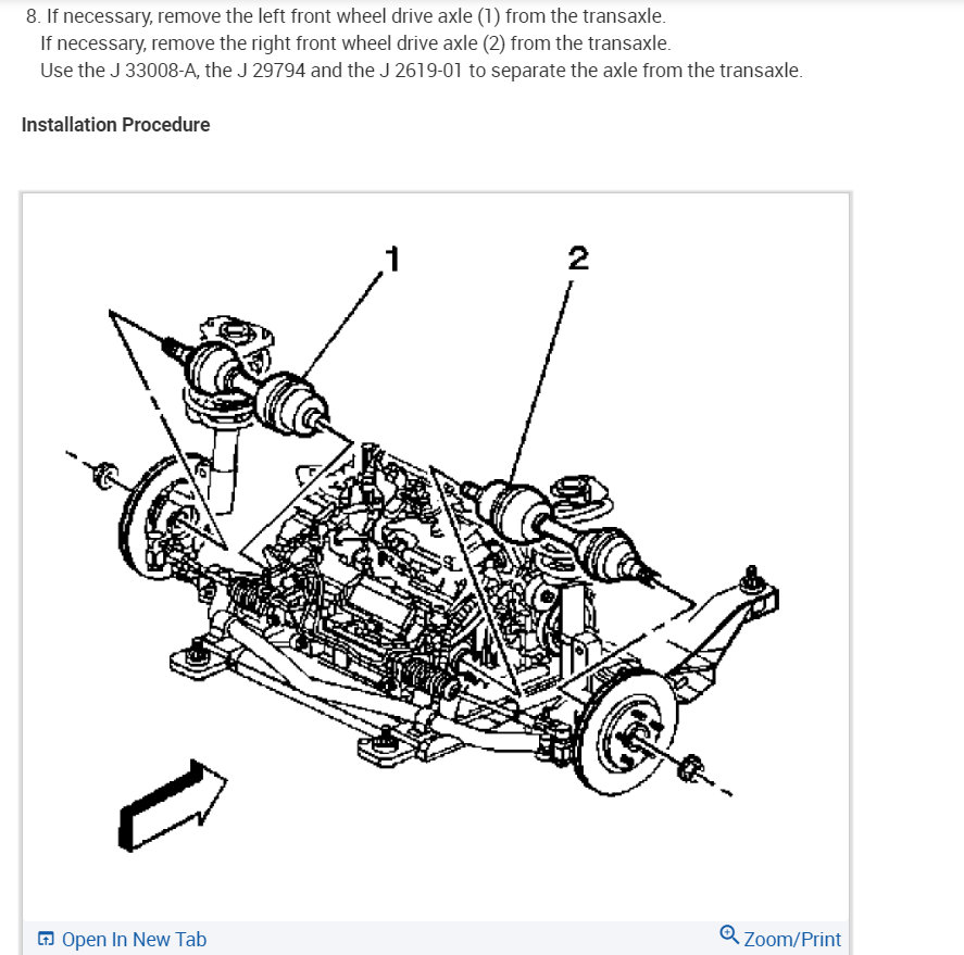

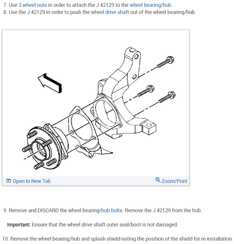

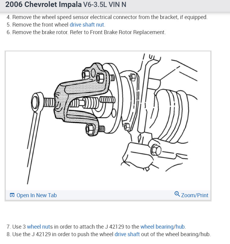

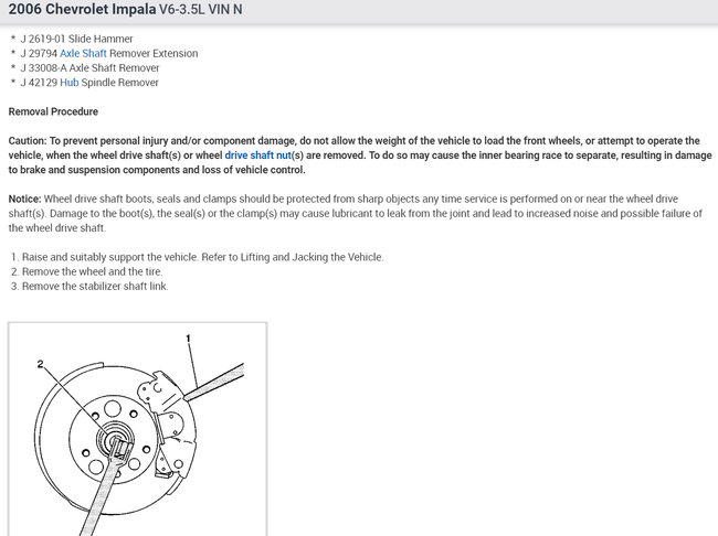

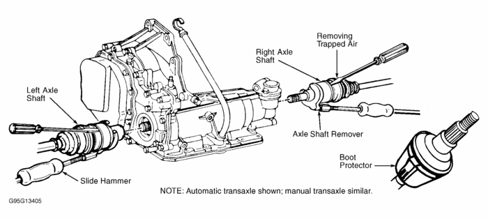

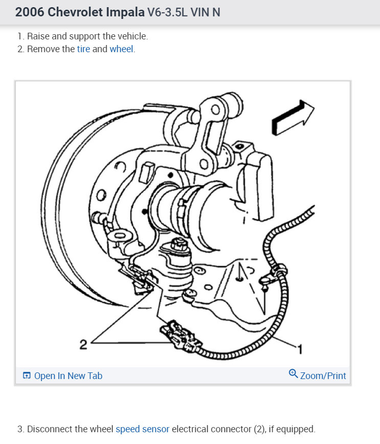

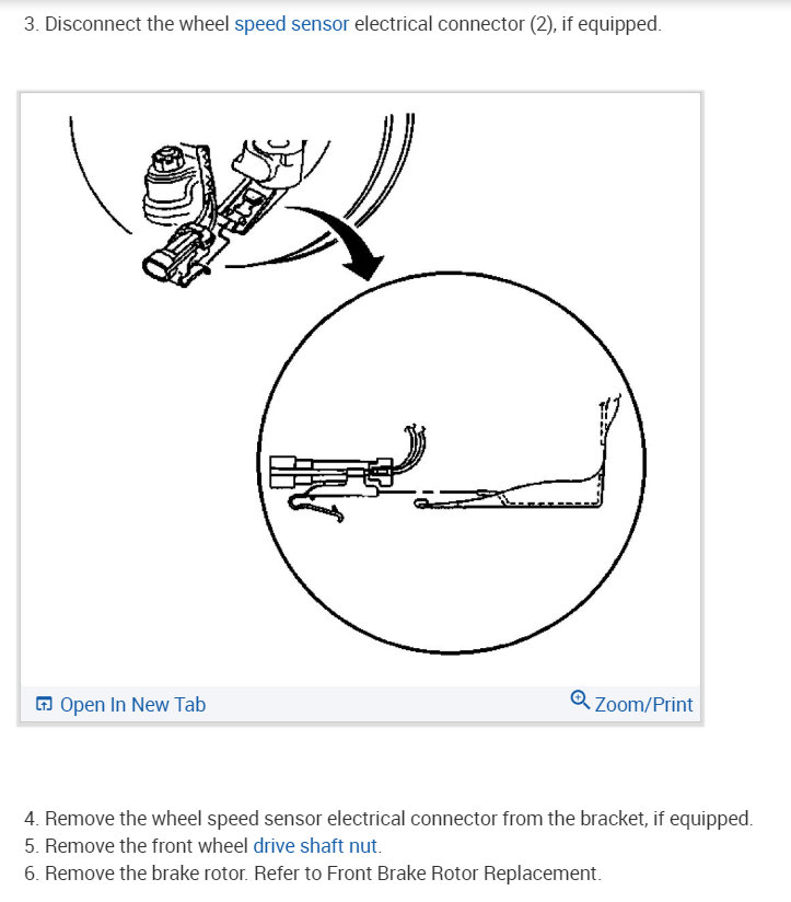

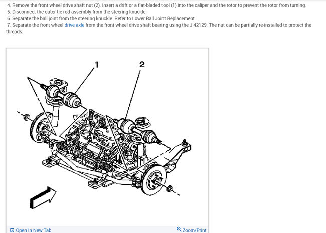

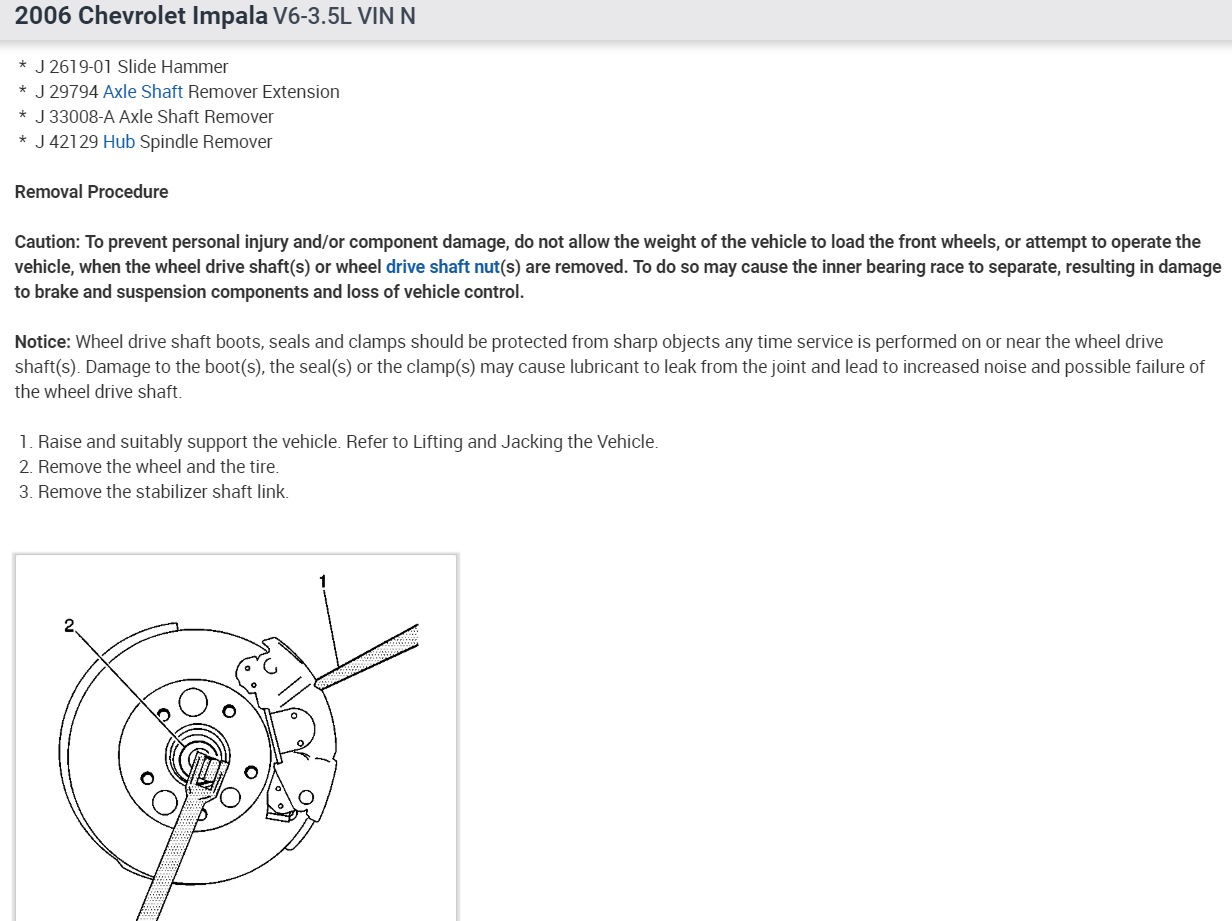

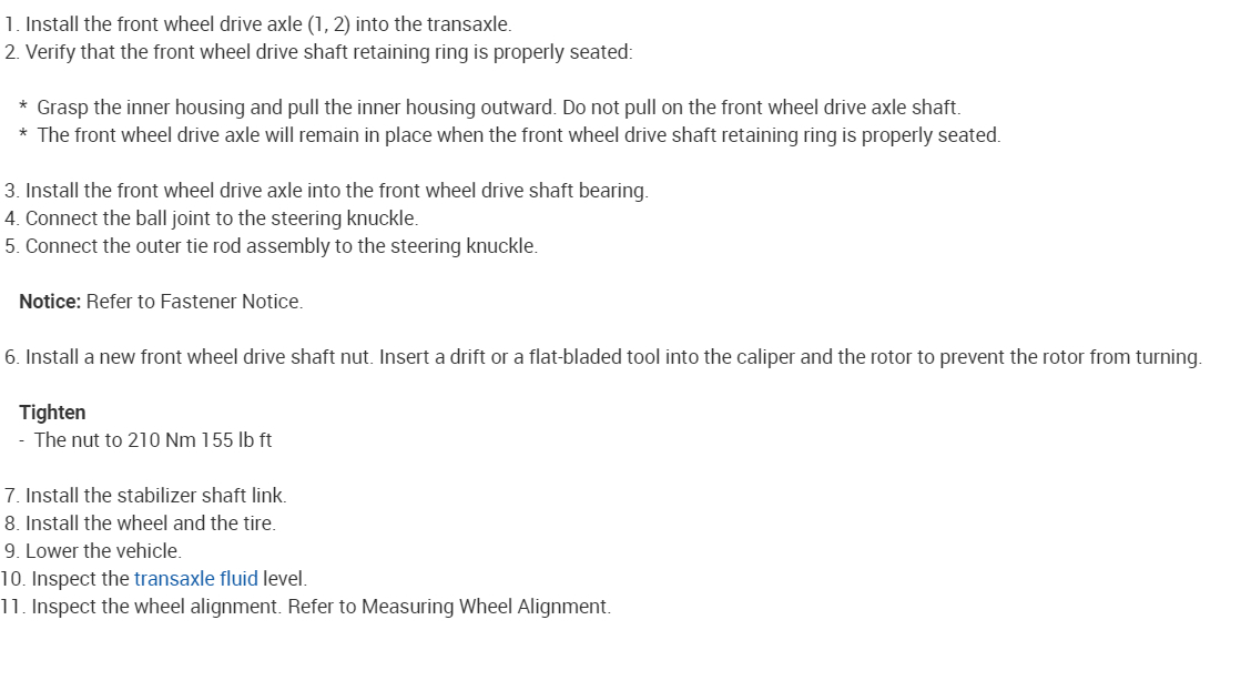

This sounds like you have a bearing hub going out and/or the CV axles need to be replaced. Here are instructions in the diagrams below to help you see how to change them out. Here are two guides to help walk you through the repair with diagrams below for you car.
https://www.2carpros.com/articles/replace-cv-axle
and
https://www.2carpros.com/articles/bearing-hub-replacement
Can you please shoot a quick video with your phone so we can hear the noise? that would be great. You can upload it here with your response. Check out the diagrams (Below). Please let us know what you find. We are interested to see what it is.

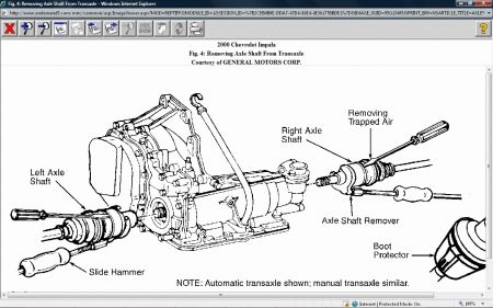

How do you remove the inner CV joint from the trans axle?
Sep 3, 2019 at 8:59 AM (Merged)
MERLIN2021
  • 17,250 POSTS
They have a cup attachment for slide hammers for this job, or I used to use two long prybars and pop it out.

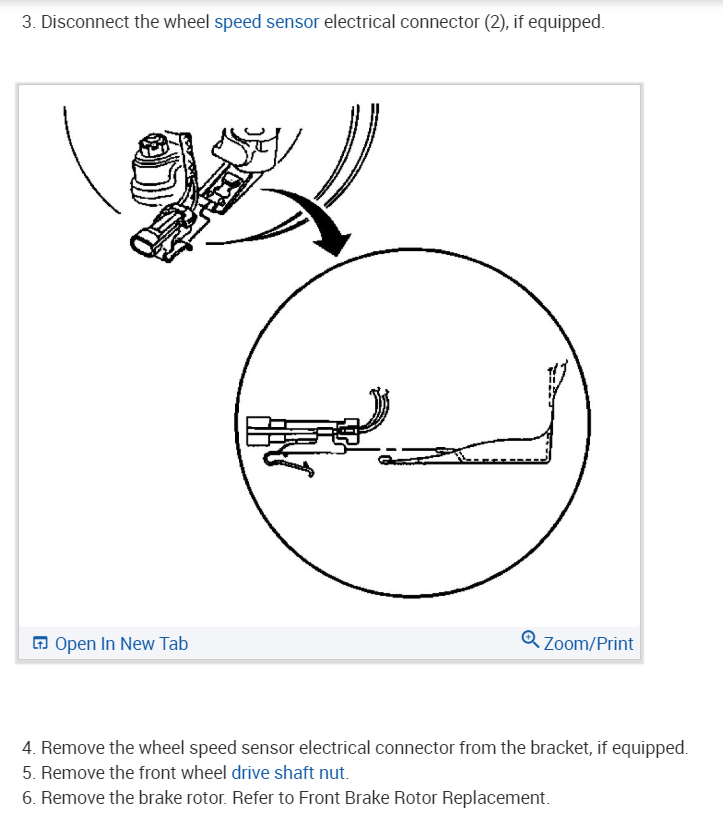

BMRFIXIT
  • 19,053 POSTS
Raise and support vehicle. Remove wheel. Disconnect ABS wheel speed sensor, and remove harness from clips. Remove stabilizer shaft link. Insert drift into caliper and rotor (to prevent it from turning), and remove axle shaft nut and washer.
It is unnecessary to remove suspension components for Lumina model. Go to step 3. Disconnect outer tie rod from steering knuckle by removing nut, loosening jam (adjuster) nut, and pulling tie rod with Universal Steering Linkage Puller (J-24319-B). Remove cotter pin from lower control arm-to-knuckle ball stud nut. Loosen nut. Install Ball Joint/Stud Separator (J-41820), separate ball stud from knuckle, and remove ball stud nut.
Separate axle shaft from axle shaft bearing using Hub Spindle Remover (J-42129). Nut can be partially reinstalled to protect threads.
For right-side of Intrigue, top and front transaxle brace bolts must be removed for tool access. Remove axle shaft from transaxle using Axle Shaft Remover (J-33008-A), Axle Shaft Remover Extension (J-29794) and Slide Hammer (J-2619-01).
