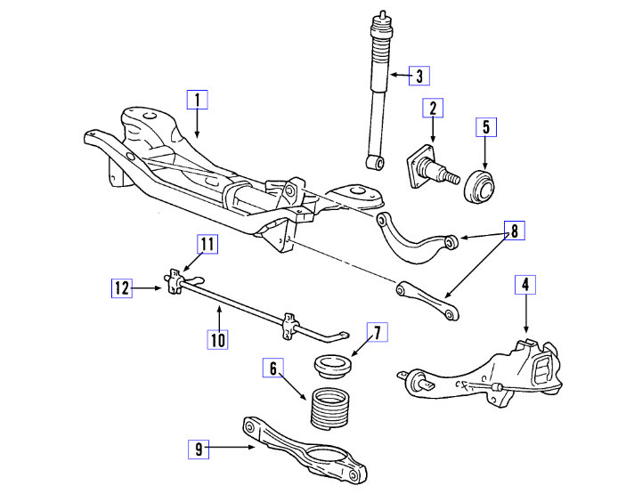

The pop almost sounds like exhaust. Drivers side and passenger side, behind the seats, next to the car frame. It can happen anytime, even sitting still. Loud like a rubber mallet hitting metal. Never happens left and right at the same time. Scary. Sometimes it doesn't happen at all. Driving around town. Too afraid to freeway drive. Help!!

Is the sound loud enough for you to record and upload for me to hear? Also, is there anything you do that seems to prompt it to happen? For example, if you apply the brakes or hit a bump, does it happen? I realize you indicated it happens even sitting still, which is really interesting.
I attached an exploded view of the rear suspension parts of this vehicle. Most of the parts there are mounted via rubber bushings. If one has collapsed or broken apart, it can cause a noise. Also, a broken coil spring can also cause the sound.
The idea that you mentioned the exhaust is also a possibility. If you move the tailpipe around, does it feel loose? If you move it, can you reproduce the sound?
See pic below.

Thank you, Joe. I would not be able to record the noise. It is too unpredictable. If you can think of a large rubber mallet hitting the undercarriage with a single thump, or bang that's the closest description I can come up with. I will check the exhaust pipe today. As far as prompts that cause the thump, there seems to be no explanation, not turning, going over bumps, or braking, Acceleration or letting up on the gas pedal does not seem to cause the problem. Do you think it is safe to drive locally while trying to figure out what to do? Thanks for your time and help. Robin

I would suggest checking the rear components I mentioned. As far as it being safe, that is really hard for me to answer without knowing what is wrong. I'm sorry I can't give you a concrete answer.
The idea that it is that loud makes me think there is a bushing that is bad, and something is moving. The only thing is you indicate it happens when it is sitting still. That takes me back to the exhaust hitting.
If you aren't comfortable checking the things I mentioned, you really should have it checked at a shop where they can lift the vehicle and inspect things.
