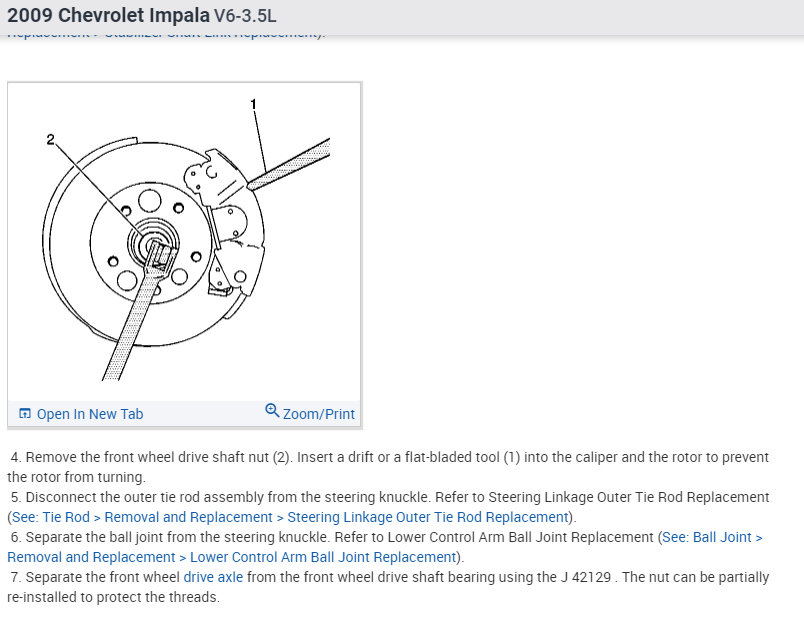

The clicking noise is likely due to a bad CV axle.
Typically, when the boot rips apart of the CV joint it allows dirt and debris to enter the joint and that will eventually lead to the noise.
Take a look at this helpful guide:
https://www.2carpros.com/articles/clicking-sound
As for the noise while pressing the gas pedal, can you upload a video? It can help us determine what this might be.

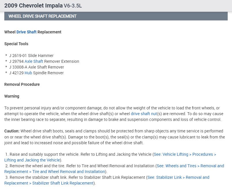

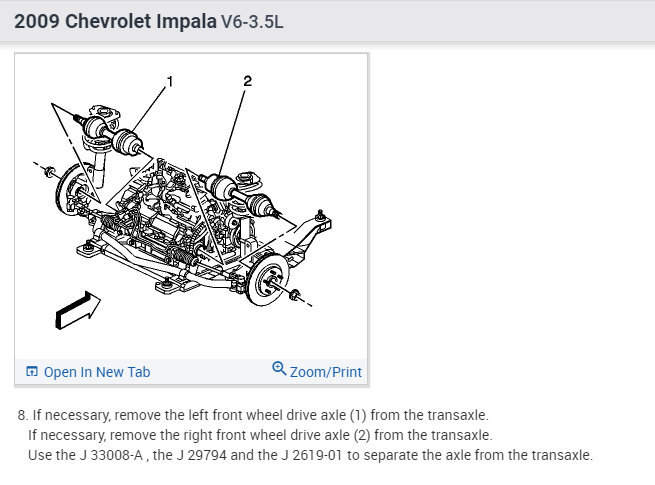

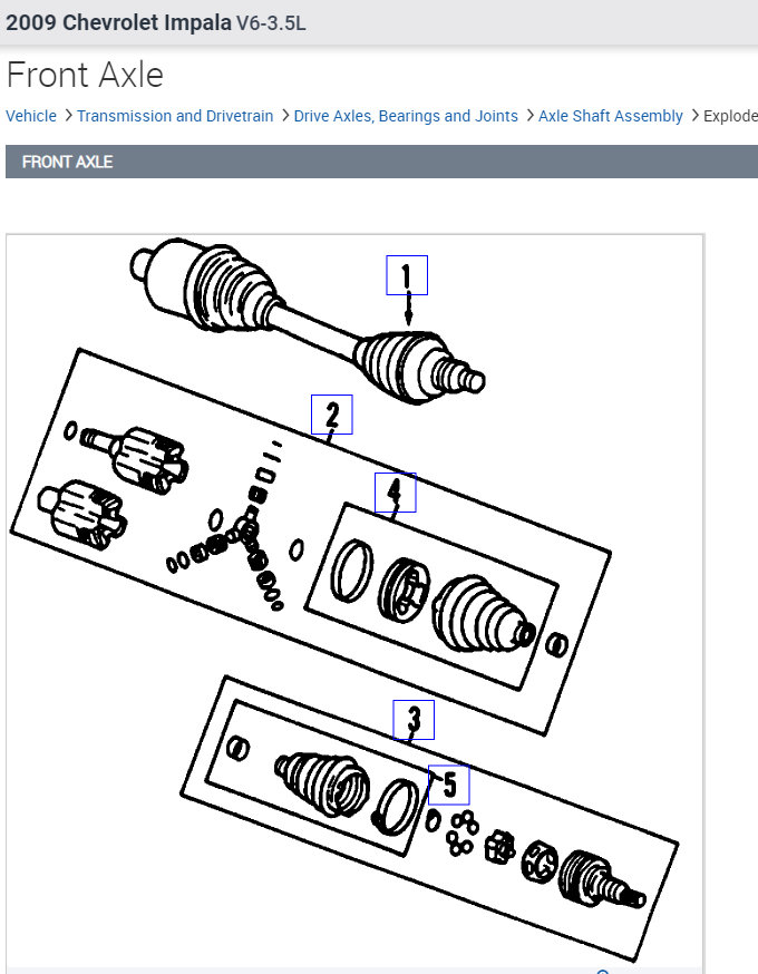

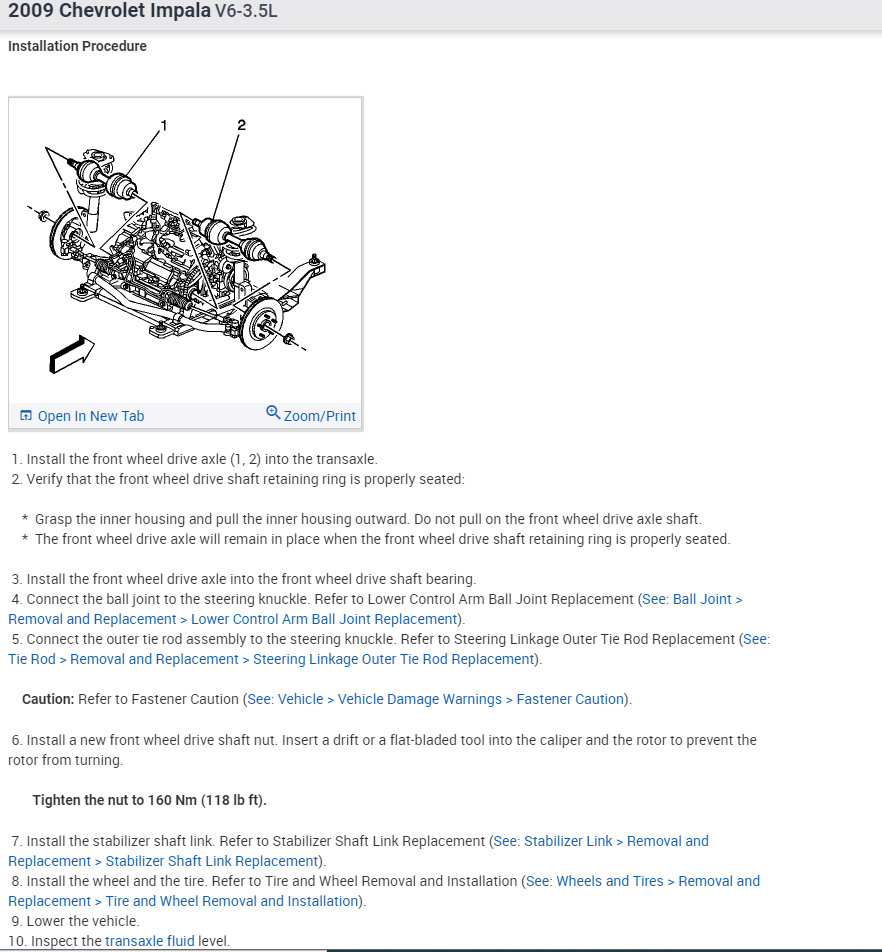

I have attached the CV axle replacement procedure below for your reference.
Let me know of any questions.
