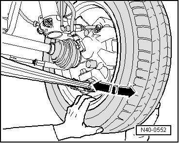

Checked wheel bearing, no slack, sway bars links not broke, ball joints look fine, but with tire off both hands on bottom of rotor I can pick up on it and push it up and here strut flex or something. what could it be? can’t do it on other side it’s tight could it be strut.

Are you sure the coil on the strut assembly isn't broken? How far can you move it upward? Do you see movement on any of the suspension or steering components?

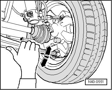

Up and down play is usually the result of a wheel bearing or ball joint, but you said they are good. Do me a favor. Reinstall the wheel and check the ball joints according to these directions and let me know the results. The two attached pictures correlate with these directions. Also, make sure the axle nut is tight and the play isn't in the strut plate at the top of the strut.

Picture 1
- Forcefully pull control arm down in direction of - arrow - and press up again.
Radial Clearance, Checking
Picture 2
- Forcefully push lower part of wheel inward and outward in direction of - arrow -.
There should not be any noticeable or visible "play" in either of the two checks.
Observe lower ball joint while performing checks.
Make allowance for any wheel bearing play or "play" in strut mounting at top.
Check rubber boot for damage, replace lower ball joint, if necessary.
Let me know what you find.

I have not checked it the way you said to, but with wheel on I checked to see if there was slack or anything with wheel bearing and there was none. ball joint looked fine, but when I push up you could here the strut going in and out coil is not broken.

Honestly, it's difficult for me to be sure from here. I would recommend checking the ball joints the way they are to be tested. As far as the wheel bearing, this vehicle doesn't have a traditional hub bearing. The bearing is pressed in. You may not be feeling the play. However, if you heard a pop sound, to me it sounds ball joint related.

No slack and it does have a hub assembly. so I’m rule it’s strut assembly.

You know, I was thinking golf because I just had to press the bearing out then in. I can't even remember the year. Anyway, if there are no ball joint issues, bushings, bearing, steering components, the strut is the only thing left.
