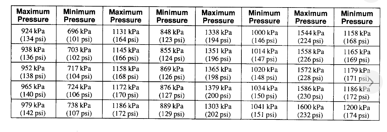

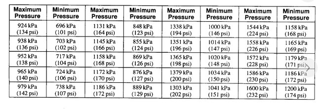

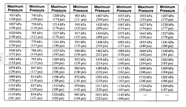

The first thing I would recommend would be a compression test. Compression tests are the best tests for telling you the health of your engine's internal health. Here is a link for you to go to explaining how to do this:
In the diagrams down below I have included the charts for the minimum and maximum acceptable P.S.I. reading in the cylinders, but as a general rule the lowest cylinder must be at least 75% of the highest cylinder for that cylinder to be good. Please get back to us with what you find out.
Thanks,
Alex

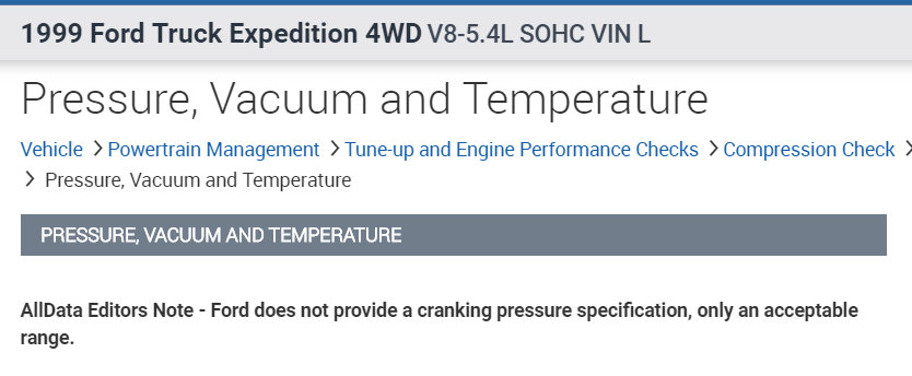

This guide can help as well:
