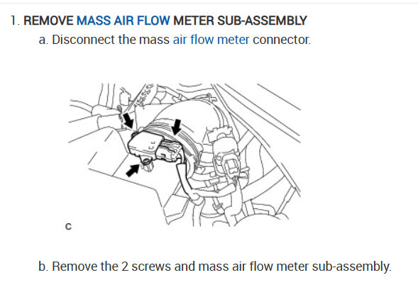

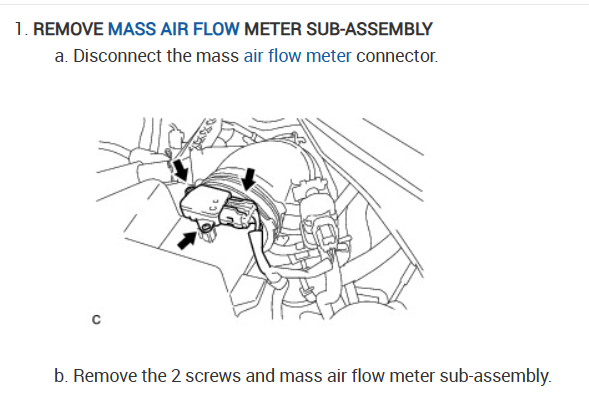

Nice work taking care of your mother :) I don't know good techs were your live but you can do a google search to try to find a good one, the MAF sensor is easy to replace and would be the #1 thing I would do to help the milage. You can get one from Amazon for 109.00 OEM
https://amzn.to/3MbeH3V
Here is the location of the sensor which I will email yo as well. Let us know how it goes.
Nov 19, 2025 at 1:54 AM

Yep, good data helps, I think you can change out the MAF yourself, it is pretty easy, make sure the engine is cold before repair. Let me know if you have an issue.
