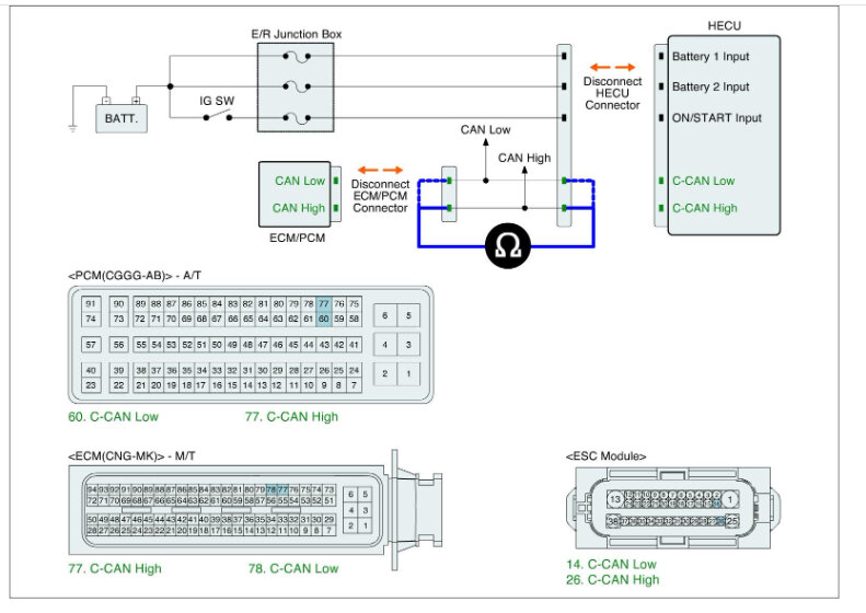

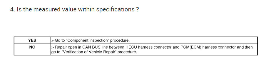

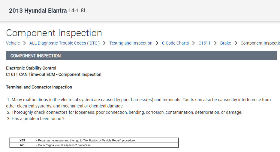

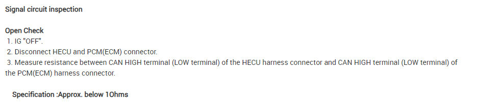

As far as the code is concerned, I attached the diagnostics below for you. That seems to be directly related to the ABS issue.
As far as the engine is concerned, it's odd that both seem delayed. Does it still seem to not get power until the RPM's increase? I'm starting to question if the crankshaft position sensor may be failing. That could explain the tachometer delay, but it shouldn't affect the speedometer. Have you ever checked or replaced the crankshaft position sensor (CKP)?
Just so you have a reference, I attached the diagnostics below related to the code. However, I suspect this will be taken care of by the recall.
