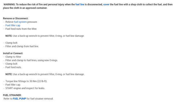

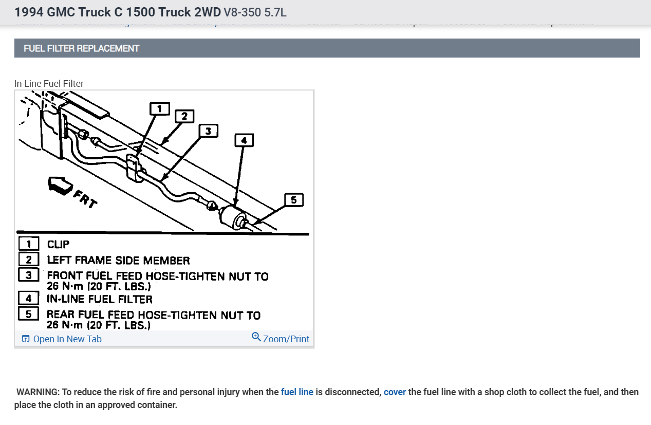

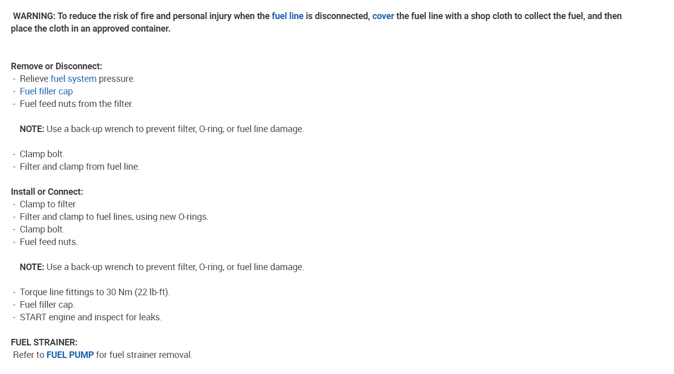

It sounds like the fuel pump is going out, which is common on these trucks. Here is a guide to help you check the fuel pressure to confirm the failure, you can get a fuel pressure gauge rented from an auto parts store for cheap or free. I would change out the fuel filter first though.
https://www.2carpros.com/articles/how-to-change-a-fuel-filter
and
FUEL PRESSURE SPECIFICATION
Ignition ON Engine OFF .................... 62-90 kPa (9-13 psi)
Check out the images (below). Please let us know what you find. We are interested to see what it is.
