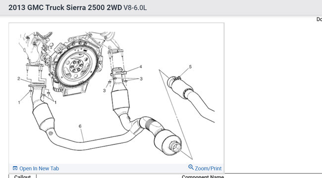

This sounds like you have a weak fuel pump or a clogged exhaust system. Let's start by running the codes to see what comes up,
This guide can help you:

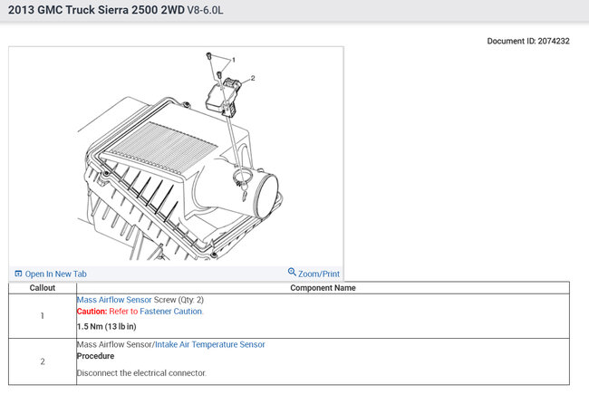

Also, it could be the MAF sensor needs to be replaced.
Here is a guide below that can help as well:
https://www.2carpros.com/articles/engine-has-low-power-output
Here is how to change the MAF sensor out in case you need it. Check out the images (below). Please let us know what happens.
May 2, 2023 at 2:03 AM

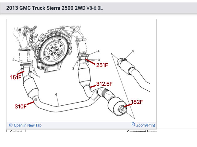

I got the engine to normal temperature. Turned off truck and took the following readings. I have attached a photo.
Jun 16, 2023 at 10:43 PM
  • 55,709 POSTS
The truck needs to be running when taking the readings but from what I can see the cats might be clogged up. Please resend the readings.

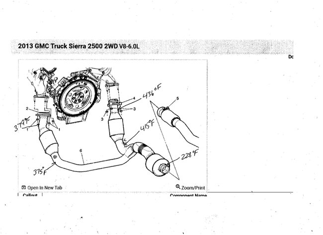

I retook the temperature reading while the engine was hot at normal temperature.
Jun 20, 2023 at 12:17 PM
  • 55,709 POSTS
The first cat looks okay, but the rear cat looks like it might be clogged. Also, I noticed a big difference in the input temperature on the driver's side, is the engine running smoothly?

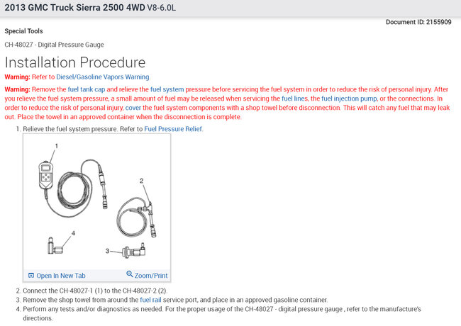

I would do a fuel pressure test because lack of fuel can make it ping and cause the code. You can rent a fuel pressure gauge at the local auto parts store for cheap or free here is a guide to help.
The fuel pressure should be about 60 PSI
Jun 23, 2023 at 3:04 AM
RONALD DEVOLD
  • 134 POSTS
i have 52 PSI of fuel pressure.
Jun 23, 2023 at 10:00 PM
RONALD DEVOLD
  • 134 POSTS
I connected the gauge and turned the ignition on. The pressure gradually went to 54 PSI and slowly dropped to 52 PSI. Started the engine and the pressure jumped to 60psi. I applied the emergency brake and put the truck in reverse and idled the engine and the pressure held at 60 PSI.
Jun 23, 2023 at 10:58 PM
  • 55,709 POSTS
That is a good sign, I think the pump is okay, did you try a new MAF sensor they can cause low power and not give a code.
