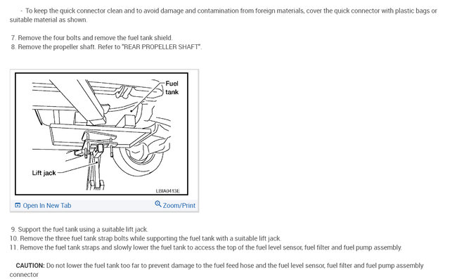

I have replaced new spark plugs, ignition coils, throttle body, and catalytic converters and sensors.
Jul 31, 2023 at 6:56 AM
  • 55,456 POSTS

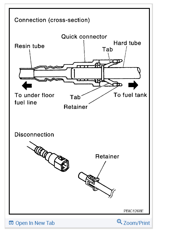

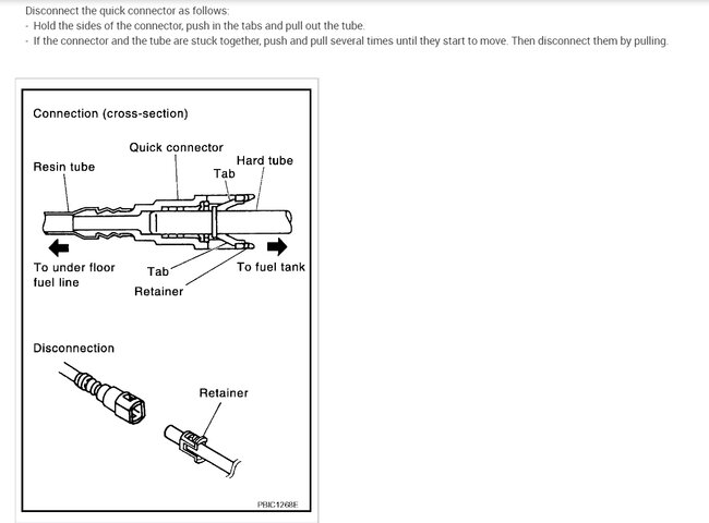

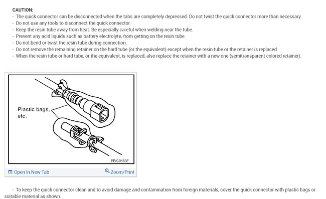

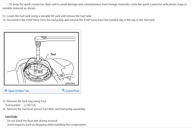

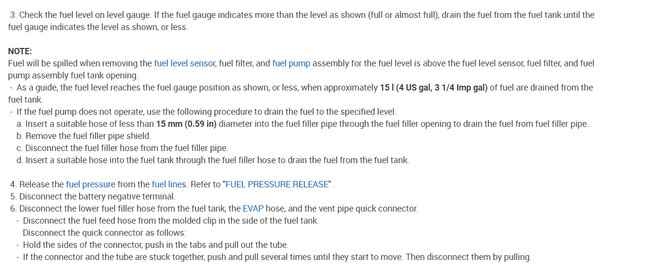

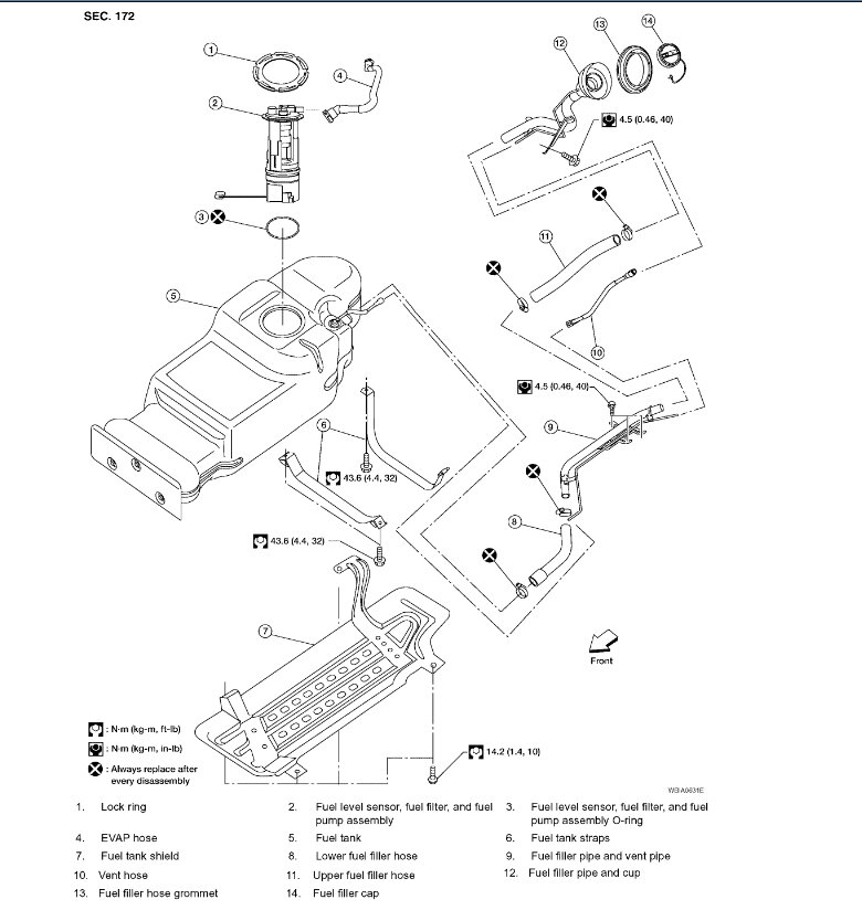

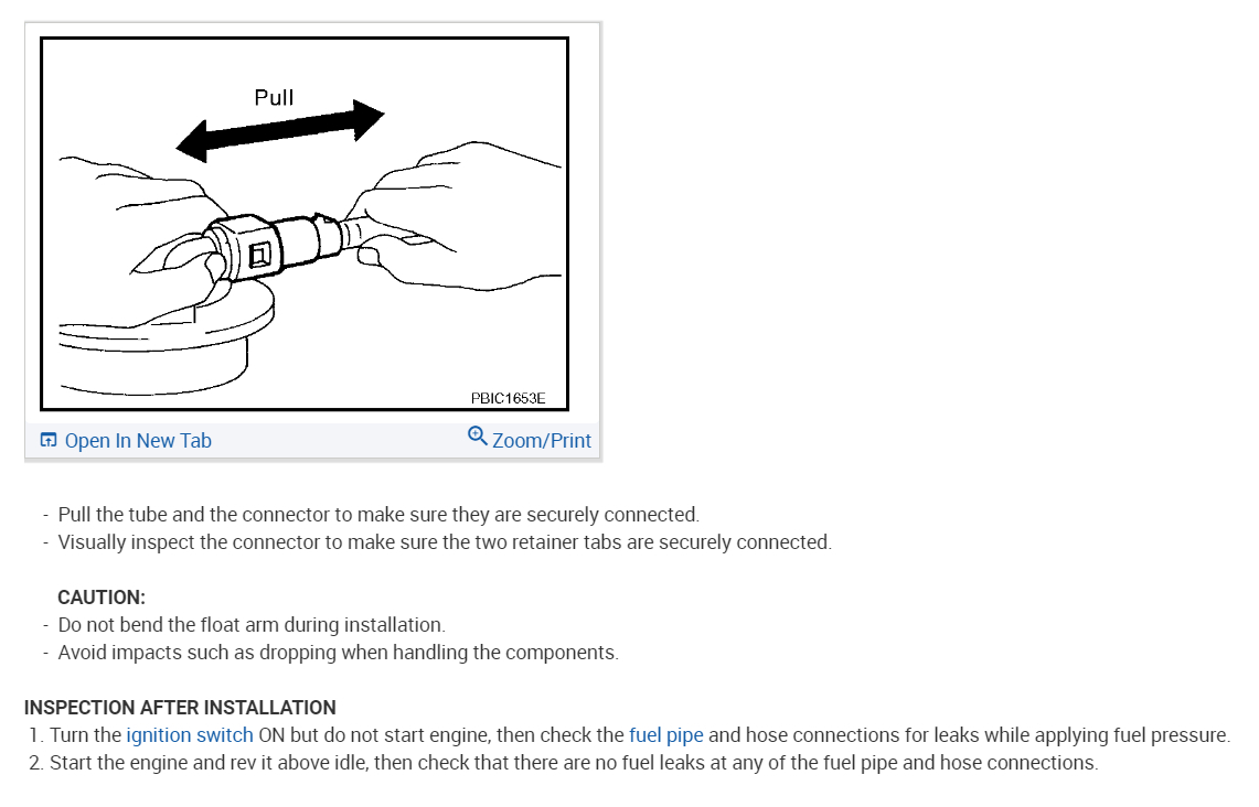

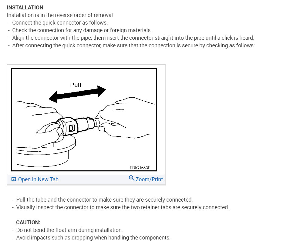

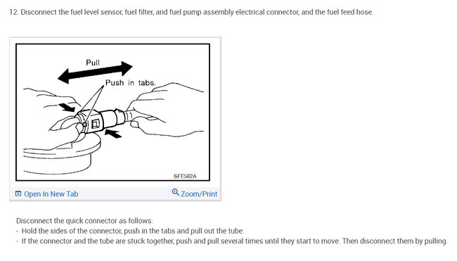

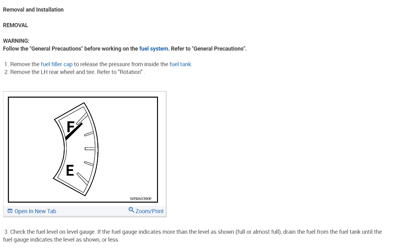

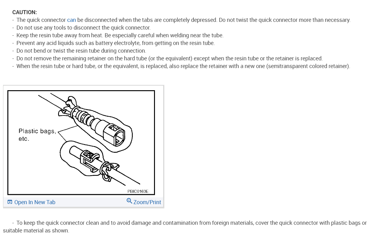

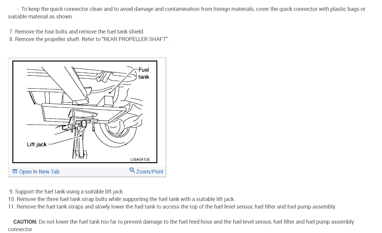

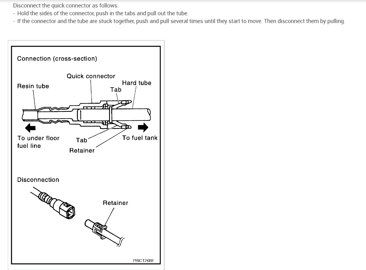

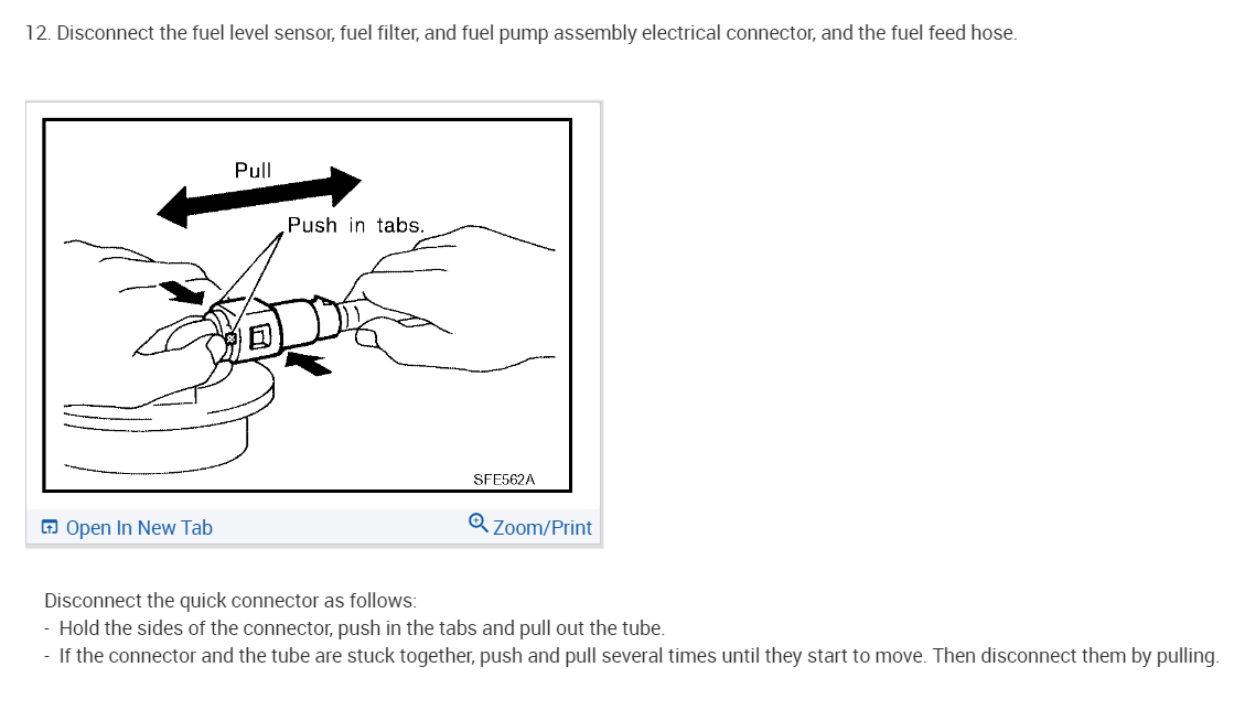

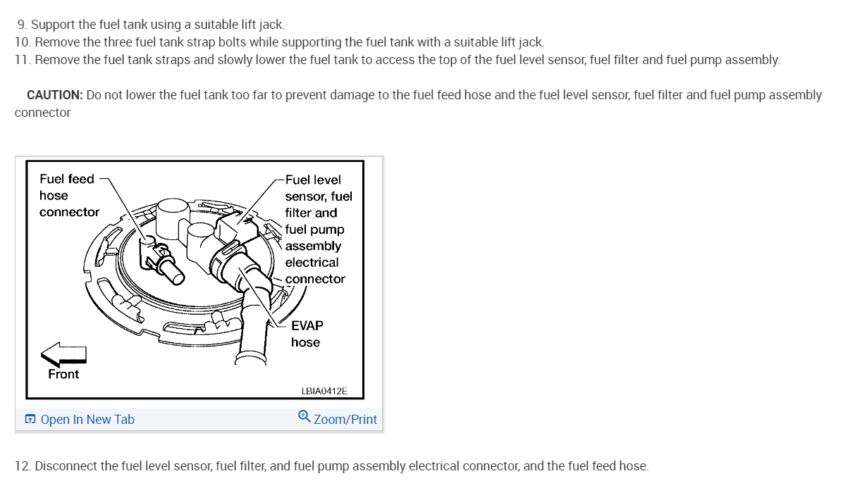

I would check the air filter and if it is okay. Let's do a fuel pressure test because it sounds like the fuel pump is weak. Here are two guides that can help us with instructions on how to change the fuel pump in the images below:
https://www.2carpros.com/articles/engine-has-low-power-output
and
Fuel Pressure
Fuel pressure at idling .................... Approximately 350 kPa (3.57 kg/sq.cm, 51 psi)
You can rent a fuel pressure gauge from the auto parts store for cheap or free. Also, we should run the codes as well.
This video can help you drain the fuel:
