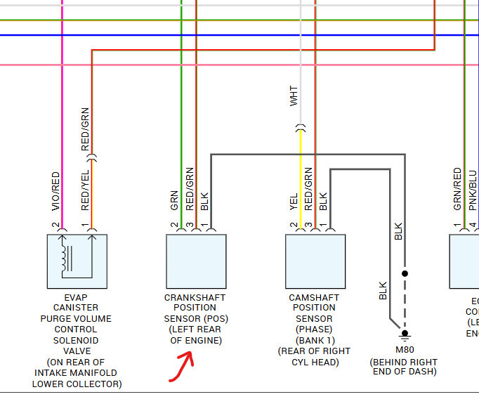

Aftermarket Pig Tail wiring. How to hook it up to my wires that is black/red, red and green.

Sure, here is the engine crankshaft wiring diagrams so you can see how the wire connect, as you look a the connector straight on with the safety tab on the top, the terminals go 1, 2 and 3. Check out the images (below). Let us know if you need anything else.
