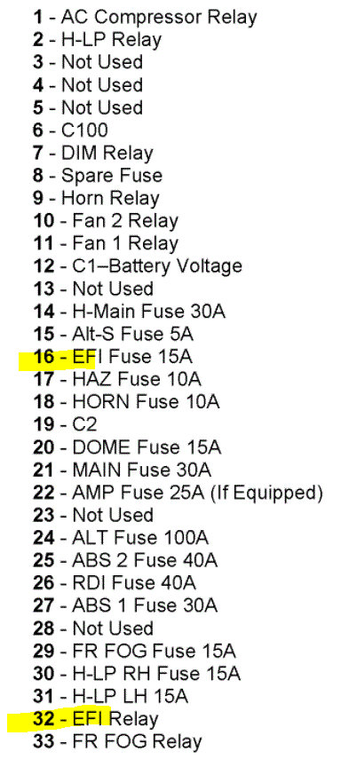

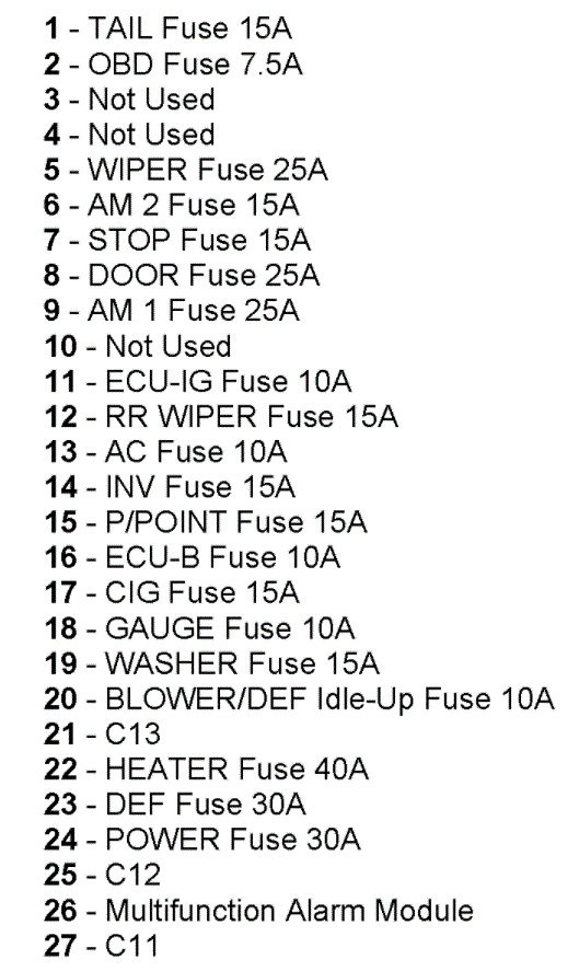

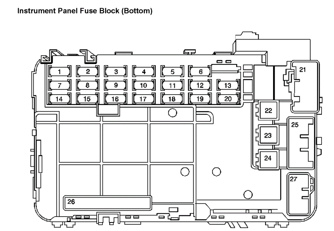

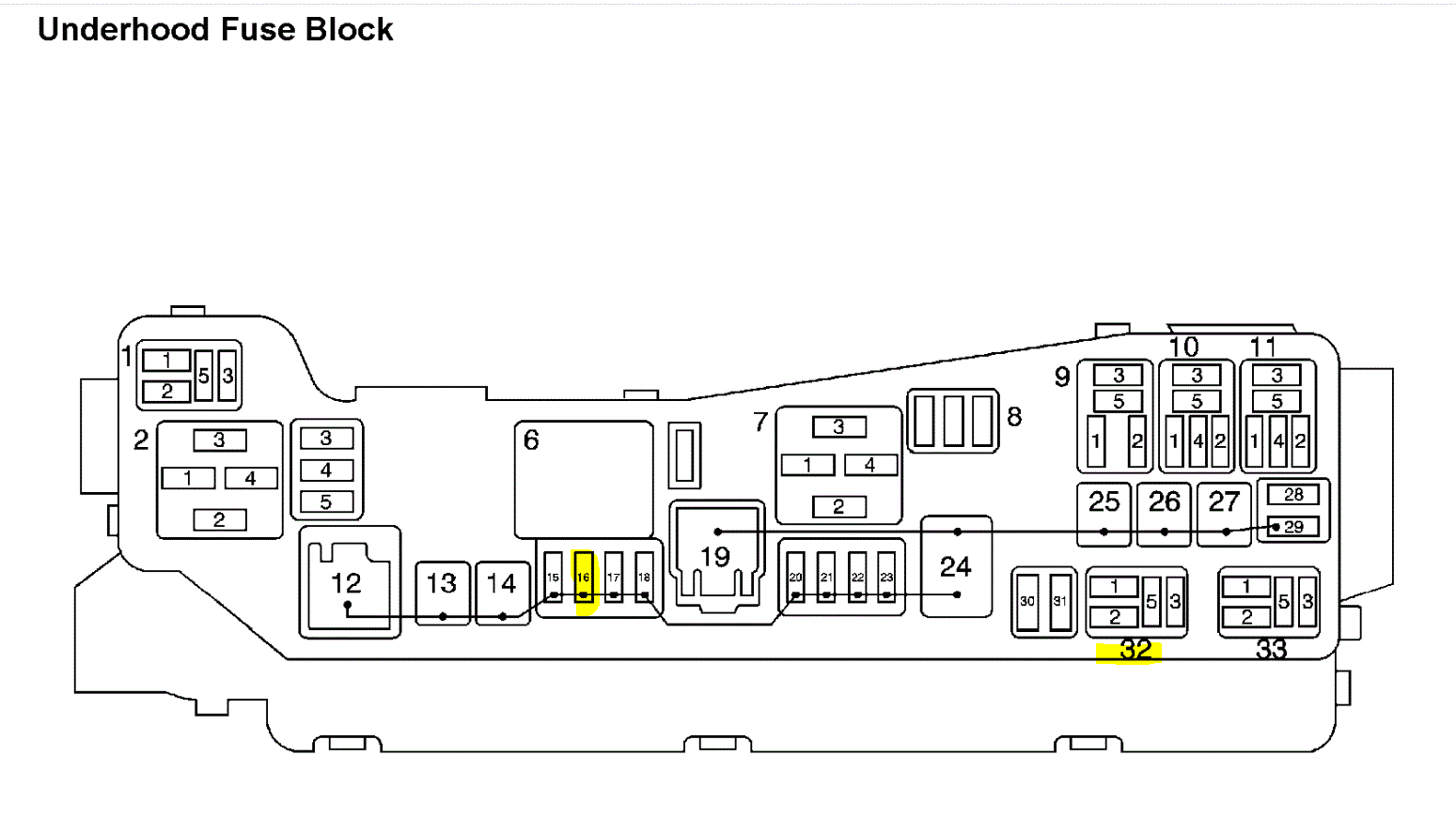

We discovered that the fuel injection was not working they say the fuse is bad but where is the panel and how do you check the fuses?
Aug 11, 2009 at 2:17 AM
  • 110,240 POSTS
If you look at the attachments below, they provide the fuse box orientations and what each fuse is for.
In addition to just checking a fuse, make sure there is power to it. A fuse may be good and not be receiving power.
Here is a link that you may find helpful when testing:
Also, number 32 in pic 1 is the relay related to the injection. Here is a link that explains how to test one:
