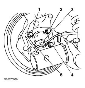

I have purchased 2 wheel rear hub & bearings and want to know if it is really as easy as just removing 4 bolts or if there is anything special I need to know, such as torque specks that hold the 4 bolts on.

Never use the "Easy" word :) . You would have to remove the rear drum to get to hub bolts.
https://images.2carpros.com/forum/automotive_pictures/108325_rear_hub_1.jpg
Torque to 45 lbft.
https://images.2carpros.com/forum/automotive_pictures/108325_hub_vibe_1.jpg
