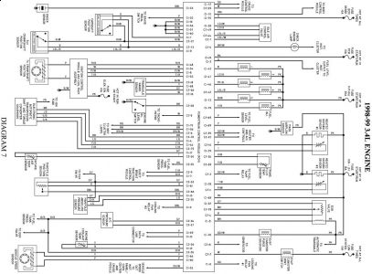

Ok what happened here is me and my dad decided to pull the alternator as it was giving him problems. if you worked on this truck you know it's a pain in the butt to get out.
So we decided might as well do the cables and plugs since we'r removing the intake manifold will be able to get to the back ones. We finally get done mounting everything to discover the the labels on the cables came loose so after about 30 minutes i found the correct firing order plugged the cables in turned the car on it turned on but it shakes like when one of your plugs is bad.
so i decided to check today thinking my dad might have left one of the rear cables loose to one plugs but no go.
I started checking the Ignition control module just find that the number two cylinder plug is firing a really weak spark but the rest of them fire normally.
My question is. Is this a bad ICM or could this be caused by somthing else?

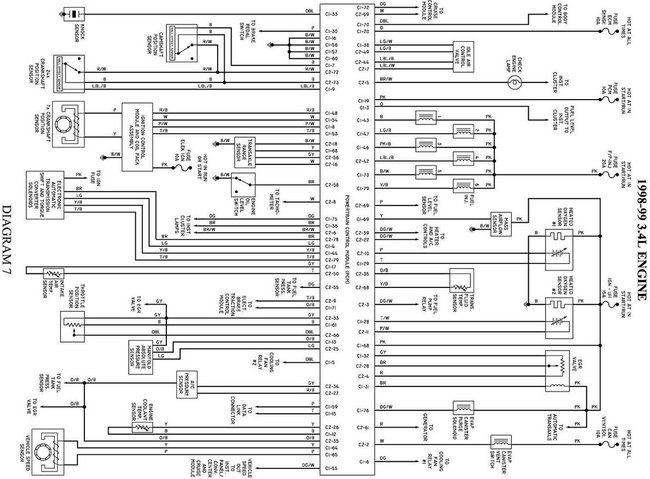

Okay i tried swapping coils and the problem does not move with the coil it stays on the same cylinder so this rules out a problem with the coils. still is there anyway to know wheater my ignition module is at fault because i dont want to replace it without it being sure it cost's roughly 90$ (alot of dough right now) I also re did my test to check there is a spark but far weaker then the others, when i unplug the cylinder there is no arc to the coil but when i do it to the others there is. aside from seeing the diference i felt the difrence between the sparks on my arm lol Could this be caused by the wires coming from the powertrain control module (as i no longer trust connectors on this truck) or would one of those wires being loose just cause it to not work at all
https://images.2carpros.com/forum/automotive_pictures/516029_1998201999203_8L20Engine20Schematic_1.jpg

Here is the schematic bigger just click the below link

It could be the module. However because it happened when you were changing the plugs and wires. I would look more into what could have caused it. Maybe the spark plug wire has an internal open. It would help to put a scanner on it to see the misfire graph.
