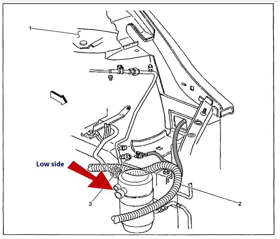

Air Conditioning problem 6 cyl Front Wheel Drive Automatic 198000 miles
Do it yourself recharge kit - The space under the hood is tight and it is hard to tell if which is the proper hose to attach the A/C refill hose to. Where is the location to attach the line?

The low side charge port is located on the accumulator, Here is a diagram (below) and a guide to help you get the job done.
https://www.2carpros.com/articles/air-conditioner-how-to-add-freon
