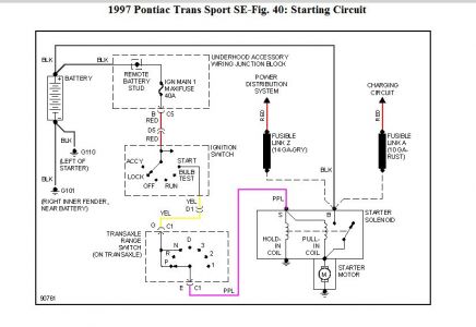

1997 Pontiac Transport I need a starter wiring diagram
1997 PONTIAC TRANSPORT
LEOMNR2008
  • 22 POSTS
Electrical problem
1997 Pontiac Transport 6 cyl Two Wheel Drive Automatic
I need a wiring diagram for the starter on a pontiac transport montana, 3.4 liter, v6, ac delco starter.
Sep 19, 2010 at 10:07 PM
MHPAUTOS
  • 31,937 POSTS
Starter wiring system.
https://images.2carpros.com/forum/automotive_pictures/61395_Capture_89.jpg
