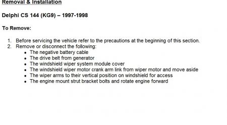

how do you take or what all do you have to do to take altenator out and put new one in?
May 20, 2010 at 4:16 AM
INTERNETMECHANIC
  • 700 POSTS

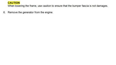

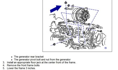

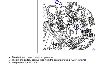

I found a removal procedure in a database. You have to use common sense when using a database. If the procedure I list here, doesn't make sense for your vehicle, don't use the procedure. Again use common sense about removing the alternator, if you see an easier way other than what the procedure says, do it your way.
