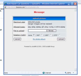

If not sure how here ya go.....
https://images.2carpros.com/forum/automotive_pictures/188069_2carprospictupload_1.jpg
A popup window appears......
https://images.2carpros.com/forum/automotive_pictures/188069_2carprospictuploadpopup_1.jpg
Then just click the Browse Button and find the pic once you find the pic just Double Click on it once back to popup window click the upload button. Thats it... .

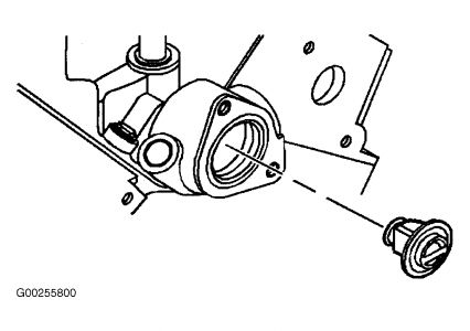

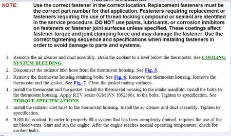

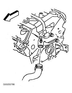

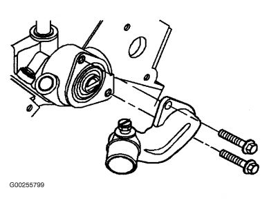

Ok, I think we are ready to go now. Here is the proceedure.... You can press your "CTRL" key then the "+" key to zoom in to read better. If still cannot read let me know and I will email it to you. Oh, the Bottom bolt hole of themostat housing is slotted. You don't have to remove the bottom bolt completely
https://images.2carpros.com/forum/automotive_pictures/188069_96transportthermostatremove_1.jpg
https://images.2carpros.com/forum/automotive_pictures/188069_96transportthermostat_1.jpg
https://images.2carpros.com/forum/automotive_pictures/188069_96transportthermostatbolt_1.jpg
https://images.2carpros.com/forum/automotive_pictures/188069_96transportthermostat1_1.jpg

how is this going to help. im james and i posted back at the start of this mess. some one said the bottom hole is slotted, but if i could get it loose i wouldnt have a problem removing it completetly, would i. I have a manual too and it does look easy but what it doesnt show in how close the exaust and the heat sheild are to the lower bolt. i cant even get a socket on it, and using a wrench or any kind of offset wrench is basically impossable. I gave up, i couldnt gett it.
