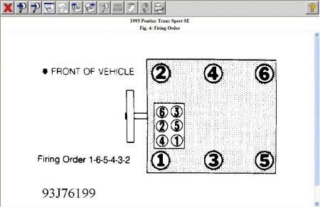

1993 Pontiac Transport firing order of an engine of a trans
1993 PONTIAC TRANSPORT
100,000 MILES • 6 CYL • 2WD • AUTOMATIC
ROGELIO LOPEZ
IF YOU COULD SEND ME THE DIAGRAM ON THE AGENDA FOR IGNITION FOR AN ENGINE 3.8 YA PONTIAC TRANSPORT TO URGE ME KNOW HOW IS THE ORDER OF spark plugs.
THANK YOU
Nov 12, 2008 at 9:24 PM
  • 75,992 POSTS
Here you go
https://images.2carpros.com/forum/automotive_pictures/12900_fo_23.jpg
