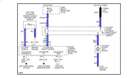

The radiator fan is not coming on.
I want to check the fuse and the sensor.
Can you help me locate these items.

Is it a 3.1 or 3.8 liter engine??

It is a 3.1 L engine.

Check and test the ignition fuse 15amp,coolant temperature sensor,coolant puller fan relay,and computer. Do this 1st before you check the above-power the fan motor direct from the battery -the black and red wire and see if it comes On.
https://images.2carpros.com/forum/automotive_pictures/12900_fan_8.jpg
