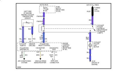

The radiator fan is not coming on.
I want to check the fuse and the sensor.
Can you help me locate these items.

Check and test the ignition fuse 15amp,coolant temperature sensor,coolant puller fan relay,and computer. Do this 1st before you check the above-power the fan motor direct from the battery -the black and red wire and see if it comes On.
https://images.2carpros.com/forum/automotive_pictures/12900_fan_8.jpg
